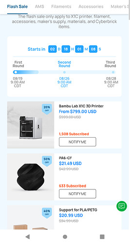

Lotta people want to be notified of the 799 price on the X1C!
