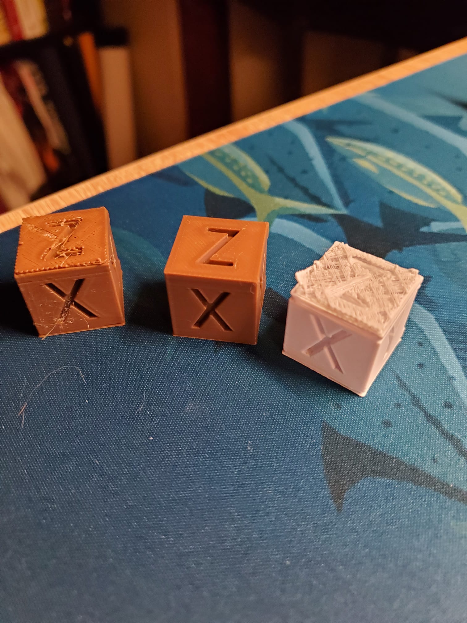

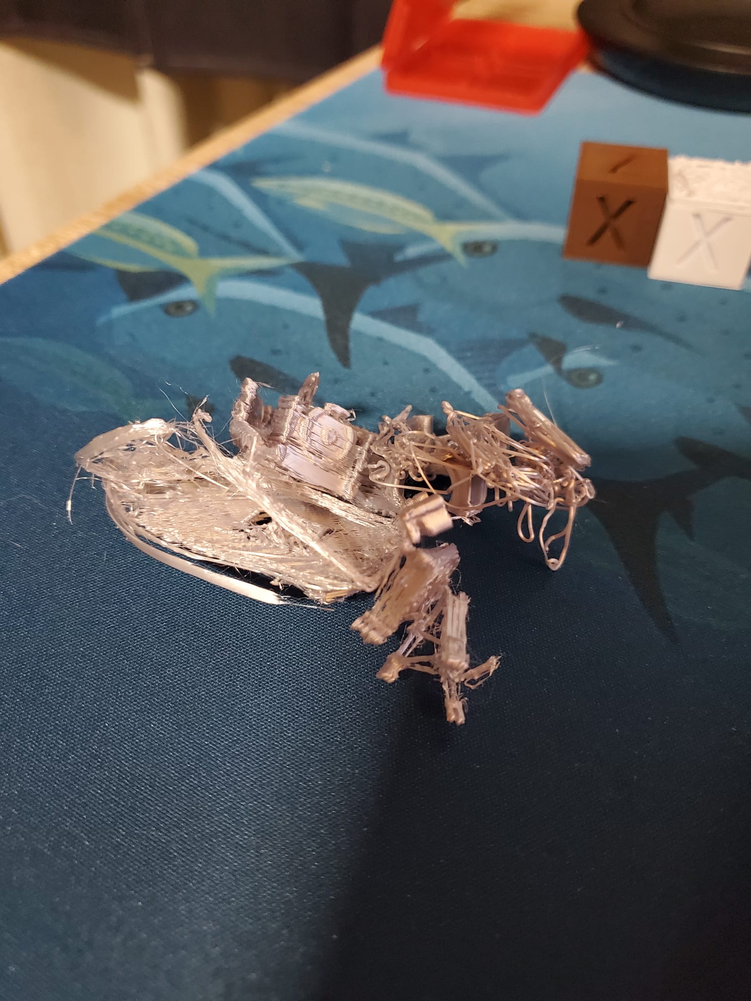

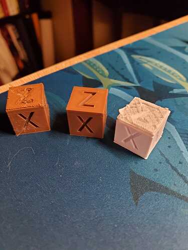

Yesterday I had some issues and seemed like there was a clog. I was able to clear it out, but my prints mostly fail ever since then. There can be mixed results, some have looked fine, some mostly work, some are complete disasters.

  • Flow calibration (did a calibration and the results are inconsistent/none look correct)

To check your nozzle manually set the temp to 250, once it heats manually extrude some filament using the controls on the printer. Does it come straight out and down or does it curl? If it curls you likely have a clog in there still, might want to try a cold pull (see wiki).
Make sure the filament path is clear of obstruction and tight turns and moves freely through the PTFE tubes. Because in your flow test as the flow goes up it appears under extruded. As the flow goes down it’s looking better.
What brand(s) and type(s) of filament is it? PLA? It might help in troubleshooting.
Thanks, I will try those out now. Sorry I did forget to say filament type. A few different generic PLAs. Mostly Inland I believe
I think I have it solved, this test was key. I did another big clean out of the nozzle and did this test and it was coming out nicely in a straight line. I figured I should do it with all the filaments to make sure they were all good. One filament (the original one that clogged) immediately clogged it up again and I had to clean it out, again. So it seems I did have a bad filament actor. Which is strange, because before it clogged I had a few perfectly fine prints with the same filament, that same day. I’m not sure why it so suddenly went bad. Repeated the tests after the new clean and looked ok, a few test prints have come out well, so tentatively continuing with my printing (minus that filament). Thanks!
