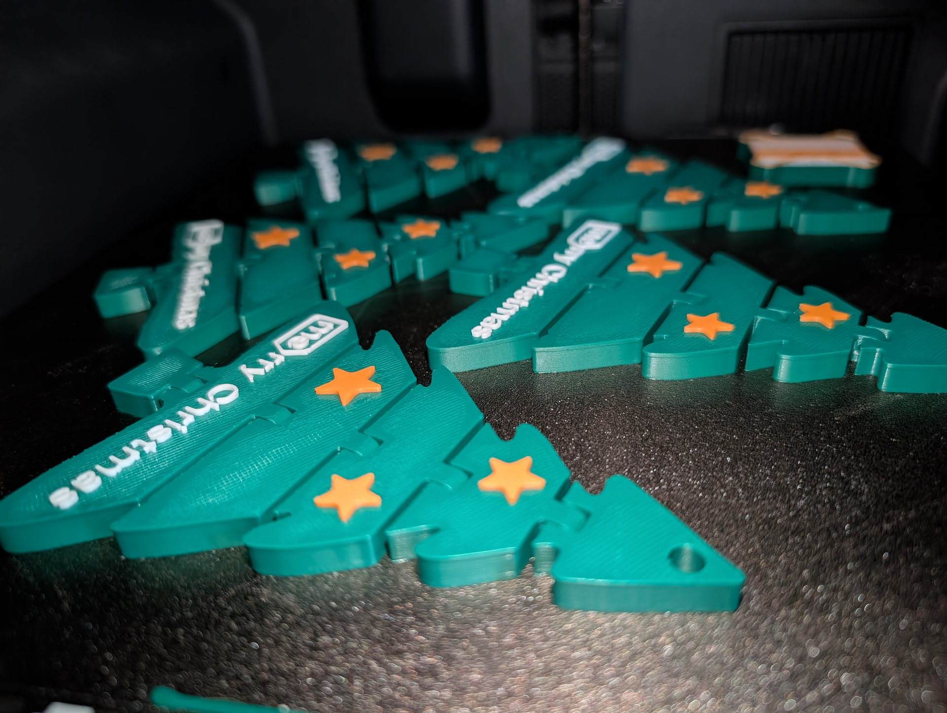

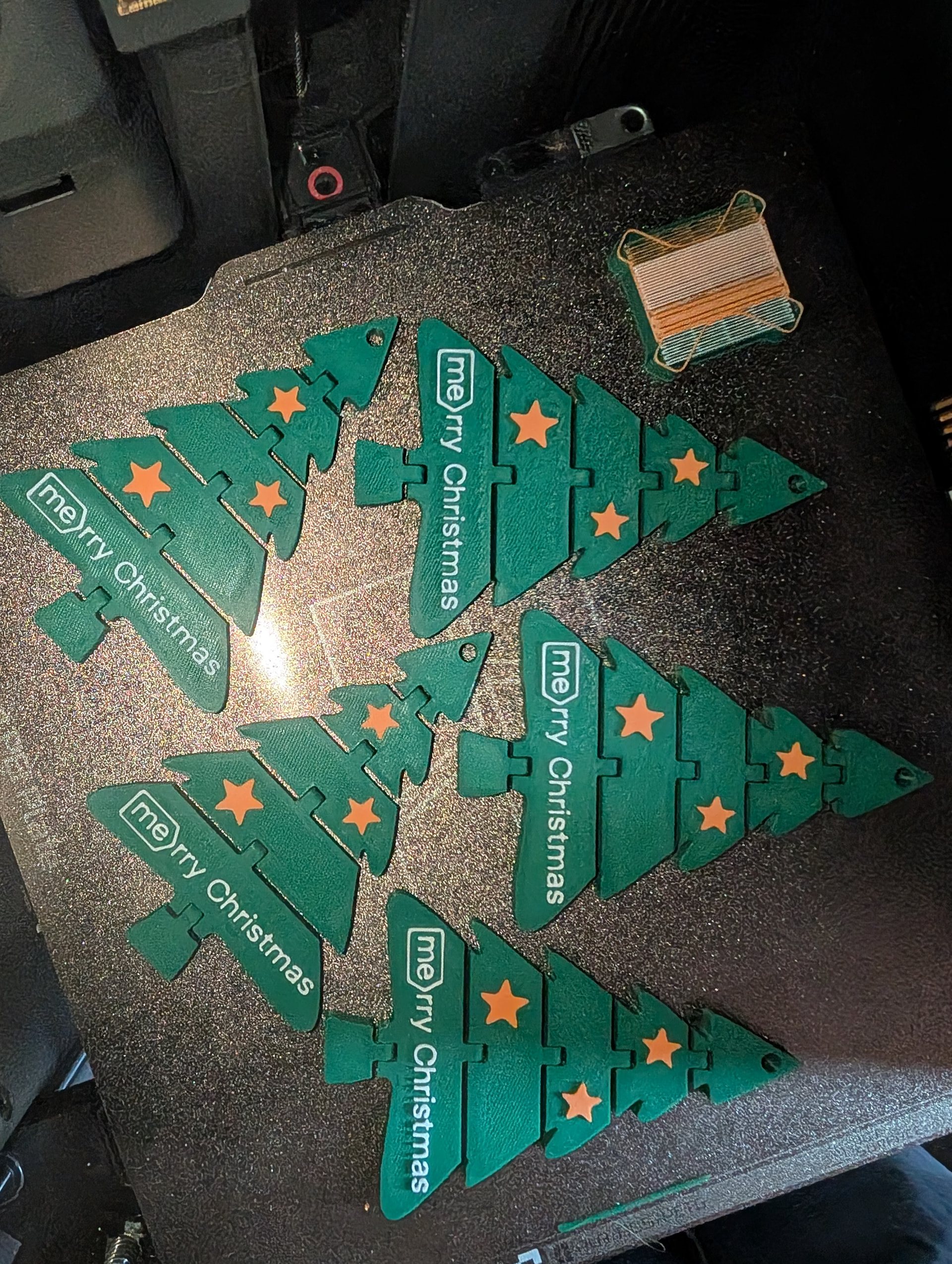

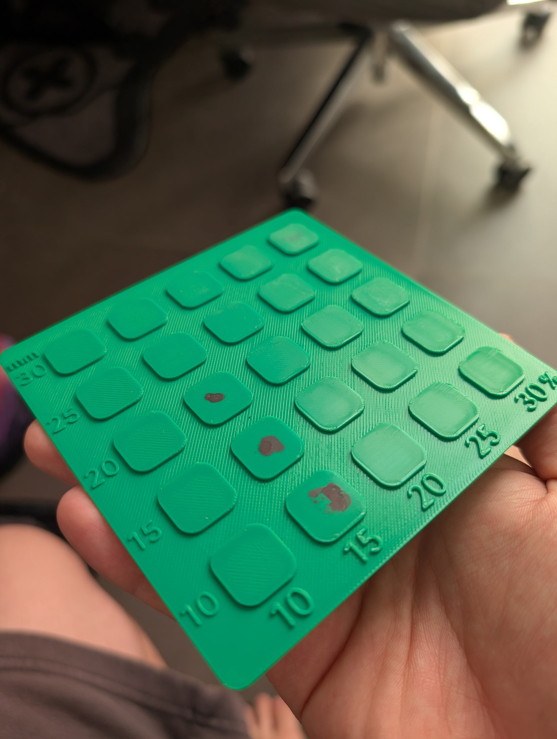

I keep trying to use ironing on my new X2D printer and with the same files I used to use on my P1S printer, I now get a lot of ironing artifacts. I tried printing an ironing test such as this one Ultimate Ironing Test-Das Original - Free 3D Print Model - MakerWorld and used the profiles that suited me best
I then went to print this design with the settings loaded in, on Sports, with the ironing settings to closely match with the ironing test
Arbol navidad articulado editable.3mf (407.7 KB)

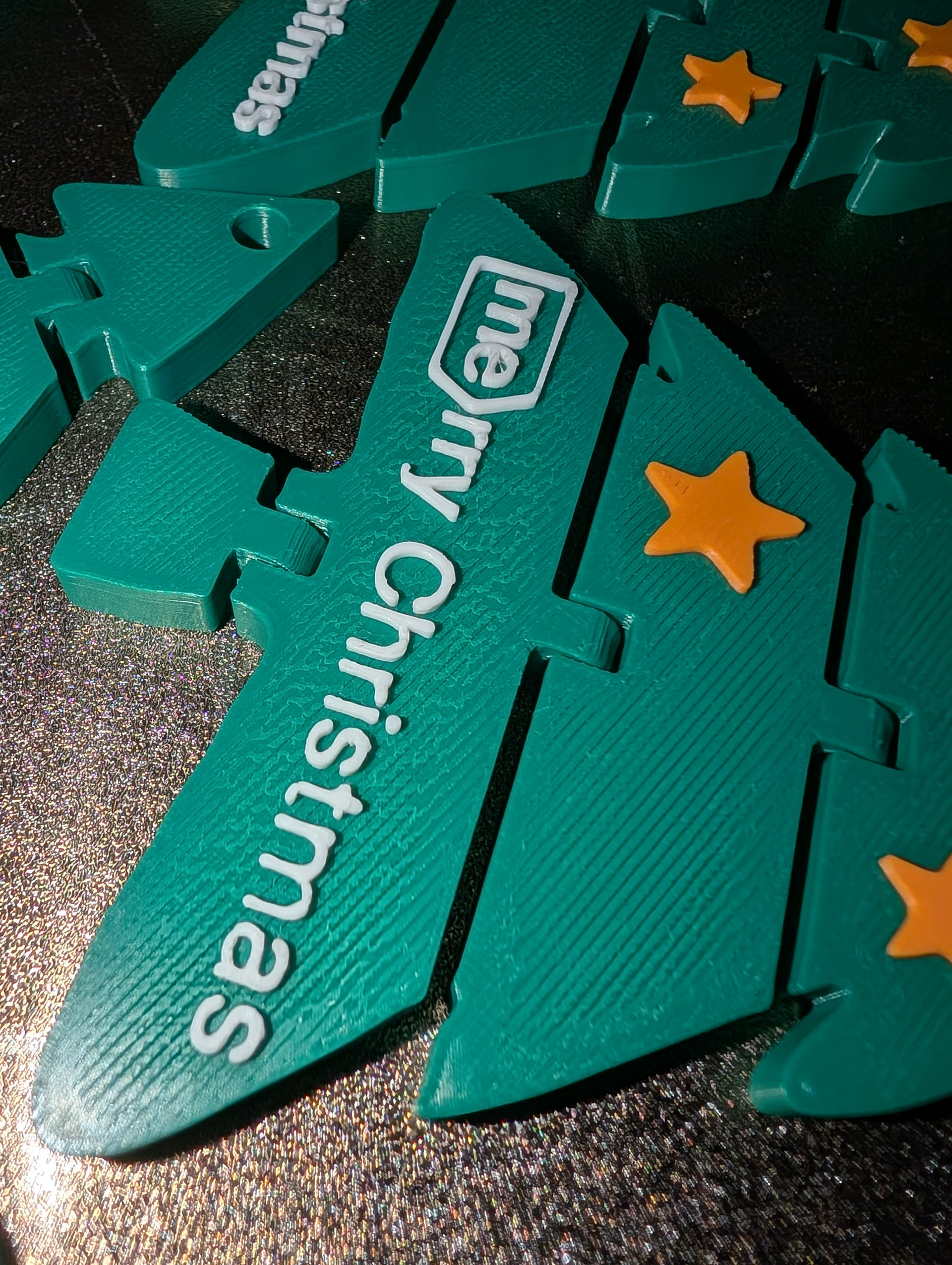

This is my latest print results
As one can see, they look pretty rough and the ironing looks pretty uneven. At least without ironing, the lines were much more even
One of the things I’ve found that affects ironing greatly is the line width of the top layer. Changing the line width of the top layer to something like 0.32 may help (if you’re not already doing that). Also, direction can affect ironing results as well. I published some ironing settings a while back that work good for me and worked just as good on my P2S as they did on my P1S’s. HTH
Did you print the ironing test on Sport mode too?
In this case no, but I would assume that it will mostly just change speed and accelleration, so it should still land somewhere similar to what the test shows. But I will try one in sports mode regardless
I re-printed the ironing test using Sport mode and lo and behold, I was defintely way off the charts.
I printed it again with the new settings and it worked perfectly
