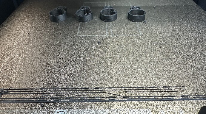

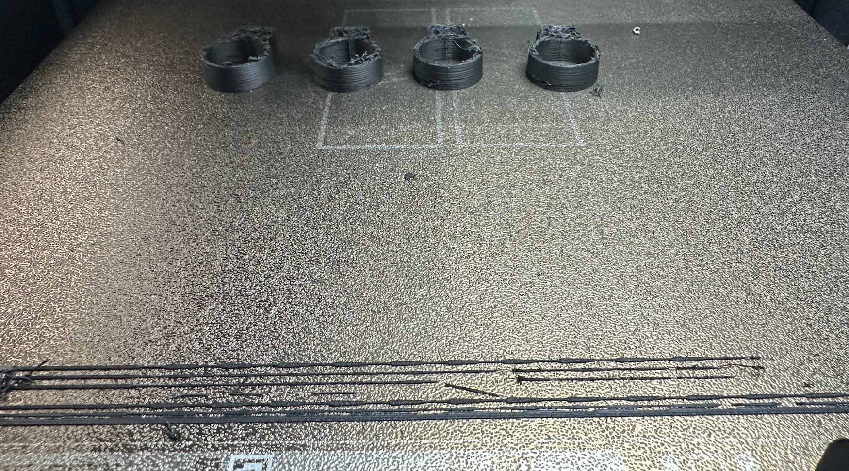

I have little experience with this because it’s only happened once 3 years ago. I took the head out and disassembled the extruder. But the tiny cables are fragile. AI tells me a cold pull will clear it, but it didn’t. Heated to 240° I can’t push new filament into the top. I can’t seem to push a needle in from the bottom. Do I really need to disassemble the extruder again?

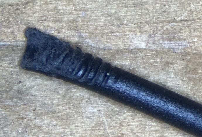

I’ll attach a photo of the filament end. It looks chewed off at the feed roller.
Do more cold pulls, or keep trying to unplug using a needle. You may also try running a higher temperature prior to using a needle.
From what I can see it looks like you might have filament bunched up against the head an if that is the case you will need to take the extruder apart.
You were right. I bit the bullet and disassembled the extruder and cleared a bit of clog. Put it all back together and got 10 minutes into the new print and it stopped extruding again in the same way. The filament is Bambu matte black. I can’t decide if it’s a bad spool (80% used okay) or something is going wrong in the print head.

I should have paid closer attention. It was looking bad from the start.

It seems free. I disassembled the extruder but that seems to have been unnecessary, it was free moving. I had a spare complete hot end in reserve and put it in. Trying again with a different filament and it’s printing like the champ I am used to.
