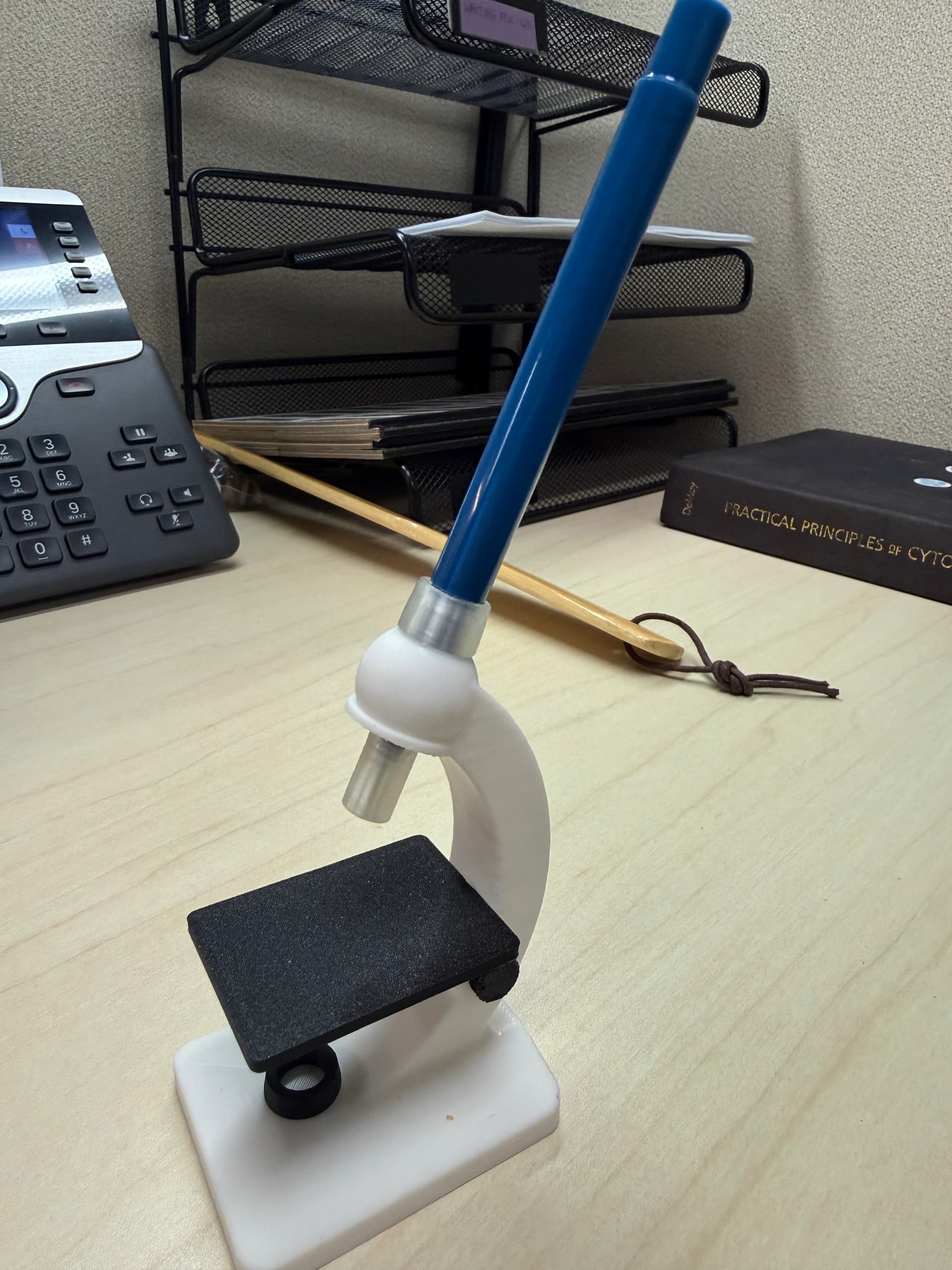

Ok, so I’ve been hacking away at a small project. I found a print I liked of a microscope pen holder. I work at a lab job where I use a microscope all day, and we use a special pen to dot our slides - so I wanted to modify this pen holder because it’s designed for like a ball point, where you can just let the pen slide through the “eyepiece” and rest on the “stage”. But I wanted to make it so that we could “cap” our dotting pens into the eyepiece and the eyepiece itself would be the pen’s cap. So it needs to be a pretty precise fit because they are felt tipped pins and they will dry out exposed to air. I’ve got it pretty well designed, though it’s an absolute hack job because I don’t have any cad software (or the knowledge of how to use them) and there are a few issues.
So, I found a pen cap that works well for the actual pen tip, its got a “cone” tapered tip that pretty much mirrors the pen’s original cop, it tapers down nice and small so the least amount of air is touching the tip. Then I basically made a slightly larger cylinder for past the tip until the pen’s larger circumference, and then that is attached to a slightly larger cylinder that holds this whole eyepiece in the microscope itself. This has a pretty tight tolerance so it stays in the microscope when you take the pen in and out.

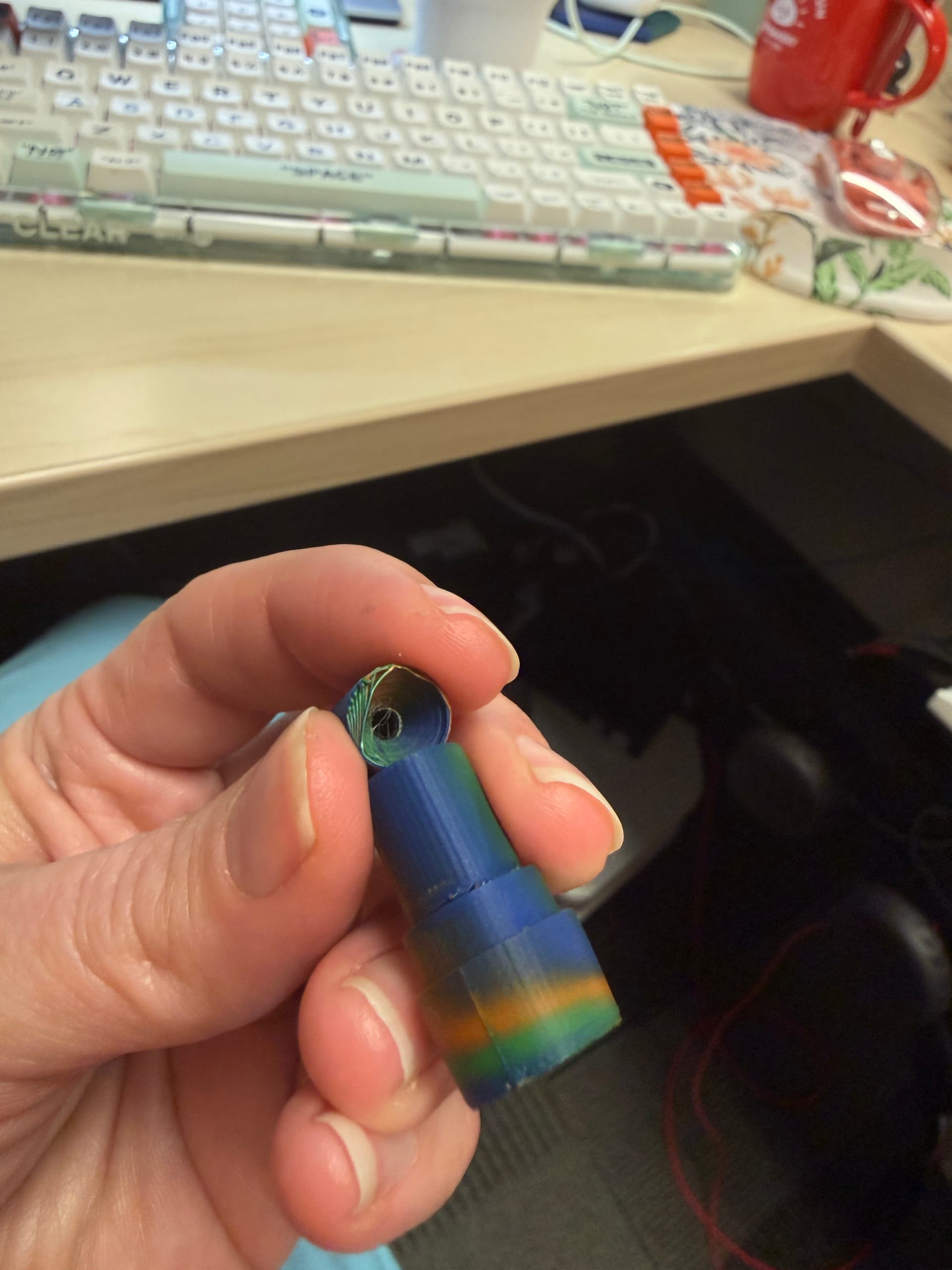

At this point I’m giving lots of verbal detail, but I’ll now post pictures so it makes sense. Here is the whole print. (used transparent PLA here when getting the tip just right)
Here’s the “eyepiece pen cap” by itself (ignore the funky colors, it will be black)
My issue is finding the right combination of settings for the pen cap. It’s extremely thin in the middle section, so I understand why it has issues, and as the cap gets narrower basically it’s kind of printing in “mid air” and doesn’t have something underneath it to connect to, but I need the cap to get narrower.
Like I said it’s a hack job, and there are issues with the pieces “connecting “ to each other. If I do “classic” walls, I have to print it at 50% speed - which is fine I guess, but I also don’t like that you can’t really tell it to print at 50%, you have to wait for it to start and then go to the printer and I change it to silent mode. If I don’t change it to half speed it will likely mess up at the parts where the cylinder gets narrower.
I found that if I do Arachne walls I can print it at full speed, but then the pieces want to separate with little force.
I’m also finding that I’m getting this webbing inside where the pieces are joined.
I have the pieces merged and did the boolean thing, they are one piece in the slicer, but they still get funny where the connect. I’ve even tried to overlap the pieces a bit more, so it’s not just “right on top” of each other.

My guess is your nib point is flat rather than a perfect cone. Thus cause the perennial problem that it prints in the air with nothing to support it.
I also note the external shake has changes in diameter that are not tapered to the next reduction.
You have choices:
  1. Print in the same orientation but design the tip point to be a cone, just extend up from where it currently is by removing a cone with a starting diameter of the existing tip diameter and an end diameter of zero.
    This should form a suitable flat point where no material will fall or disconnect.
  2. Print it in the same orientation but add supports.
    This will require no design changes, but may leave the very tip with support stick in it that cannot easily be removed due to where it is.
  3. Print it upside down with supports.
    This will deal with the stepped external diameters and make the printing of the negative space easy.
  4. Print upside down and slightly taper the stepped diameters to make the, printable without supports.
    This will make it easy to print and not require any supports. The model will be clean and easy to print as nothing is printed in the air.
Always consider printing things upside down when you have a problem print as thus often presents simpler answers.
If this doesn’t work I will look at the file when I wake.
