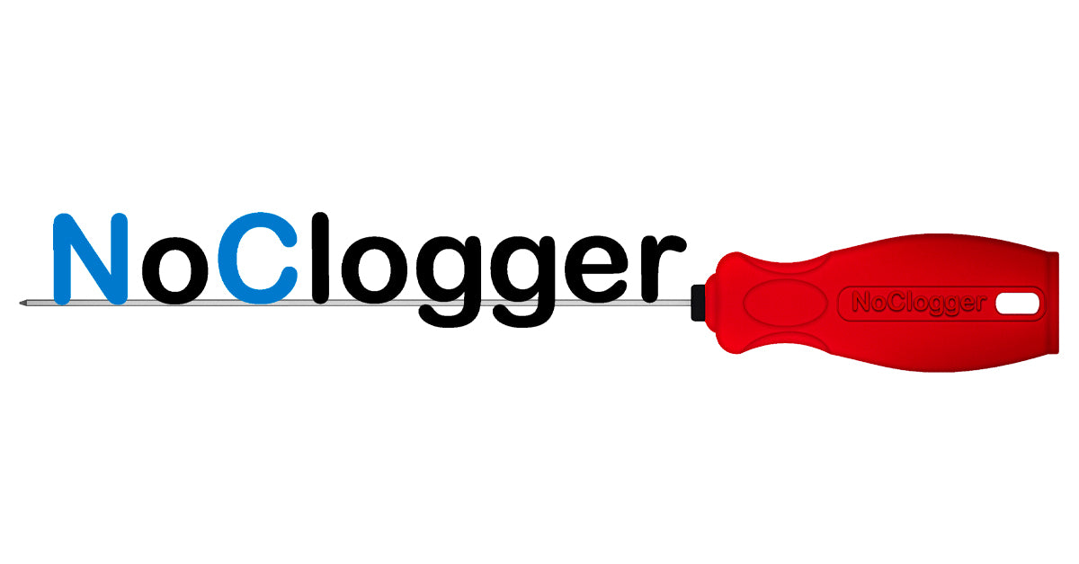

You can still try heating up the old nozzle and using something like this…
… to unclog it.
They are meant for direct extruders like in Prusa machines so you have to use it with the nozzle removed on Bambus. But it is still a very useful tool. Might be nice to save a nozzle.
Hardened steel will not prevent clogs like in this case but good thinking
