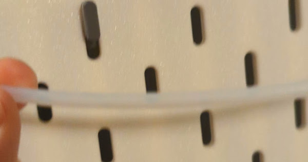

Help! AMS2 won't push out filament far enough to even reach the buffer
There did not seem to be a problem until just a couple hours ago.
The AMS2 will only push out filament to a set length now (~1.5 feet), which ends about an inch before the buffer, and then retract it repeatedly until it fails with:
Unable to feed filament into the extruder
I have:
  • Removed all tubes
  • Removed the tube connector from the back of the AMS2
Without any tubes, it still only pushes out the filament the same distance (About long enough to make a gentle arc towards the buffer, but not quite far enough to reach it). And then retracts.
Below is a video of the effect with a tube connected (Easier to measure the distance). The behavior has no change without a tube:
How can I further diagnose?

I did just find the HMS indicator that states:
AMS A slot 4 feeder motor is stalled
It has a link that sends me to a page with instructions for X1 though, and not the P1S
I just tried the other slots, they also exhibit the same behavior, and push the filament out to about the same location. The ā€œmotor stalledā€ shows for each slot.
What is REALLY weird, is that if I try and get a slot to read the spool, it will insert the filament the entire way all the way to the extruder while trying to read it. And then retract it the entire way. It fails to read the RFID for every roll of filament now, for some reason. So it appears to have no problem actually pushing the filament through :thinking:
This is quite weird since the reading behavior just earlier today was that it would spin the spool a bit back-and-forth to try and read. Not that it tries to feed until a timeout.
Here is a video showing that it pushes filament all teh way to the extruder when reading:
So, there appear to be two issues from this testing:
  1. When trying to read the RFID tag for a roll, it will feed filament all the way to the extruder, and try and push past it. Before eventually failing and retracting.
  2. When trying to actually load, it only pushes the filiment out a bit, then eventually retracts with a AMS A slot {n} feeder motor is stalled

Yeah, looks like plenty of folks have a similar issue. A good bit of that thread seems to be a problem with the hub (The 4-way buffer you attach to the back of the printer) specifically though, which conflates the problem a bit.

In my caser it looked like the external AMS hub was defective. Now waiting for replacement to be arrive.

I just got the AMS2 Hub in the mail, swapped it out, and it also appears to be working fine for me as well.
Perhaps a faulty sensor on the hub?
