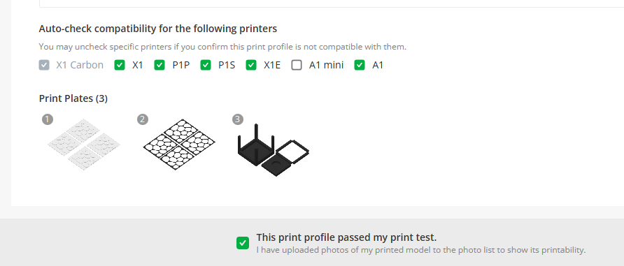

I’ve always chosen the x1 printer then slice. Then I export the 3mf to makerworld. I got a msg today someone telling me they couldn’t print on thier A1 because there was no choice for it. I’ve always done it this way. What am I doing wrong? Here’s a screenshot.
The option is when you upload the print profile, one of the last options is what printers it’s compatible with. You can still add it to that profile. Just edit the profile and look at the bottom:

Thank you but I didn’t get this choice. I think because of anti collision. Since it’s print by object. Thank you again. I’ll keep an eye out for this next time.
