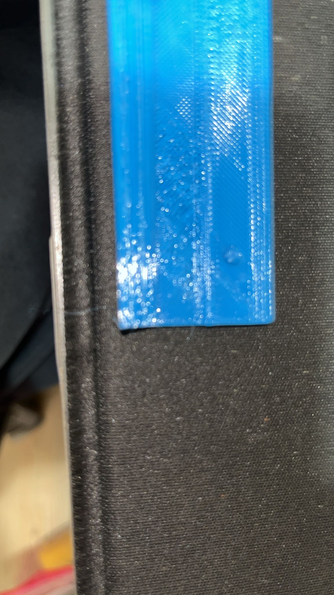

I could not take photos while printing as it was too dark inside but starting form the first layer some sections were perfect and some sections were somewhat fuzzy and or under extruded. I waited until the end to see if it would turned out usable. Spoiler no.
Although majority of the top surface looked ok the section with fuzzy texture remained.

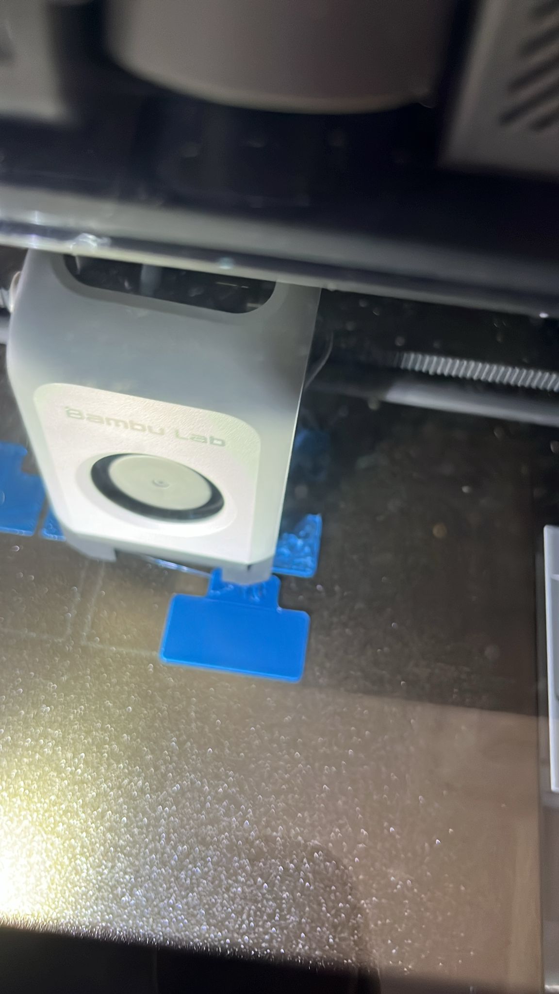

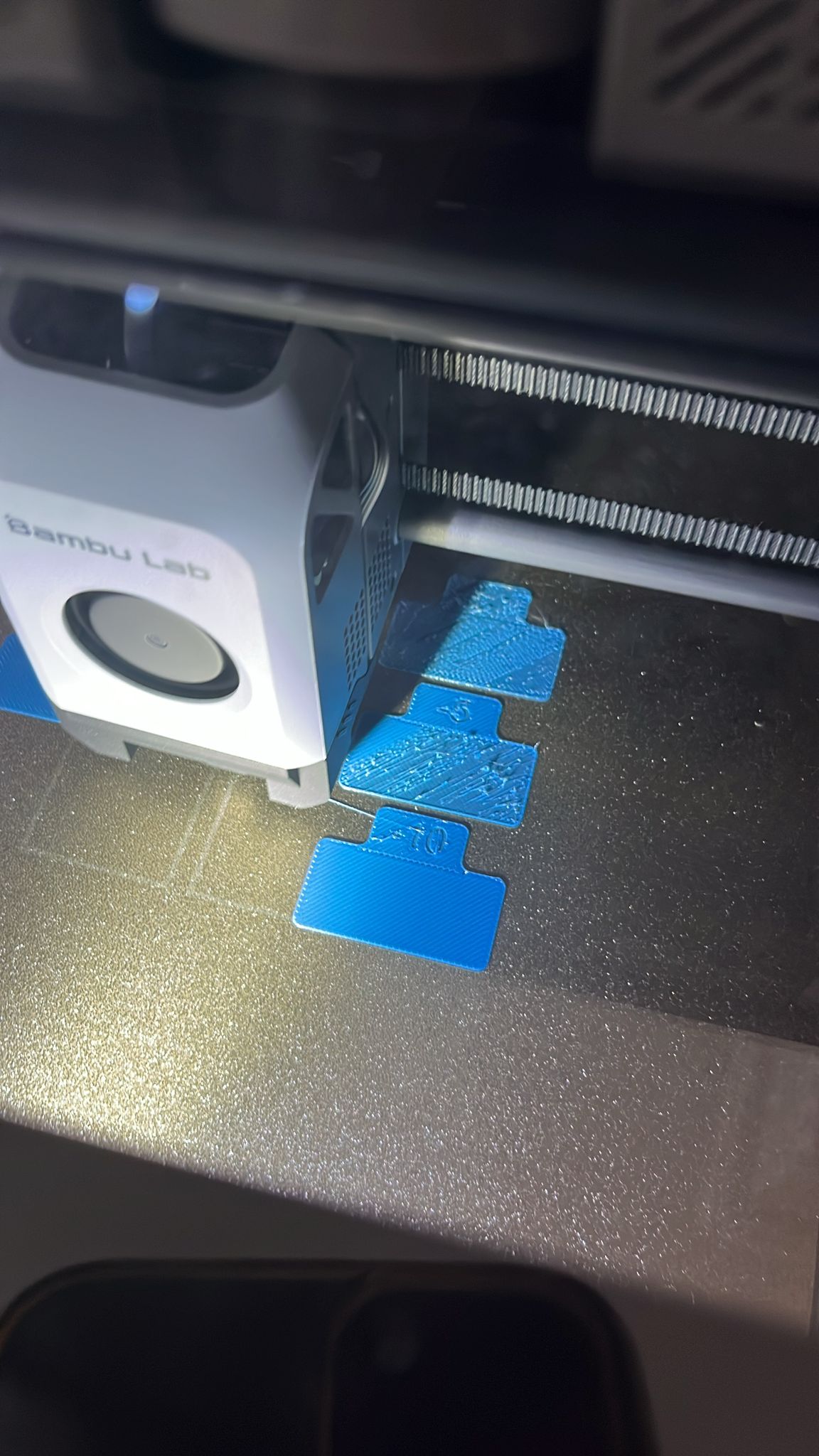

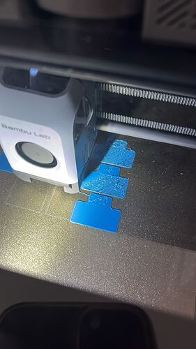

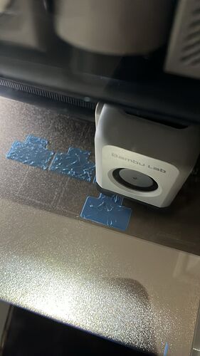

I decide to make calibration with orcaslicer. The PA test could not print much. When i tried to Flow test it failed to adhere to bed instead of pushing out a regular line they were looking like P1S was trying to print with only stringing.
This one is with Generic TPU as filament and generic print profile.
Flowrate Test - Pass1.3mf (66.5 KB)
Custom filament and custom profile I used for Tupper did not work either
The default bed temp was set to 35c. tried 40C and 45 C. nope. Lowered Z during the first layer. Nope.

The default 35C bed temperature with Textured PEI is not working. When the bed is 45C. It somehow stick to bed. This was suppose to be Flowrate 1 test. I assumed the default flowrate of 1 was also way off and thats why only -10 looked better.
With the same settings after adjusting the flow rate i rerun the test and again nothing stick to bed at all. After every print i clean the bed with soap and sponge crazy.
PLA sticks and prints great but not TPU.
Hmm, my bad, I didn’t read well enough. It sounds like it should be dry.

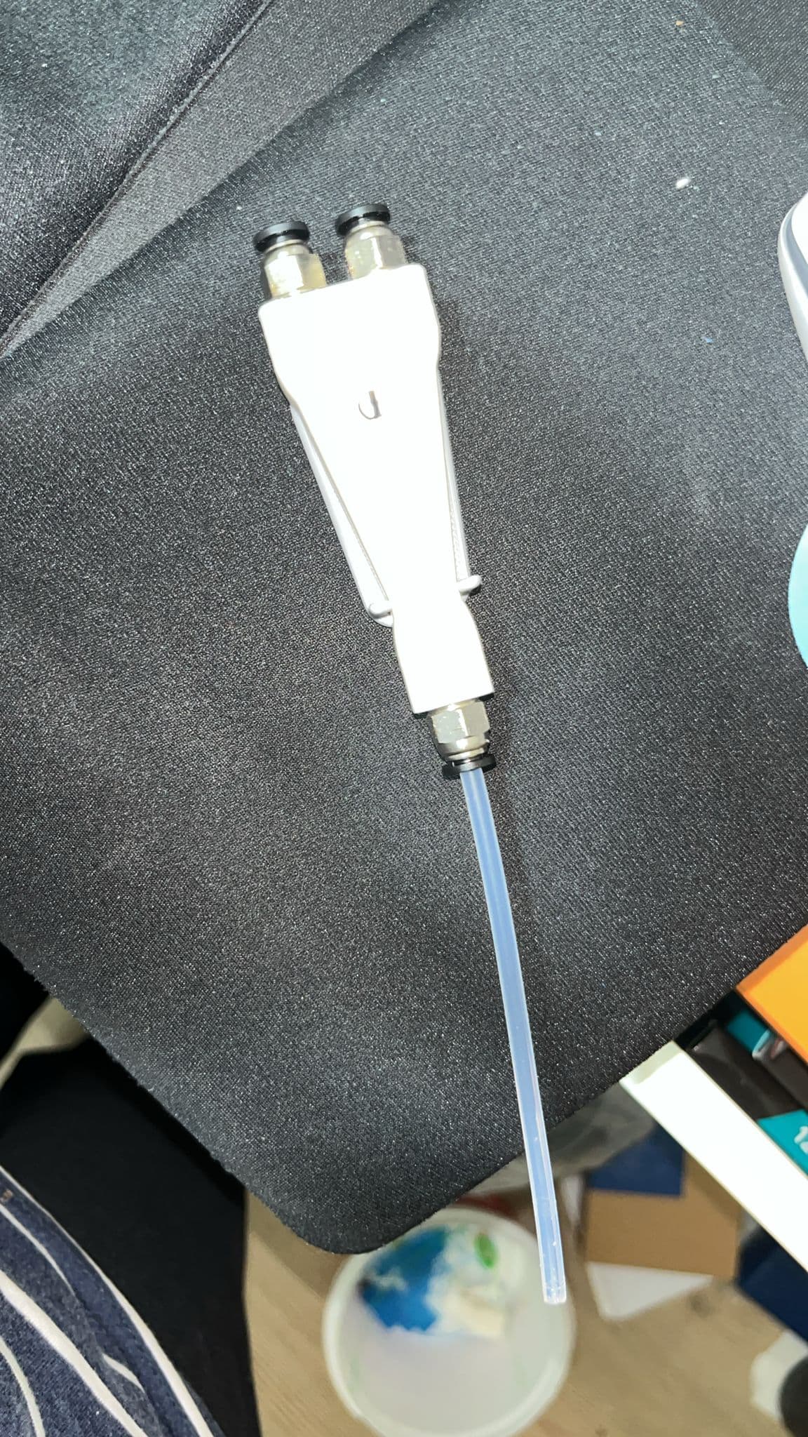

Did you do a quick test for partial clog (that -5 looks terrible)? Manually extrude filament at your print temp and make sure it comes out straight down. Make sure the nozzle is clean and the filament path is unobstructed and feeds smoothly and easily.
I might have found the root cause of the problem.
As nothing was coming out of the nozzle i suspected a clog. I performed a few cold pulls with PLA. When I try to put TPU back into the extruder it did not want to come out. I removed the Y splitter. When i ran PLA through it there was a clear grinding feel. Probably the splints in it were catching TPU and do not let extruder feed. Without it extruder had no difficulty loading and extruding TPU.
I restarted the flowrate 1 test. First layers look much better so far.
