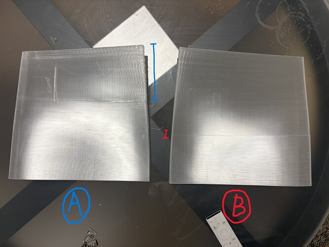

Hello, I am an interior designer currently working on a lampshade project using a Bambu Lab P2S.
I have attempted to print the same model twice, but encountered different types of print failures both times. I am seeking advice on the potential causes of these errors.
I have attached the 3MF file and photos of the results for your review.
[1. Setup & Materials]
  • Printer: Bambu Lab P2S (with AMS 2 pro)
  • Filament: PETG Translucent
  • Machine Condition: Purchased in January this year; no specific maintenance (cleaning, re-greasing, etc.) has been performed since.
  • Settings: Please refer to the attached 3MF file for detailed slicer settings.
[2. Symptoms] (Two attempts of the same model)
Although the models are identical (except for being mirrored), they exhibited different failure patterns:

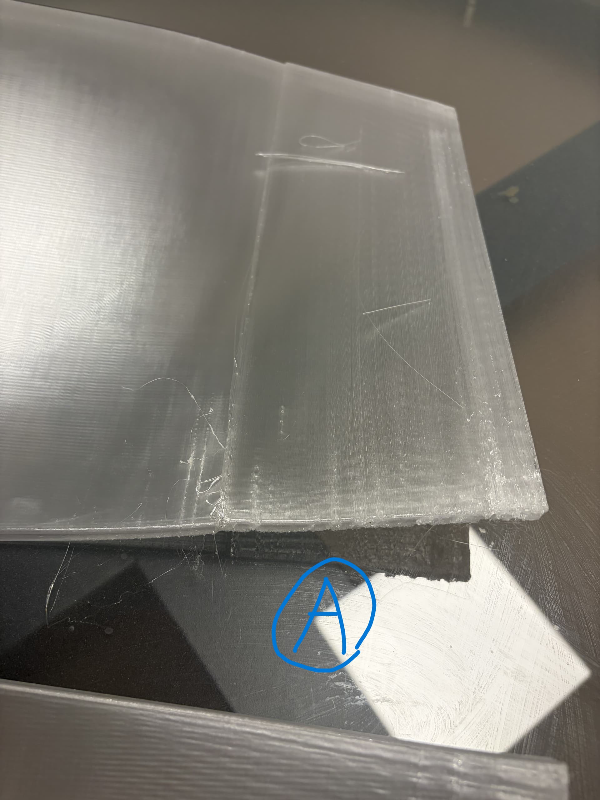

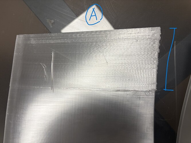

  • Model A: The print failed completely from the mid-section as the layers stopped adhering/extruding properly.

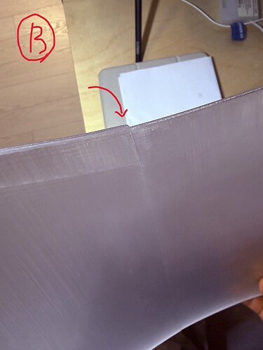

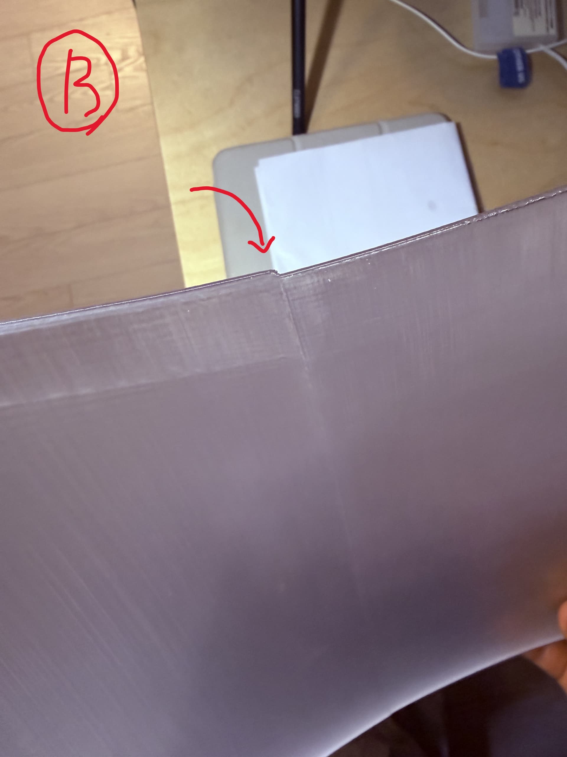

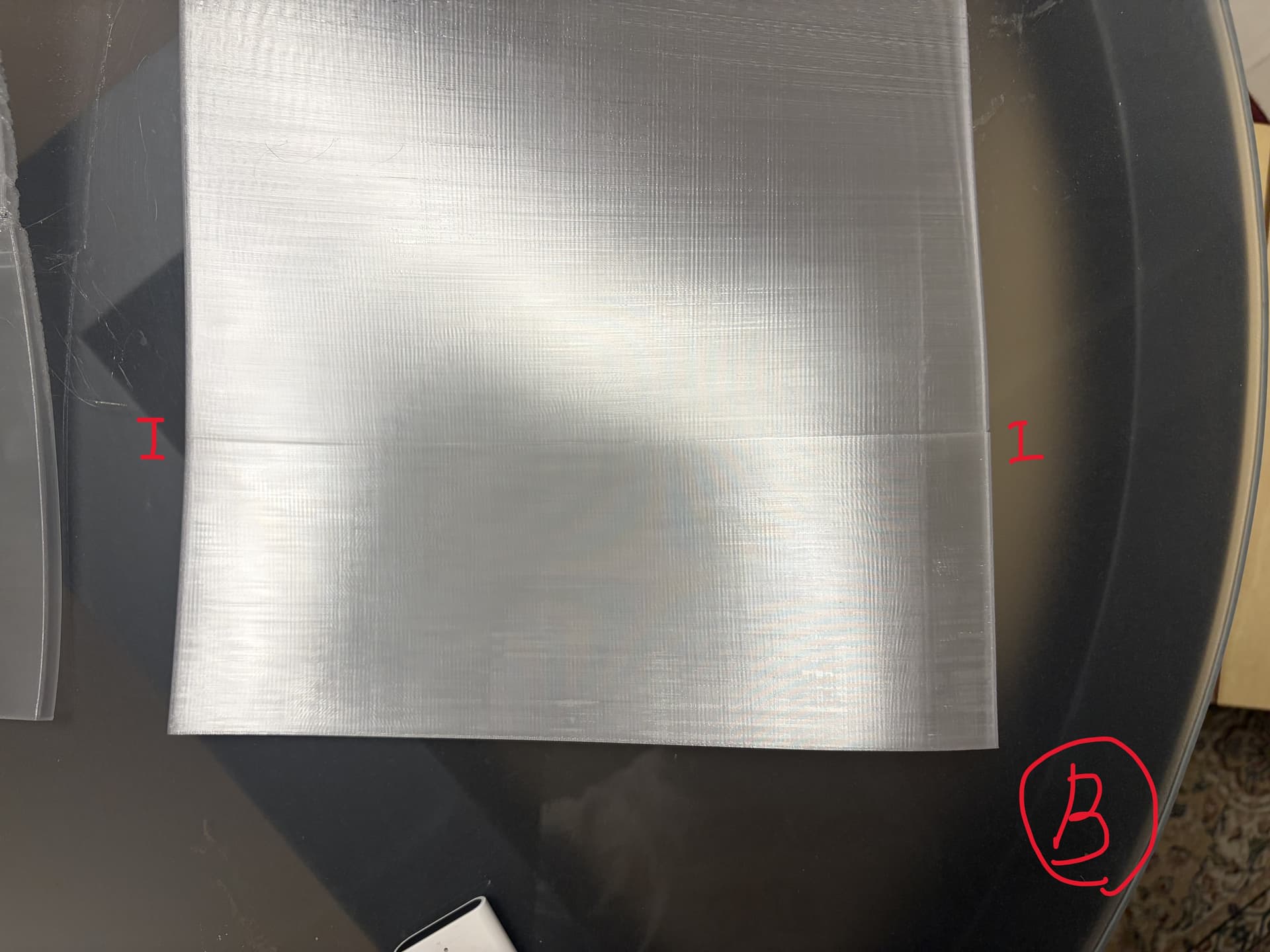

  • Model B: There was a significant layer shift at the bottom, but the printer managed to recover and finish the rest of the model.
[3. My Hypotheses]
Hypothesis 1: Height Issues (250mm)
  • The model height is 250mm, which is very close to the maximum build volume (256mm). I suspected stability issues, but Model B finished despite the height, and the errors occurred at the bottom/middle sections.
Hypothesis 2: Lack of Supports
  • I enabled the “Auto-generate Support” option in Bambu Studio, but no supports were actually generated in the sliced result. I am wondering if the lack of supports in specific areas might be causing these failures.
Hypothesis 3: Lack of Maintenance
  • Since I haven’t performed any maintenance since January, I suspect that debris or lack of lubrication on the Z-axis lead screws might be causing irregular movement at certain heights.
I would greatly appreciate any insights on my slicing settings or potential hardware issues. This is a crucial piece for my design project, and I am eager to get it printed successfully.
Thank you in advance for your help!
260414_Test1.3mf (386.7 KB)
