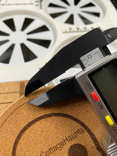

guys, I’m loosing my will to live with laser and its offset. Every position ( I cand do 4 at the time) is different and doing work repeatedly with accuracy is almost impossible. Attached picture show what has been sent to the laser, and actually came out and the difference. Anyone cracked the code on this one and can help me with it or should I sell the thing and invest in Xtool laser.

I’m wasting 20% of material each time trying to set the offset manually. Each time is different so I can’t even use a jig for it.

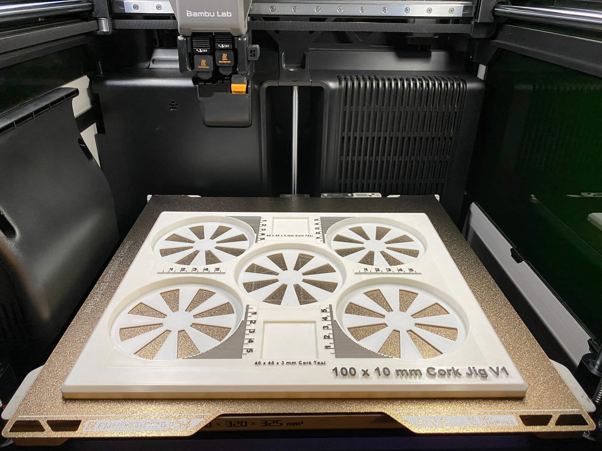

i feel your pain when i got mine i had simular issues so I made an alignment tool with sacrificial pads to check the offset before engraving also the alignment tool helps keep things consistent when doing multiple items, I also always do targeted measure rather than the auto, and avoid having anything too tall near the measurement site as the lidar will pick this up and will add more height and increase the offset, as the birdseye image appears to also adjust based on the lidar measure. It’s still not perfect but it’s a workaround that makes the process less frustrating.
