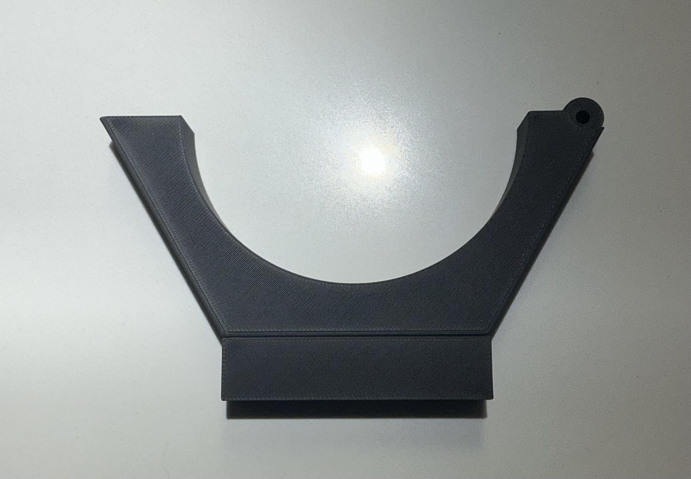

I am trying to modify a telescope mounting ring to have a built-in extension. I need to know the best way to make the extension and how to put a reinforced hole through it to lineup with the existing hole. I would also like to modify the existing hole to a hex shape to accommodate an M6 nut from the round side.
If you have a .STL file for the part, it would be easy to do in TinkerCAD.
For reinforcing the area, you can use a 'modifier in Bambu Studio to increase the # of walls and/or increase the infill density.

I was able to get 90% of the way to my goal in Tinkercad. I now can’t figure out how to make the union between the new extension and the original component.
I assume your second picture has the two parts laying next to each other and are not one piece? If so, I find it easier to do in TinkerCAD. You position the two parts in TinkerCAD and have them overlap by 0.05 - 0.10 mm. Have both parts selected and the “merge” them.
No, they are in fact joined together just not smoothly.

I finally got my design as good as my skills can make it but one of the pieces is not printing correctly and I can’t figure out why. It’s laying down supports for the whole piece as it shows in the slicer but it’s only printing about 2/3 of the part when it lays down the first layer. Any ideas of what to check?
Is the area where the print is missing an area that you have modified? If so, your modification may not be on the build plate, it may be 0.1mm or so above the plate.
Not sure what happened but I redownloaded it from TinkerCAD to Bambi Studio, sliced it and it was printing correctly when I left for work.
I have had some files get corrupted when exporting from TinkerCAD.
