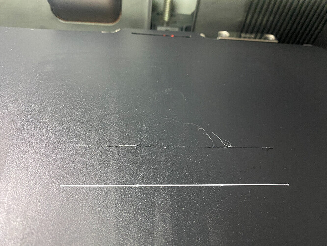

Hi – Trying to figure out what is happening with my P2S using 0.2mm nozzles. We had the 0.2mm nozzle working fine using PLA, but in the last week or so (s/w patch?) we now get all sorts of problems with it. Most of the time the problem is that the base layer prints razor thin to the point of basically pushing no filament at all. If it manages to reach higher layers, it gets very stringy and often fails due to jumbling of the filament.
We thought maybe the nozzle suddenly went bad so we bought two more and we get the same behavior with both. All software and firmware are up to date. We have tried with two computers, even reinstalling Bambu Studio, using basic settings, two different plates, different PLA filaments that are dry and work fine with the 0.4mm nozzle. It’s to the point now where even Flow Dynamics calibrations fail. Any ideas?
Here is a picture after a cold pull:
And here is a result of a flow dynamics calibration with two known-good PLA filaments. The calibration failed.
Any ideas?

Thanks for all the inputs. I downgraded the firmware in the P2S and installed the previous version of Bambu Studio on a machine that had never had a Bambu Studio installed. I also declined to download my settings from the cloud.
The problem still occurred. I finally started doing some more cold pulls with modest success. It became clear that the 0.2mm nozzles (all three!) had become badly clogged. I had to physically force the filament down through the nozzles during the cold pulls to get them to work. One is still clogged. I used the old version of the firmware and BS and ran some calibrations and it worked. Upgraded firmware and calibrations still worked. Finally went to one of our original computers with current version of BS and it works.
Maybe the problem was clogging? Seems odd that both of the new 0.2mm nozzles we bought specifically to troubleshoot this problem instantly had the same problem. Maybe our profile settings were broken. I have discarded all of those settings and will start from scratch.
Hope this helps someone – this was my first experience with actual nozzle clogging.
