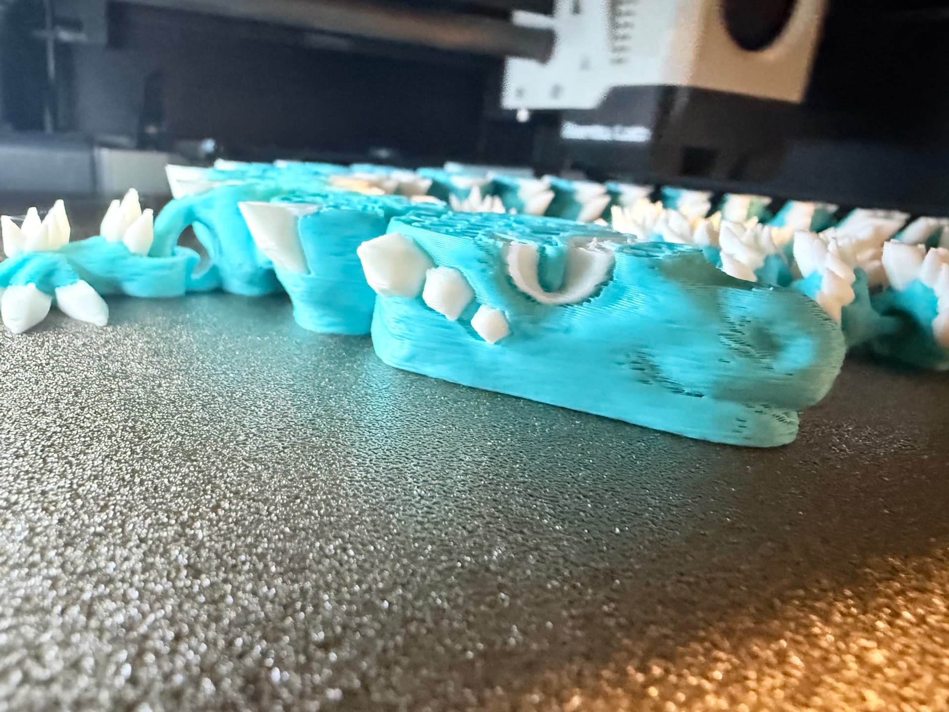

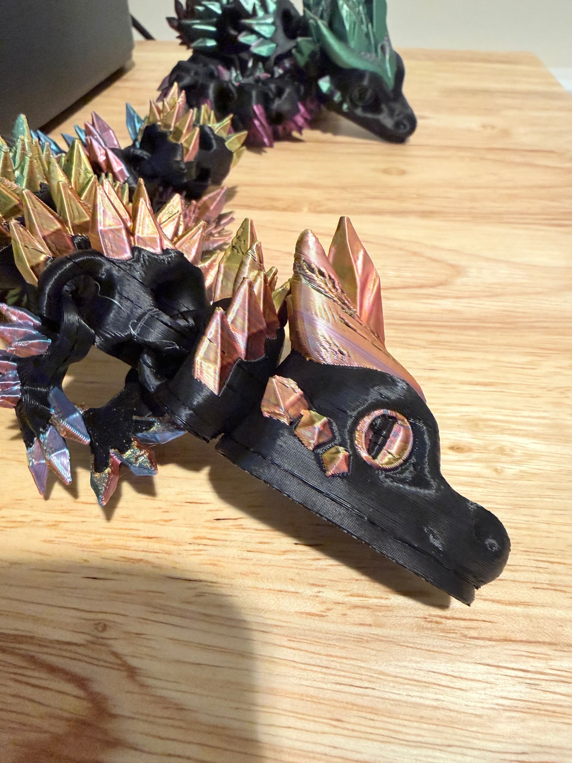

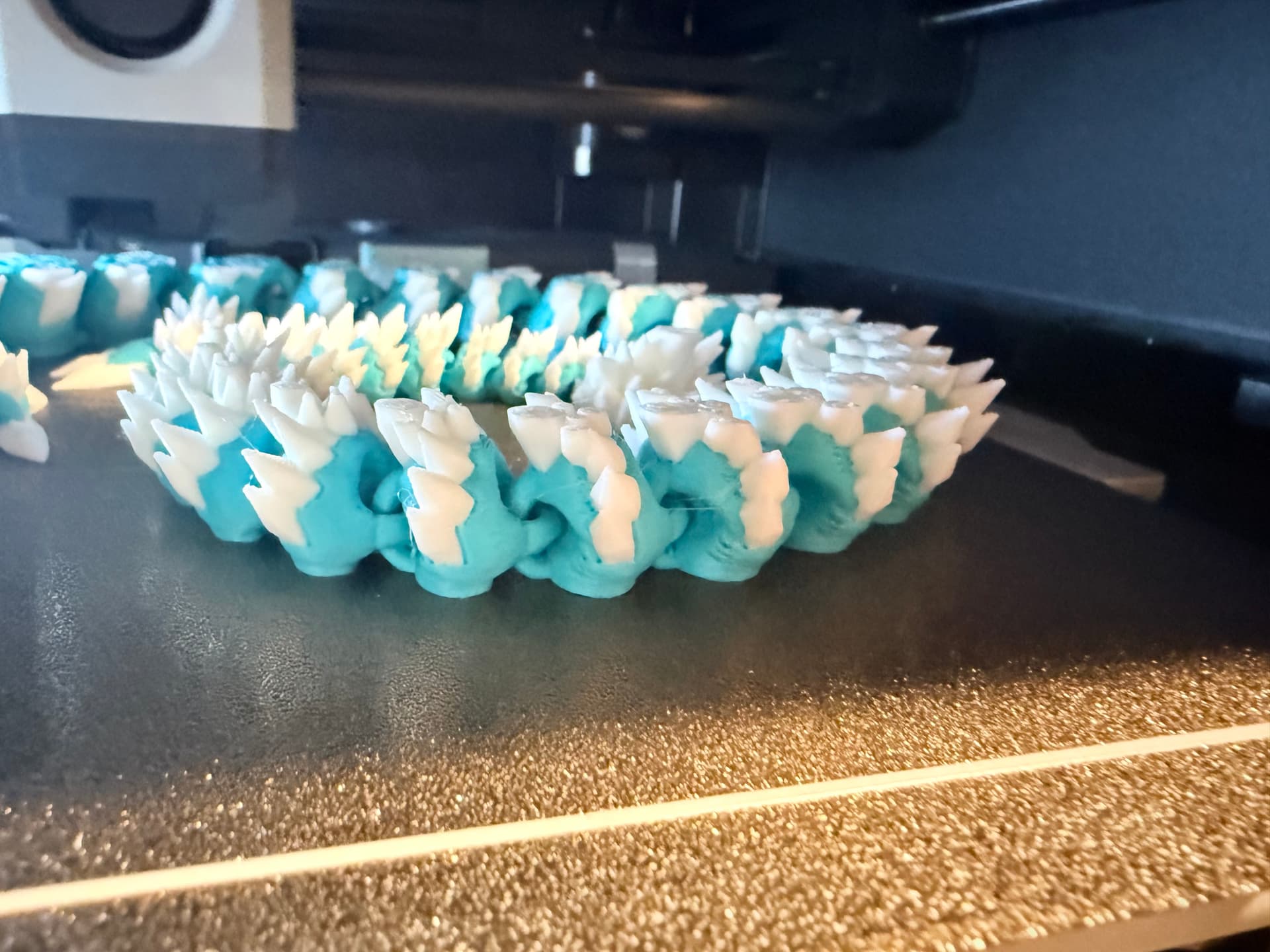

Hi All. I am only a few weeks into 3d printing with the p1s. I’ve been using primarily Bambu pla and silk filaments, but have also used the Sunlu silk as well. My prints were originally coming out great, no issues noted. I’ve noticed some quality issues with my last few prints. The filament seems to not be printing evenly and causing small gaps/stringing/bumpy areas. I tried doing a few cold pulls, and eventually just replaced the hotend last night out of frustration. I did a few test prints and everything looked ok. I’m currently midprint right now and am noticing the same type of issues popping up. I’m including pics in the hopes that will help since I’m not sure if I’m explaining the problem correctly. The black/green dragon was one of the first prints that came out great. The black/pinkish is the one I printed prior to replacing the hotend-you can see issues on the face, and upper horn area. The two of the blue dragon is what is printing now (gaps/stringy). I would be super grateful for any input/guidance here, as I am totally lost.

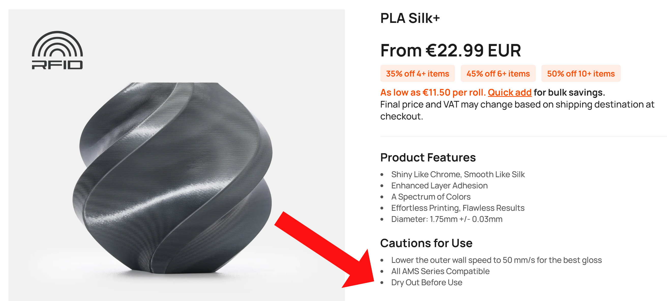

Has your silk filament perhaps become too moist? Silk is particularly susceptible to humidity. That’s why there’s always a warning attached:
Of course, it could be something else, but that would probably be the quickest and easiest thing to check first.
While you’re at it, maybe check the settings too - silk is a bit special in that regard:

Frankly, the defects on the Basic (Light blue) seen in the pictures look much worse than the minor defects on the silk.
Same issue throughout. Might even be a partial clog.
