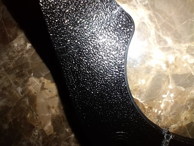

I have tried everything. I am printing on the P2S. I have had it since the 30th of December. I only print PLA and sometimes ABS. I print toys and mechanical parts. It started when I tried printing https://www.thingiverse.com/thing:5029537. Then I tried to print a flexy rex (https://www.thingiverse.com/thing:2738211) and it also failed some layers in. I have scrubbed my build plate (textured PEI) with dish soap and water, added glue, then more glue, then I changed the build plate temp. Then I changed the first layer height, then I changed the line width to 0.8mm!!! After all of this it still was not fixed the first layer TOTALY failed!!! So as a last resort I reran all of the calibration. I did the high temperiture bed leveling, normal bed leveling, vibration compensation, adaptive motor noise cansilation. This I thought fixed it until I printed the P2S camera hiding part that was included in the internal storage yet see the picture to see what happened. Now what do I do!!? If anyone has had this issue and has resolved it or hasn’t I want to here. Maybe if you have this issue and haven’t been able to resolve it we can put our heads together or someone can help us all out.

I was with you till you mentioned this, why?
You mention fails, but no description of what failed…
Attach a pic of the underside of one of your prints, so we can see how the surface that was attached to the plate looked.

Yes my bad. First The line width was to try and increase the “squish” to maybe get it to stick better. About the fails It was the parts getting nocked off the plate as the print got higher. As you asked here are some pics

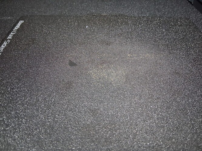

Absolutely never, ever, use Scotch-Brite green pads on PEI!!!
Ask me how I know?
Answer: I have ruined one side of my original Bambu PEI build plate. Scotch-Brite green pads are aggressive abrasives intended for hard surfaces like metal and some glass cooktops. They are NOT intended for polymer coatings like PEI that rely on a controlled micro-texture for adhesion.
Don’t get me wrong, I keep boxes of both the green and red pads on hand, along with the dual sponges shown above. They are excellent for cleaning cast iron barbecue grill grates, but they permanently alter surface finishes and will destroy PEI texture.
Here’s a comparison. On the bottom is a 2025 Creality textured PEI 350 mm plate. On top is a 2023 Bambu P1P build plate that was later replaced by the gold version. Those of us who have both the original black and the newer gold plates will tell you the gold coating is nowhere near as consistent or precise as the black was. Creality is effectively using the older texture formula. Note how the texture near the corners is nearly identical between the two plates.
Now look at the same Bambu plate rotated 90 degrees with the same camera angle. There is almost no contrast because the texture, thanks to a Scotch-Brite pad, has been abraded nearly smooth.
These are the ONLY abrasive pads that can be used with relative safety on PEI:
Also sold generically as nylon scrubbing pads:
https://www.amazon.com/s?k=nylon+scrubbing+pad
Scrub Daddy pads (the nylon type) are also acceptable:
https://www.amazon.com/s?k=scrub+daddy

The bed plate you show was scrubbed way too hard/aggressively. Hence my advice of very light pressure. It’s not about taking material off, it’s about very lightly scratching the surface. I stand by my suggestion, it has worked very well for me and my plates don’t show any appreciable wear from doing it.
