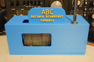

I have managed to do a simple print using the Text function in Studio as mentioned at the beginning by MZip, so for now I have a method.
It’s a Valve type medium wave broadcast unit so I can send music to my old valve radios I collect, it’s only milli-watts so only has a range of around 10 feet.
Adrian
