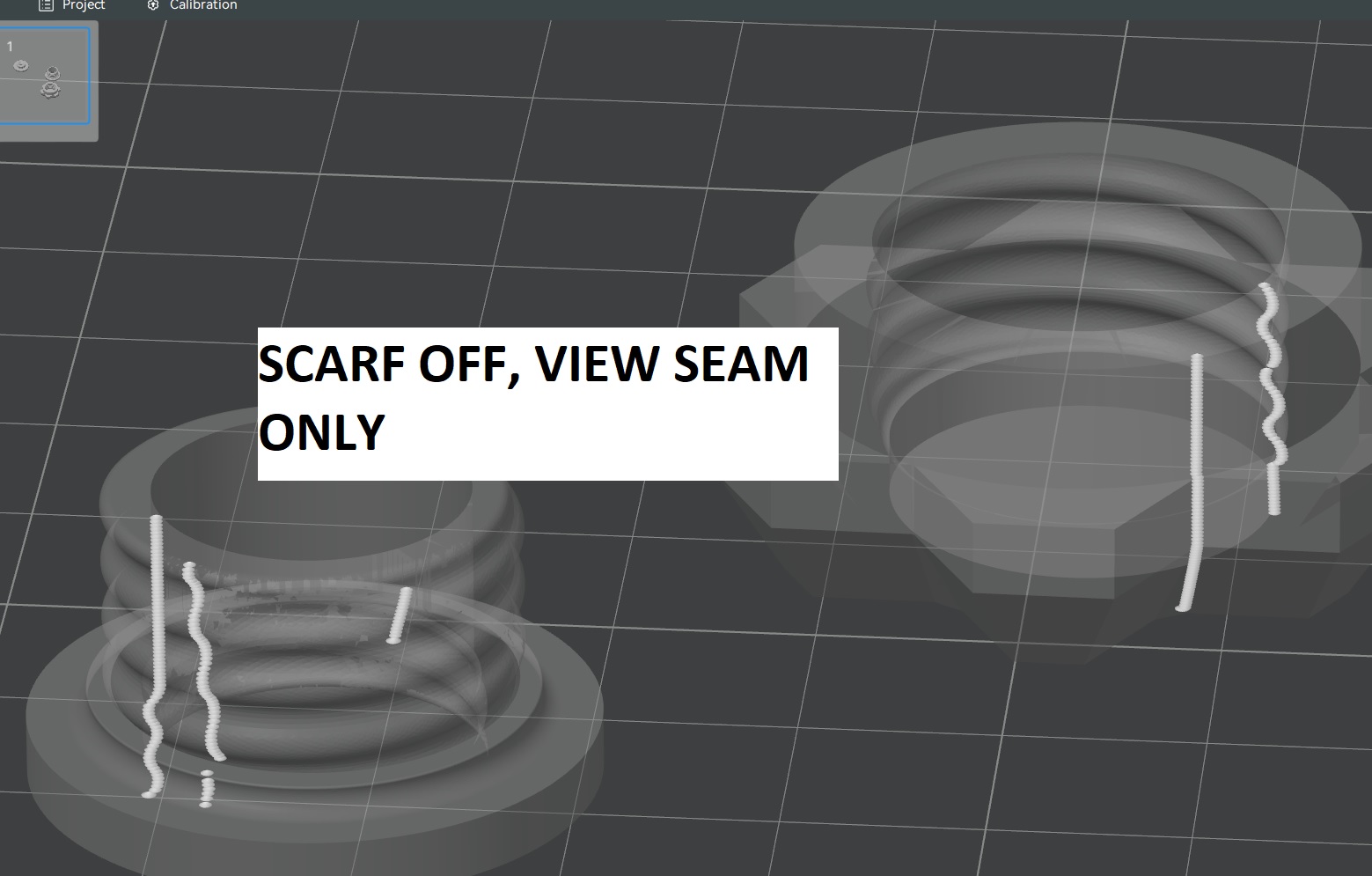

what view are you using to see that ?
I turned on seam only
As well added some photos,
Strangely the cap on the right did not get any scarf added, but the item on the right did.
Then with the addition of the contour and hole, the item on the right got a scarf added to the inside but not the outside.
I tried it on another project and noticed that it only applied a scarf to the inner threaded cylinder. But completely missed that outer cylinder inner and outer.

I managed to add the photo into this responce
scarf
Scarfs were moved almost immediately after they were added into a version of Bambu Studio.
It seems some materials didn’t do well with them, so, they were moved to the filaments section.
You need to select the type of Scarf seam from the screenshot with the big red arrow or they will not work.
