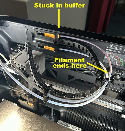

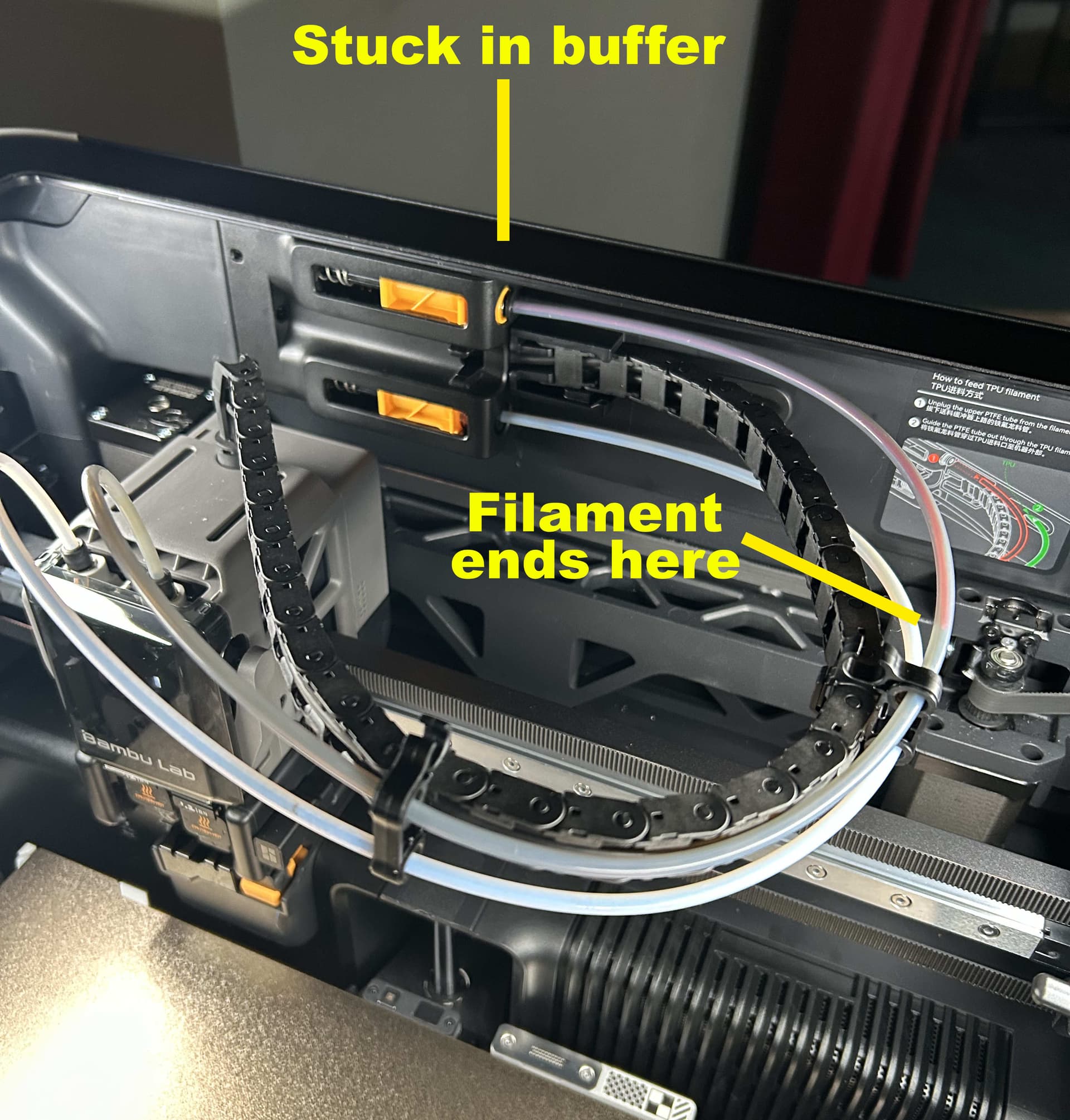

I upgraded from the x1c to the h2d a couple of weeks ago, and it’s worked like a dream until tonight! I must have put a rubbishy pla filament into the AMS, it snapped. I followed a Youtube video to clear the broken filament out the AMS and it’s fine now, and the ptfe tube is clear all the way to the printer. The problem is there is still a broken piece of filament between the buffer and the toolhead, I tried pushing a piece of filament from either side to clear it out, but it won’t move either way, as if it’s clamped in place somehow. I have no idea how to get it out (I’m pretty new to 3d printing, so I’m no expert), I attached a photo to make it clear what I mean. Thanks for any help.

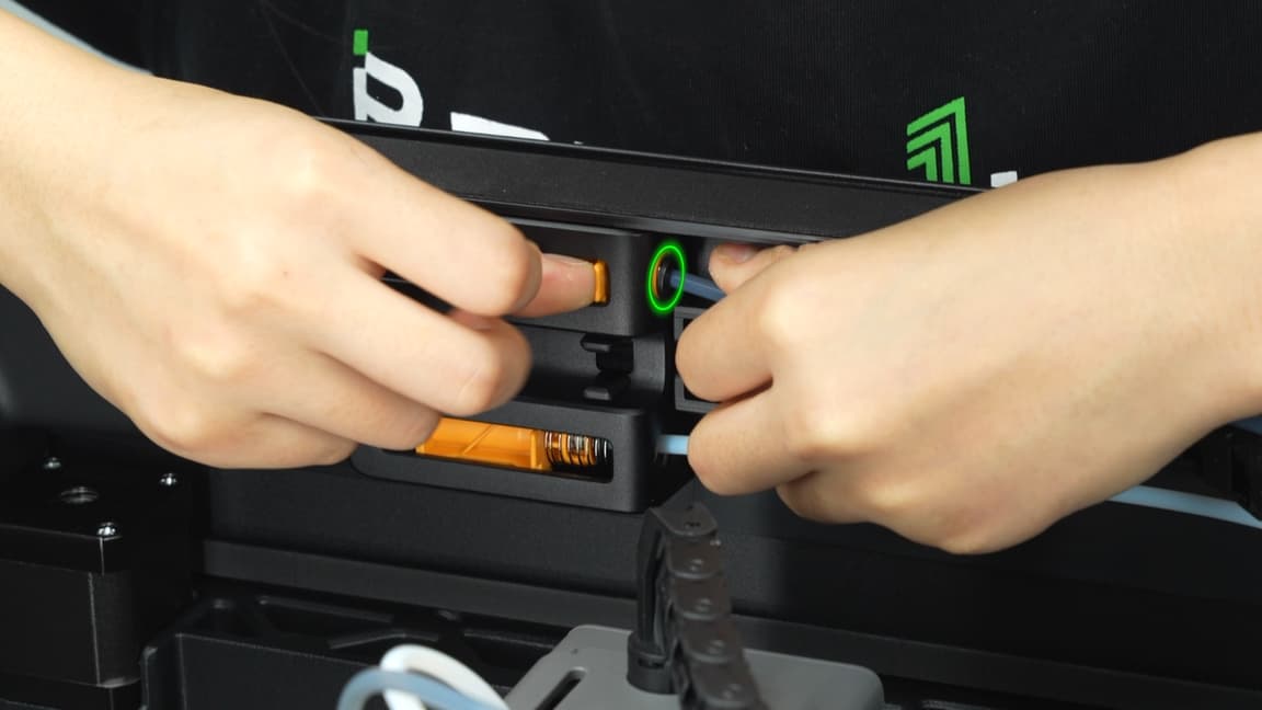

Pull out the tube from the buffer and tool head. Then you can use another strand to push it out if you cant get your fingers on it.
Thanks for the quick reply, I’ll go try that
A bit finicky, but I managed it ok and it’s back to working normally :grinning:
