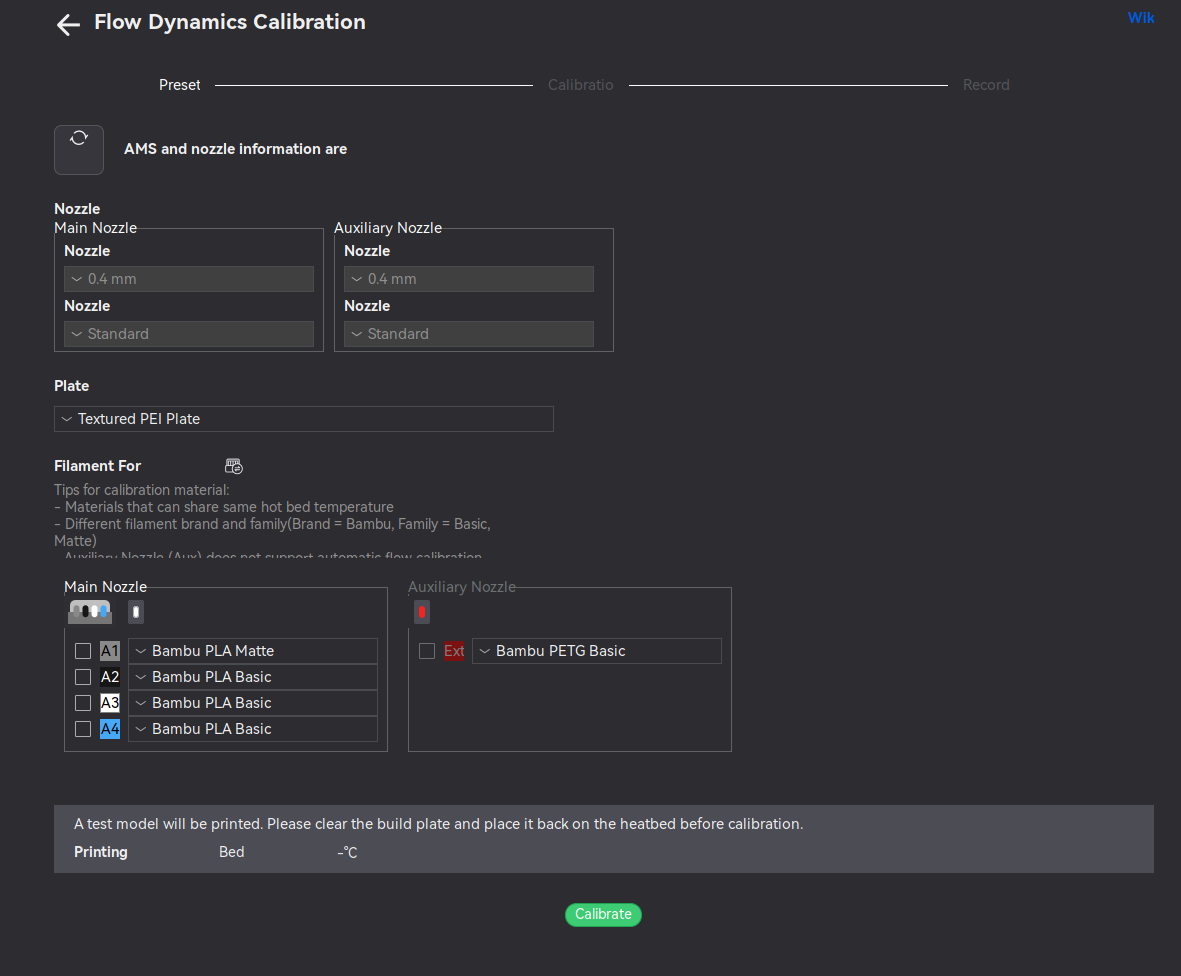

I have not tried to use the flow calibration in the slicer before and was having some minor issues with my new X2D using PETG in the auxiliary nozzle when using it for support interfaces for my prints. I have already done the other calibrations from the developer mode which yelded the current settings wen’t an issue but I wanted to try this that is in the calibration tab. when I opened it and choose automatic, the slicer will not allow me to select the loaded spool of PTEG on the right nozzle, but only allows what is loaded in the ams for the left nozzle.
Am I doing something incorrectly? the Bambu wiki doesn’t say anything about not being able to select filaments that aren’t in an ams (manual spool holder) or anything for the auxiliary nozzle that is a boden drive setup.
Have you actually loaded the EXT filament (PETG Basic) into the nozzle? You have to physically load any/all external spool[s] into the hotend/nozzle before you can make any use of it.
Yes the filament is loaded into the nozzle. I played around with it and it allowed me to do a manual calibraton, just not with the automatic. printing with the manual it printed lines with a K factor from 0 to 0.5 the 0.5 was the best of them all but there was still a buldge on the ladder part of the line.
I am re-loading the PA test from the developer calibrations to re do this with higher setting. I believe the devs may not have implimented the auto calibration for the auxillary extruder for PETG yet due to how new this printer is.
Btw. I am on linux (Kubuntu 24.04) with the latest public beta of Bambu Studio. might also have something to do with the calibrations.

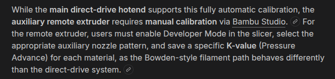

Info I found online and this is something I suspected as well. it’s not the slicer but the right nozzle (auxiliary) does not have a sensor to do the auto calibrations. I found this tidbit online and my search AI said this…
I ran the manual calibrations again for it and found that best K factor for PETG seems to be 0.46 to 0.48. seems kinda high but then again it’s a boden setup. I experienced this on my old Ender printers as well. Now that this is set I can re-calibrate retractions and others. I learned with my old Ender 3 that once you have flow and other retractions in the ball park, to get the PA (pressure advance) calibrated, then go back and re-run all the calibrations again. then again re-run the PA once more and see if it needs to be dialed in further. If the PA gets changed you have to go back and re-do all the other calibrations except for max volumetric flow. a single change will effect the others. back in the day I had my old Ender 3 printing really good quality for what it was. For this new X2D, it’s back to the basics for the right side extruder!
