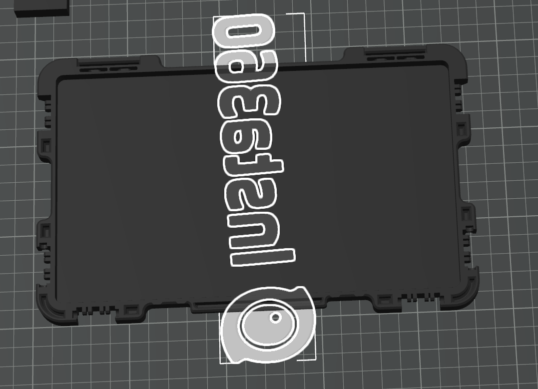

hi, so im making a box in order to put my phone gimbal. I found the cutout and the box but the problem is everytime i get the logo in i cant get it to slice properly. Could somebody please help me get it to slice properly and also explain to me how its done because i try everything different thicknesses, merge, negative and it never works…

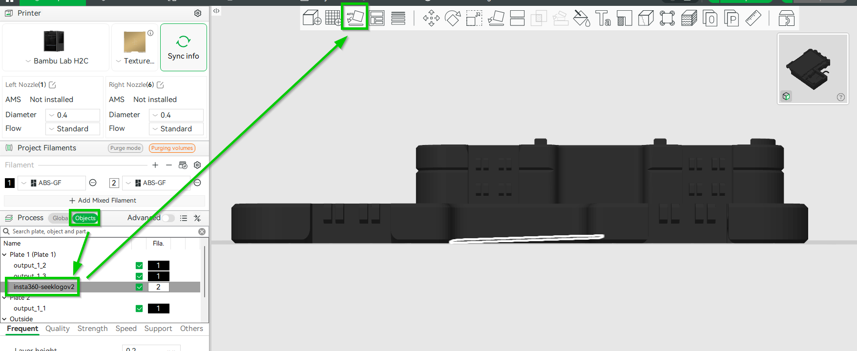

The problem seems to be that the insta360 object is not horizontal.
What i did was:
Use Auto orient to get it flat on the bed (Lay on face does not help).
This will adjust placement.
Use the Rotate and Move to to place logo where you want it.

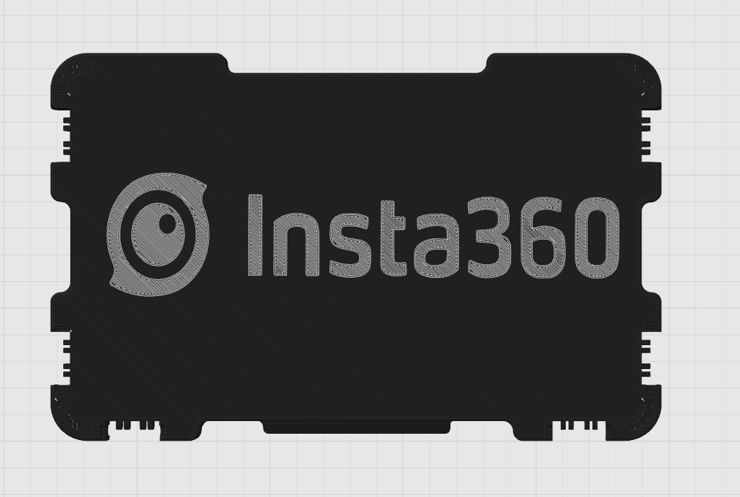

After slicing it looks like this from the underside viewpoint:
