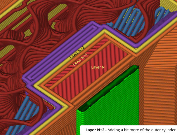

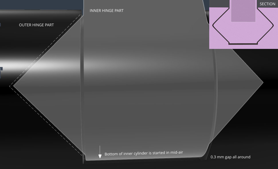

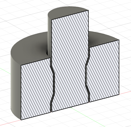

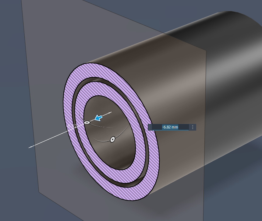

I’m slicing a model that I can’t share unfortunately but I will add as much information as possible. The model is fairly complex, and it includes two hinges for a lid. I modeled the hinges myself as a solid cylinder inside another hollow cylinder with the caps as cones so that it prints in place and it can’t be dismantled. A section through the middle of the hinge would look something like this:

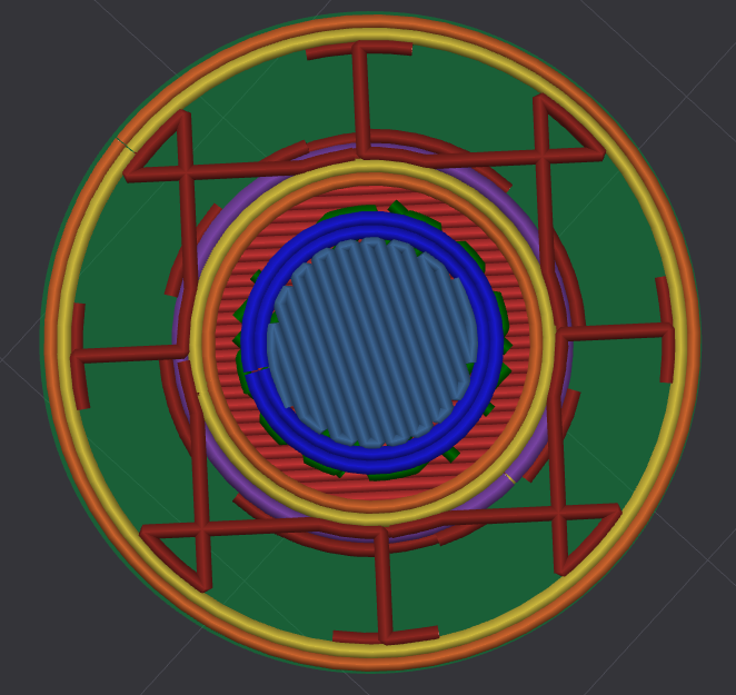

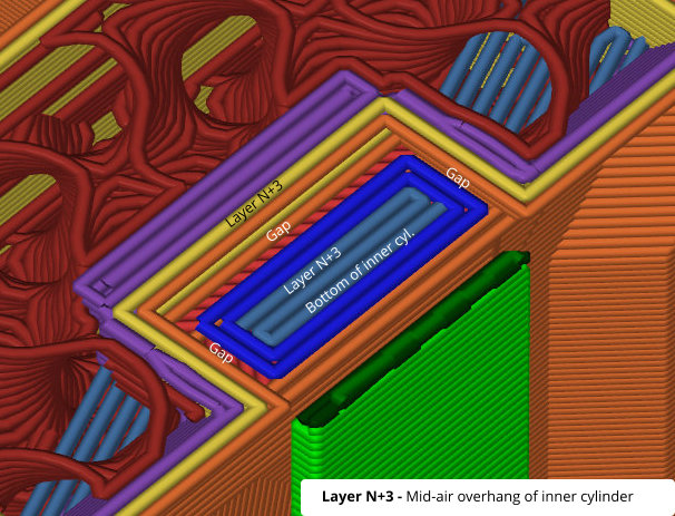

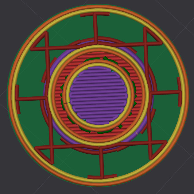

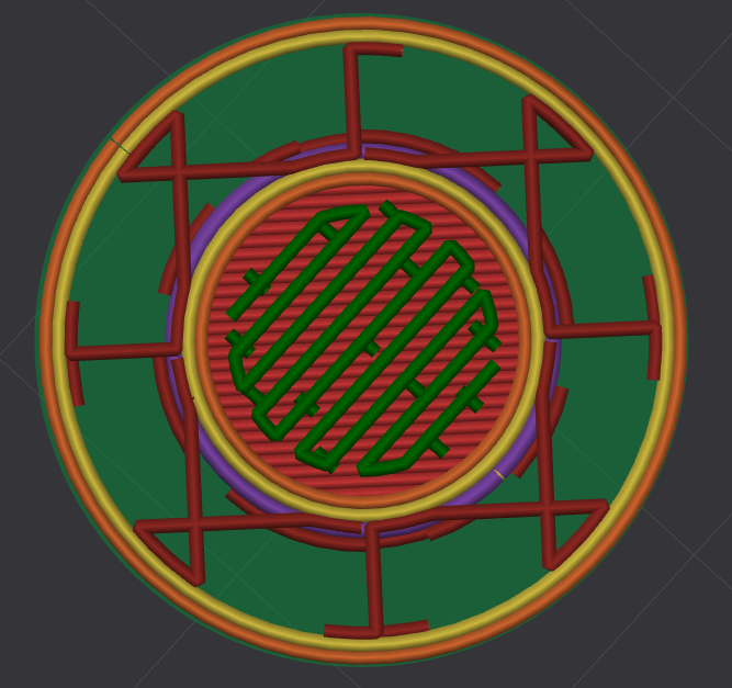

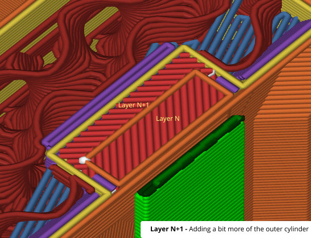

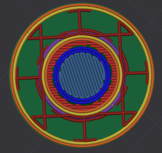

The gap between the two parts (cylinders) of the hinge is 0.3mm. When slicing the model in Bambu Studio, it does not add any support of the bottom of the inner cylinder, but considers it overhang. I attached screenshots of the print steps on those layers.
The thing is, I already printed just the hinge and it works as intended, to me that’s black magic, as I don’t understand how the printer started the bottom of the inner cylinder. I’m guessing it printed in mid-air and the filament fell down two layers on the outer cylinder and somehow kept doing that. It did need a “pop” after printing as it was obviously stuck, but nothing major. Looking at the printed part, it’s hard to see anything inside that area as the gap is so small.
What I would like to do is to add a bit of support on the model between the two cylinders so that the spacing between them at the bottom is correct and smooth after breaking the small supports. I tried drawing support in Bambu Studio but it won’t add support there and keeps the layer type as overhang (blue) as you can see in the slicing screenshot.

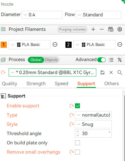

EDIT: Added some information about the printer and support settings.
You basically have it right. The filament printed and fell down to the bottom and built up enough to support the upper layers, letting the print complete. For me at least, this is something I rely upon when making print in place hinges or sockets. That bit of filament that droops down basically creates a weak support that breaks away when you move the joint for the first time. I’ve never seen a need to add additional support here, as that’s adding additional filament I don’t want in the cavity.

Looking at the sliced model, I don’t see any bridge created (see screenshots above) but maybe there is an option somewhere to do just that. I can confirm at this point that my original guess was correct in that it simply prints in mid air and lets the filament fall on the layer below. It’s a 0.4mm fall which I can clearly see on the printed part.

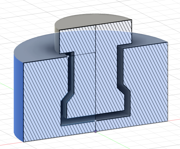

I whipped out a simple model to do a test. I think AI is making up stuff about what Bambu Studio (BS) does in this case.
Here is the cross-section of the model. I set the gap between the two parts to 0.8mm to make it easier to see inside BS.
First I didn’t enable support and BS threw out an error about “floating region” and asked me to re-orient the object or enable support generation

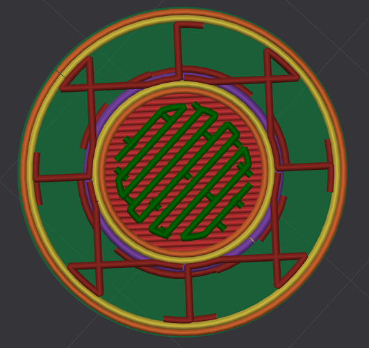

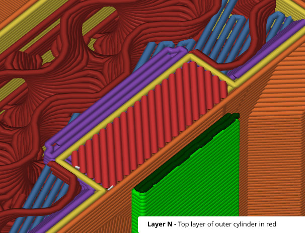

So I enabled support and left all default settings as they were. BS generated the support interface (the green pattern in the center of the 1st image below), and then the overhang wall and a bridge layer (in blue and grey in the 2nd image) on top of the support interface, before proceeding to print the inside part (3rd image).
So BS does make a bridge layer but it is on top of the support structure, not across the walls of the outer cylinder at the base layer of the inner part as described by the AI overview. The AI is either smart enough to make the inference because that bridge would have worked, or it read about that kind of bridge being done on some other slicers and infers that BS would do the same.
Edit: If the gap is smaller, such as <=0.5 mm, then enabling the support will not create the support interface. It will only create the overhand wall layer and use that as the support. This makes sense because the gap is too small to fit in both the support interface layer and the overhang wall layer.

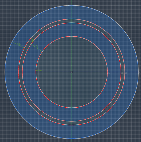

In my case the gap was 0.2 all around and it did cross my mind that this might be the reason why it was refusing to create supports.

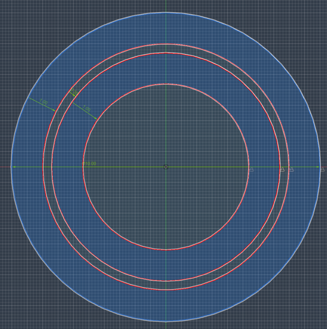

I did some testing too with an object closer to my original design: a tube completely enclosed inside another tube. Playing with the gap value between the two tubes, at 0.2 and 0.3 BS won’t suggest or create when enabled supports for the bottom of the inner tube. At 0.4 it warns that there are unsupported parts. Since I’m working with a 0.2mm layer height, for a gap of 0.2 between the cylinders, BS will have a single empty layer under the inner cylinder (obviously). And at 0.3mm gap, it will have two empty layers under the part.
