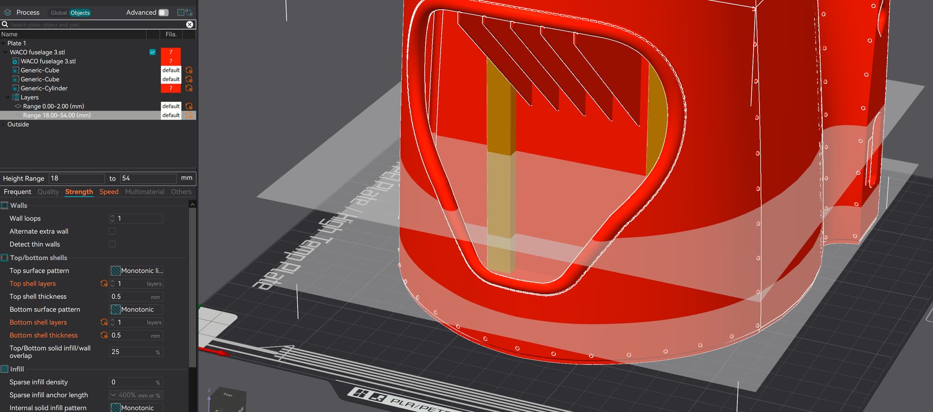

Hi community.

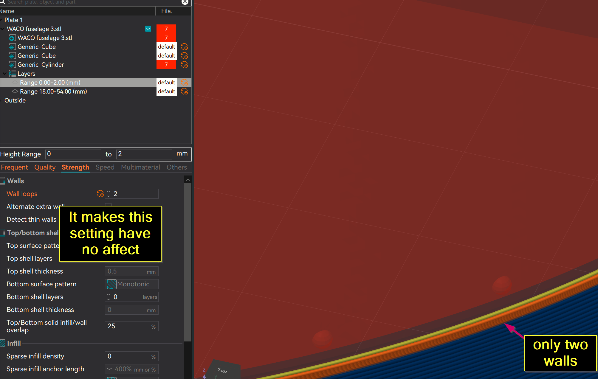

I’m having an issue that I’m not understanding if it’s me doing something wrong or if it’s a bug.
When I add a modifier with the goal to change the number of walls, instead of changing tit in the affected are of the model only, it also draws the modifier shape and creates the walls for it.
This is not the intended use case, I just want the model affected without adding this walls, can someone please help if this is a bug or just me missing something that changed meanwhile?
Project attached for reference.

Hi.
Thanks for the quick reply.

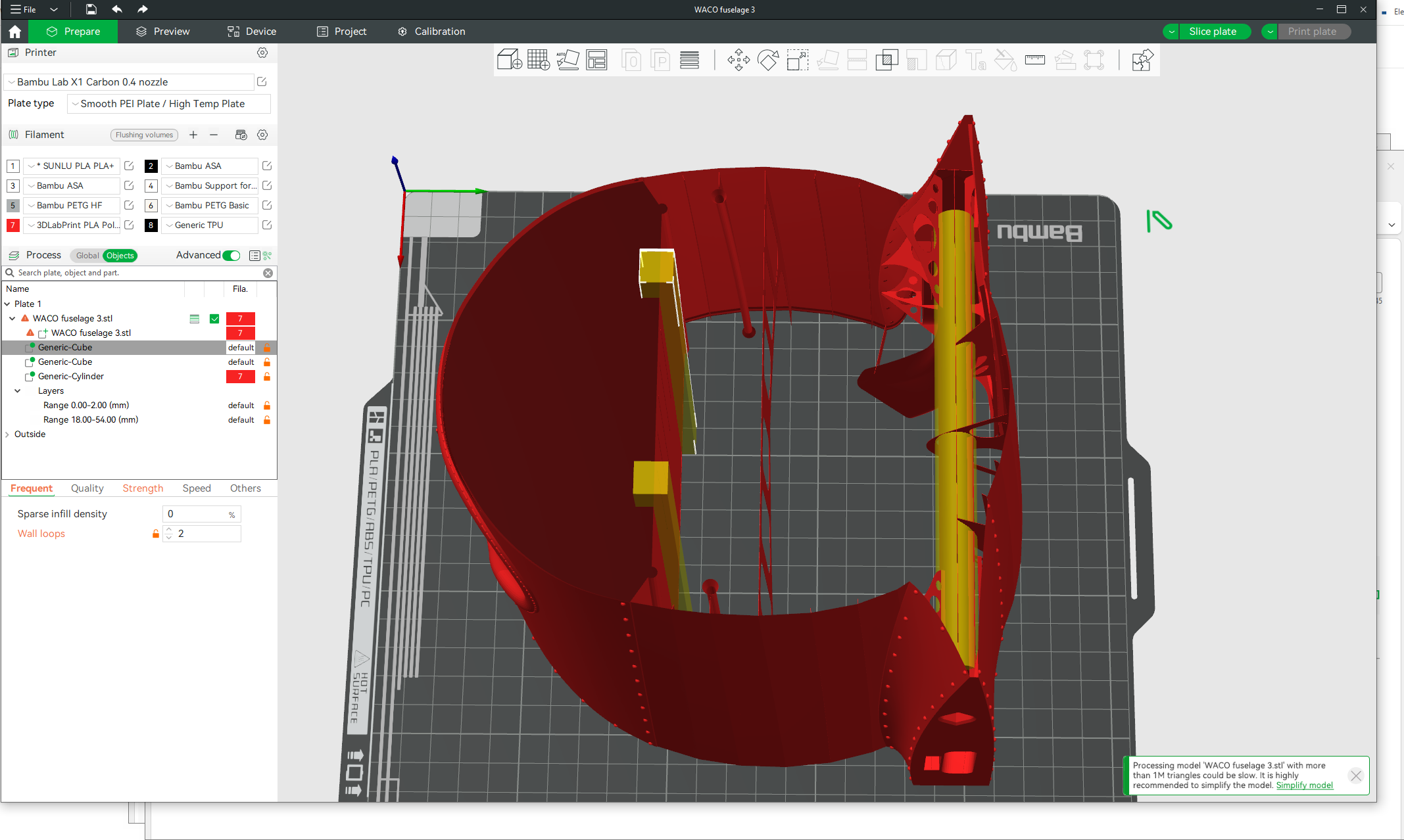

Please see the pics attached.
In this case I would expect to have the object affected and nothing added.
To actually add something, was my understanding that it should be with the “add part” feature.
But please look carefully to the preview, it’s very odd, it only built the full modifier of the structure in one side, the other is only in top and lower parts of the modifier that it set the modifier perimeter also.

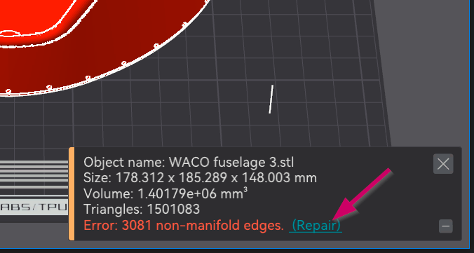

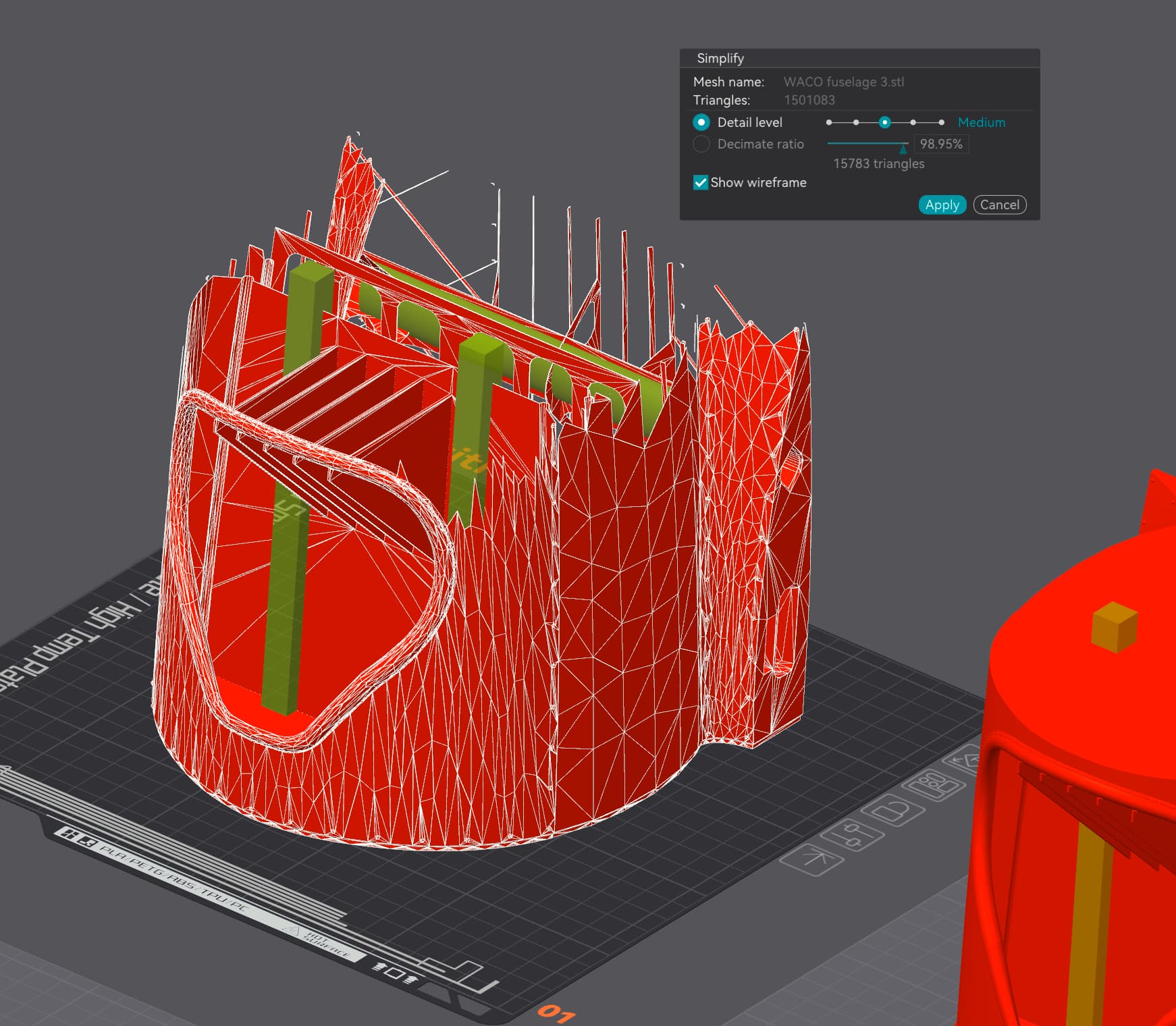

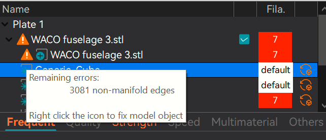

The answer is right in your model.
Don’t ignore these messages. You have to repair your model before you can diagnose anything.
Once you’ve cleared that error, then do as @MalcTheOracle has stated. Upload a screen grab focusing on the area you are not happy with. Make generous use of the layer slider to reveal problem areas. Once we can see what you see, then we can better help you.
I have downloaded you model so after you’ve done the above diagnostics, I can offer better insights.
BTW: With 3081 non-manifold edges on that model that has 1,501,083 vertices, depending on your computer, this repair may take a few minutes. So go get a cup of coffee(Tea I suppose if you’re from the UK​:wink:) and come back in a few minutes.

The issue is, we are instructed by the model maker to not attempt any fixes, it’s intended to be this way.
I’ll try to fix and save as other project to see the differences.
Thanks for your feedback!
That to me is a red flag!!! Why would one stated that a model with non-manifold shapes be left alone? That is asking the slicer to figure out what to do with the holes, it will produce unpredictable results.

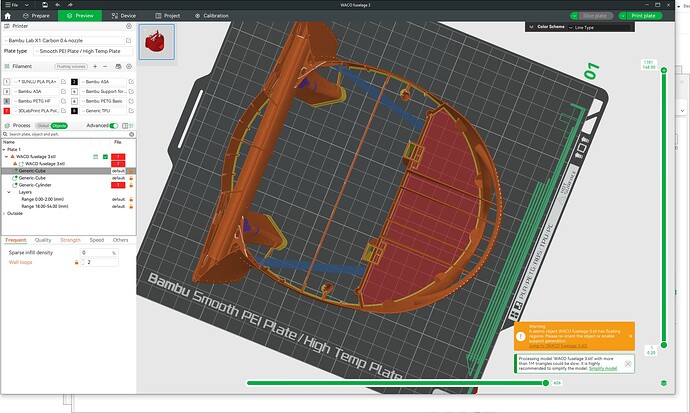

well, like I was saying, fixing break the model, removed all the re-enforcements of the airplane structure, and the modifiers still act the same.
No clue what to do here, I guess I’ll need to live with the inserted forms…

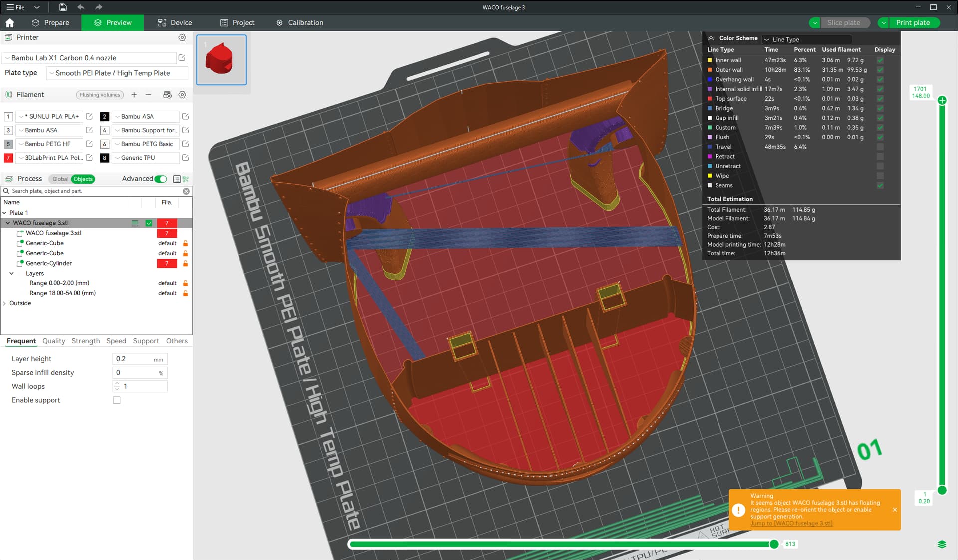

OK. I now understand what the model maker was doing. Not to be too picky but I have no choice. :man_shrugging: The model maker needs to go back and fix this model. This is just sloppy CADmanship to be honest.
I still am unclear as to what you are not satisfied with on your model though since your image doesn’t really note what areas are not to your liking. But if I were to hazard a guess based on your previous post, I’m guessing you want the range modifier to apply to multiple heights? Is that correct?
If I further examine your model, I’m unclear to what your objective is with the range heights. You have changed the top and bottom shell layers to one but that range of 18-54 millimeters doesn’t have any horizontal surfaces to affect that. Then you changed the speed too? What was the objective?
Likewise in your second range modifier you changed the wall looks to 2 but the problem there is that the wall is so thin, there isn’t more than two walls to begin with.
Clearly I am missing something so feel free to help me clarify.
So, if you disable the cube modifiers you’ll understand how de model looks without them.
I’m trying to add reinforcement points, because the printed model get’s week on those points. The 2 vertical modifiers are to add strength and avoid the part to move.
The horizontal one is also to add strength because it gets into a bad printing due to long overhangs.
The layer high mod from 18 to 54mm is to add top and bottom layers in the back in the side holes you see.
The layer high mod of the 1st 2mm is to add an additional wall to reinforce the gluing of the parts.
This is a very difficult print, has a lot of overhangs printing with one wall only by design, it’s really easy to fail.
I’m already slowing down the print as much as possible, but parts still flex and causes issues.
I also tried to add suports, but they never work inside the model I don’t know why… :frowning:

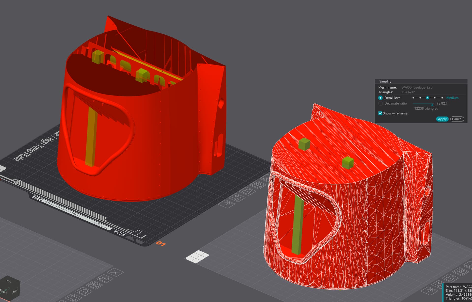

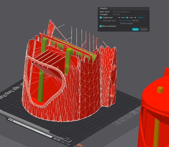

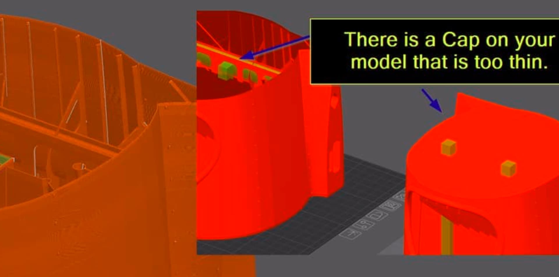

I think I see what you’re trying to do but it’s just not possible with the way this model has been imported. Perhaps visual would be easier to understand.
This is what you model looks like in the slicer before it has been repaired. Notice all the holes, that’s a non-manifold object which your trying to add modifier. That simply won’t work.
Here is what it looks like once the model is fixed. The geometry has no been enclosed which is likely hampering what your trying to modify.

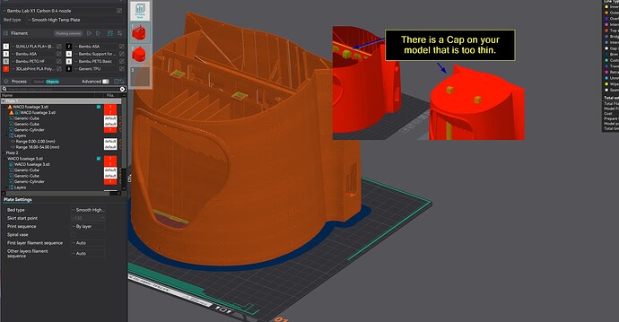

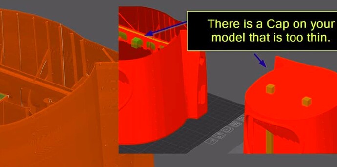

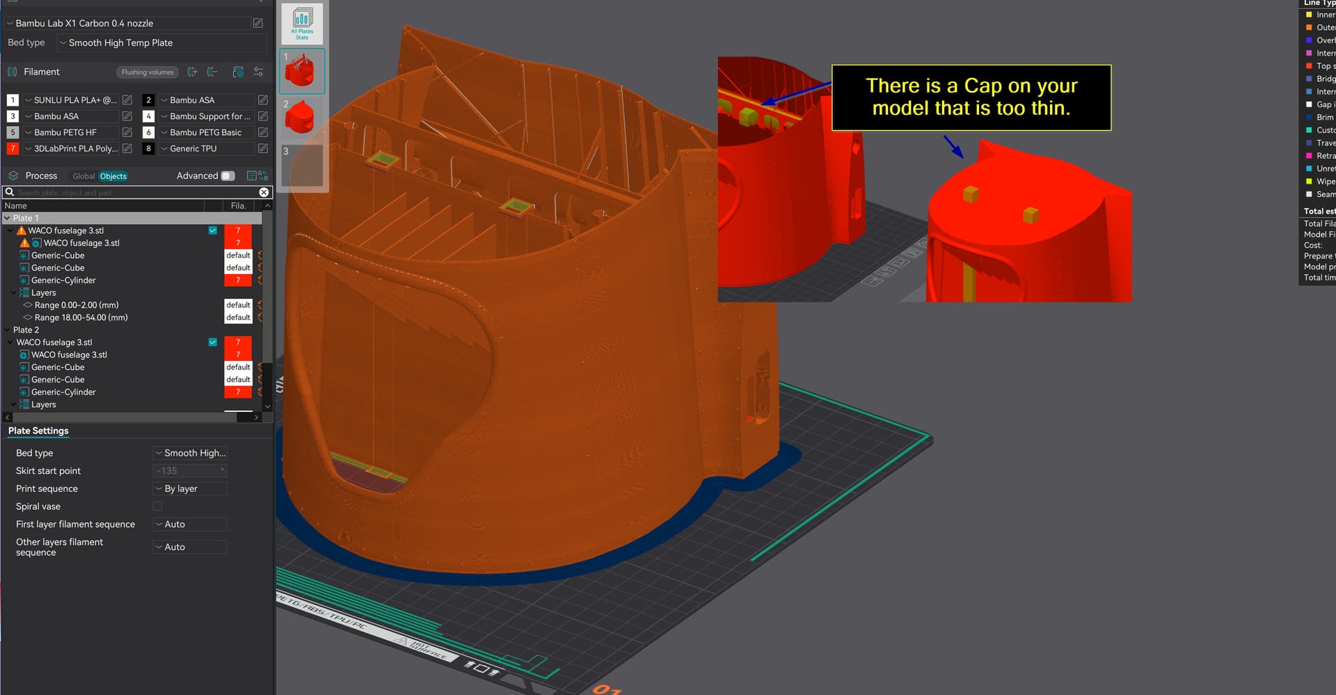

What I think you are looking to do is use those to cube modifiers to make a brace. The problem is that your model has a layer(Top Cap) in the design that is so thin, the slicer is ignoring it even though it shows up in the rendering. The slicer is designed to do that even when I reduce the layer height to 0.08
______________________________________________

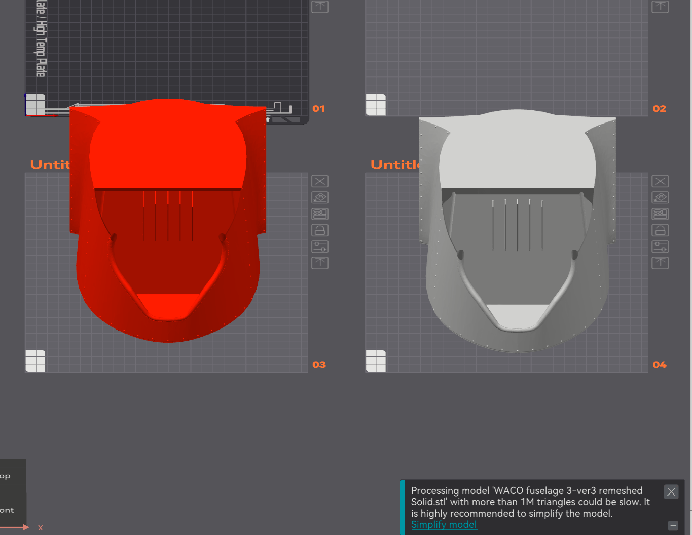

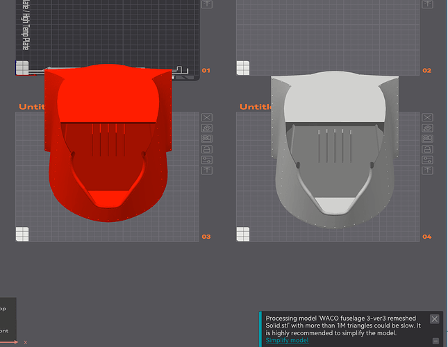

I did some remeshing of your geometry just to see if this might help. It’s obvious that your model is being exported as a hollow object and that is causing you a lot of issues. However, look at this 3MF and try to see if plates 3 and 4 might be better suited for your needs. The problem is that the top lid is not being rendered because of defects in the model geometry.
The file is too large to share via This forum. This is the first time I’ve used limewire in 10 years so proceed at your own risk.
Plate 3 is your model but repaired and simplified to fewer vertices. Plate 4 is the next step where the model was remeshed in Meshmixer. Unfortunately, Garbage In/Garbage Back. You can’t create pixels and arcs from nothing so there isn’t a top layer when this slices. That’s the fault of the model.
This part I’m not understanding.
The model is sliced with precision resolution at 0 and also slice gap closing radius at 0 to avoid loosing the thin parts.
If I would left the default values here, part of the structures would get lost.
Where do you see something being lost exactly?

I noted it in this screen grab. On the left is your model on the right is the repaired model.(Click to zoom full res) Note that there is a solid surface
