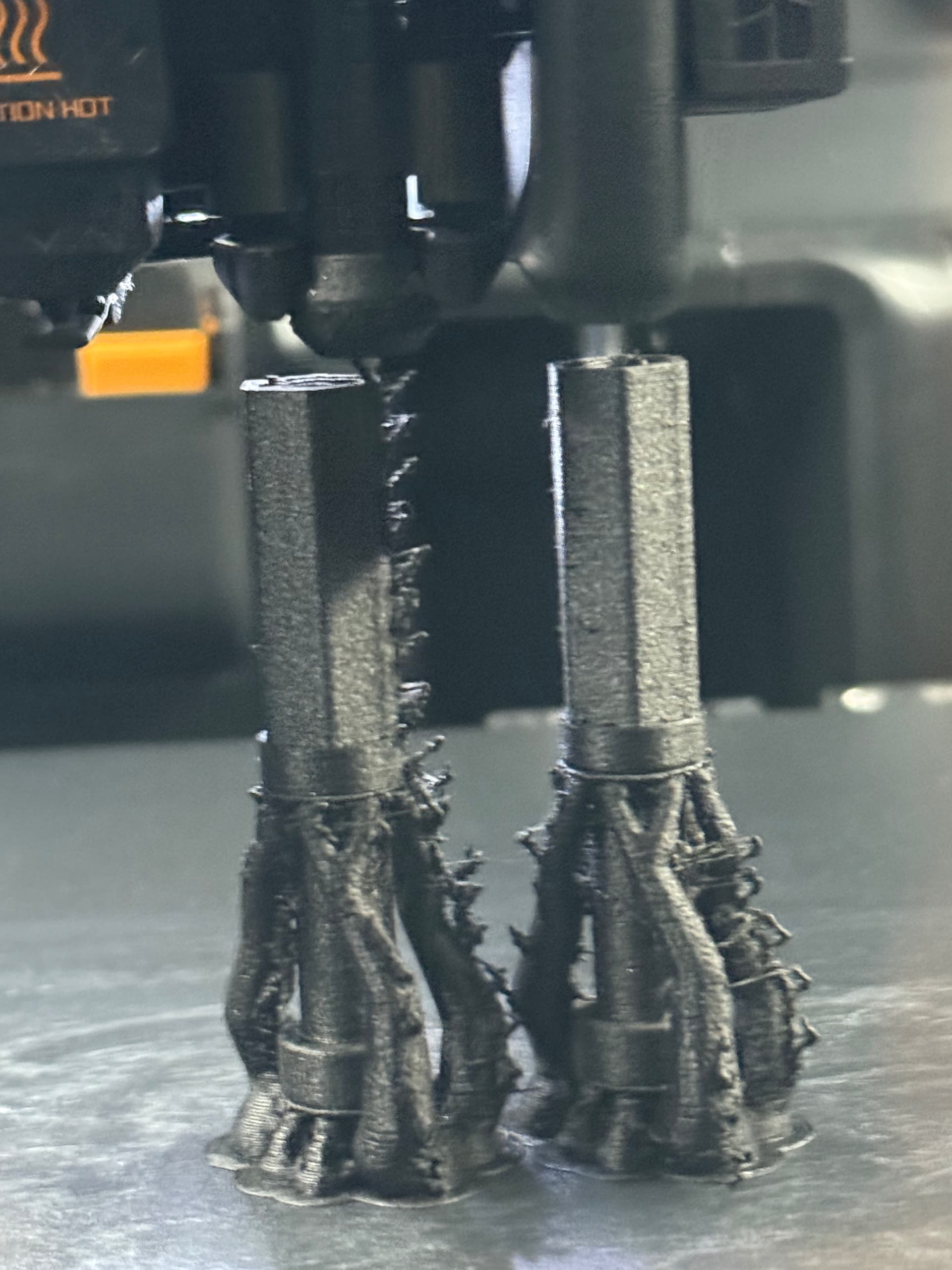

Ok so Im printing two shafts for a thing and Im using bambu labs pa6-cf on an H2C. I came to check on it and saw these strange spikes forming on only certain sections of the print (All where the head moves between the shafts) Now its not wet as I dried it at 85c for about 3 and half hours which isn’t a full dry but Ive done it many times before and Ive never seen this. Im wondering if it’s retraction related even though again Ive never had this issue before and I haven’t messed with my pa6-cf tune in a while. Anyone know what this is?
update: I solved the problem.. turns out Im an idiot and had the drier set to 55c instead of 85c so yeah it was soaking wet.
Your filament is wetter than…um.. nevermind, lets just stay at wet.
wet IMO
Send it back to the dryer.
