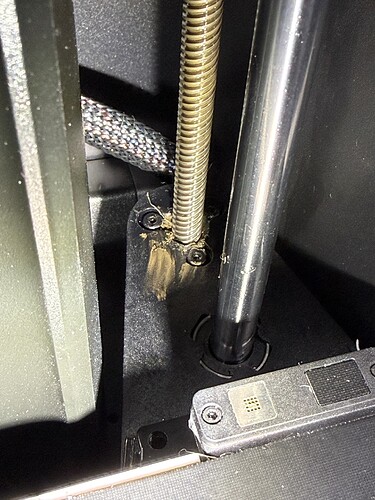

Here is all the info, Printer has roughly 2500 hours, greased every week as part of the farm maintenance, grease was metallic free every cleaning till the guide nut failed. There was no early warning signs, no particles no wobble. After failing the grease is filled with brass particles. Looks like it was ground away as the particle’s are very fine and only notable on a white paper towel with a flashlight however the grease is currently copper tinted so its a dead giveaway. Not sure what else to include. The other 2 leadscrews grease is clean.
I have wiped the bulk of the grease off the leadscrew and lowered the bed for pictures. Its been suggested on Reddit that some of the earlier printers may have defective leadscrews with poor machining such as a burr but I cant feel anything with my fingers. Granted that’s not very scientific. Here are the pictures to go along with my video I had posted.

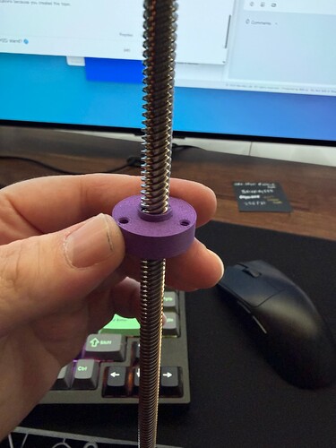

Its funny that someone made this! Printing now for a band aid fix. Ironically I was saying how reliable my P1S printers are in my farm then last night one mid print decided to fully raise the plate and slam the nozzle into the build plate and dig a hole. Bent the nozzle, killed the plate. Joy.

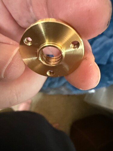

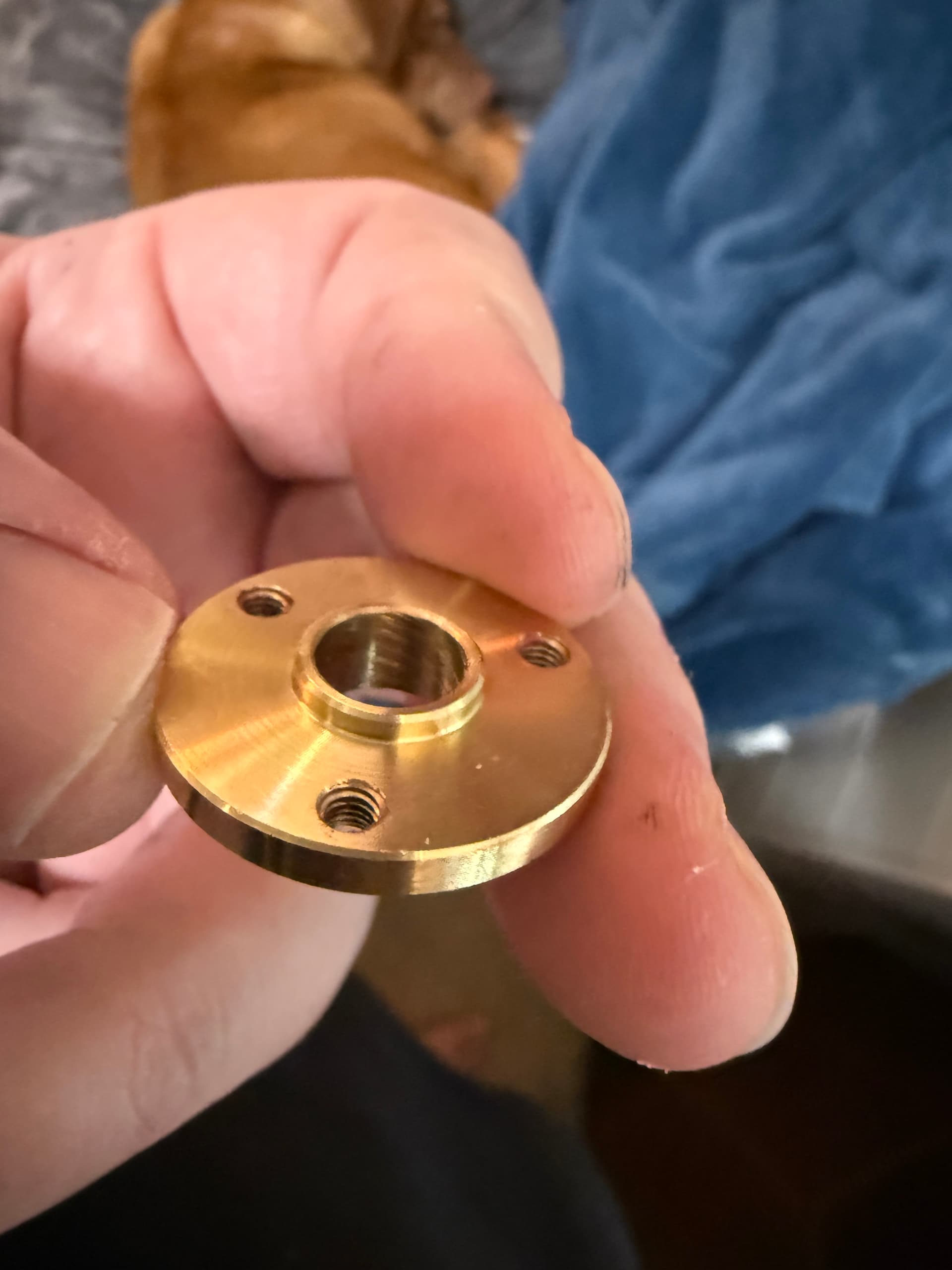

I made a discovery! On the one inner side of the nut the threads are stripped completely and it is smoothed, on the other some threads still remain. This was not evenly wearing.
Edit: The wear side was in the rear of the printer.

Printed the replacement part. Fits like a glove! Very smooth :slight_smile: So… how long will this last? rofl

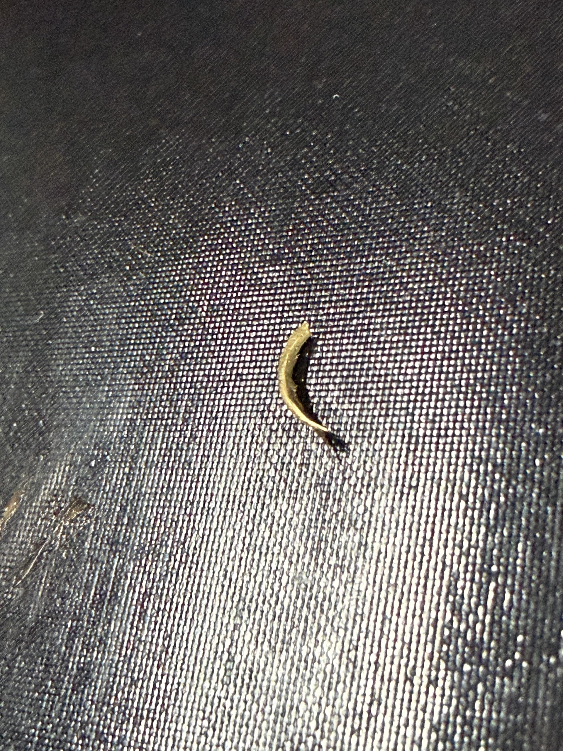

Wow that nut is completely reamed out. And within one week, it went from fresh grease and no signs of glitter to completely consumed. The big chunk makes me think the threads broke off mostly in one go, and then it ground itself down or something. I wonder what happened.
Honestly, the grease didn’t look funny at all even right before I started that print! There is a oddity tho. When I put on that printed part it moves smooth like butter up and down but there’s a spot that it flutters and the rod has a vibration as it passes over the spot with speed. Perhaps a slight bend in the rod or poor machining.
