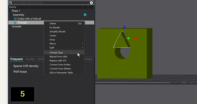

The short answer is that this is best done in CAD by creating a triangle at the top of the hole where one expcts there to be droop. This is by far not perfect but it is one of the best-practices items you’ll find in tutorials on “How to design for 3D printing”.
Now having said that, one can do this to a small albeit clumsy degree in the slicer using negative shape modifiers and adding the triangles that way.
I will create an “extremely exaggerated” example for illustration purposes. Normally the height of the triangle would be less than 10% of the radius of the hole diameter but this will illustrate how one would do this in the slicer. As stated, best practices dictate doing this in CAD.
Steps:

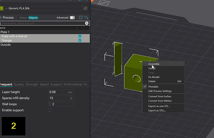

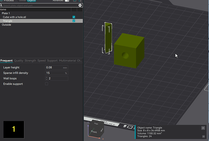

  1. Create a triangle that is the width of the hole but where the tip protrudes 10% of the radius of the hole.(Exaggerated in this photo.
  2. Select both objects to create an assembly. This will allow you to suspend the triangle object in mid air.
  3. Move it into place

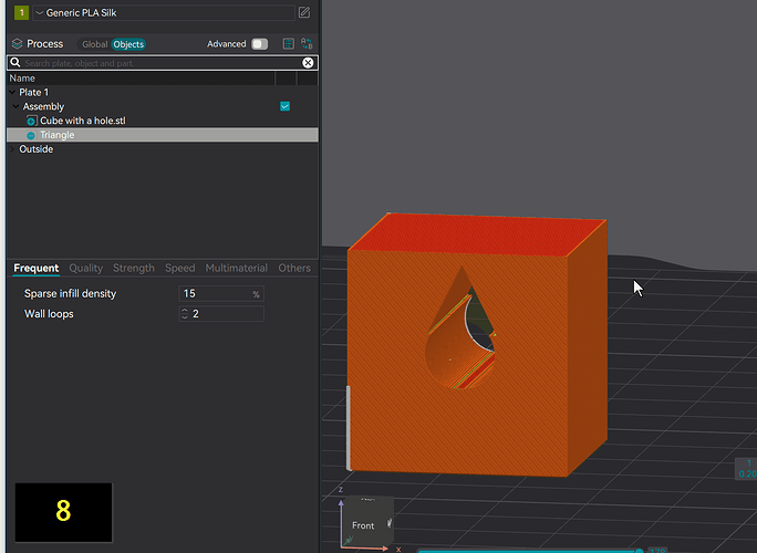

  4. Right click on the triangle or select it from the objects menu.
  5. Right Click and change the object type to negative which will act as a knife in the part.
  6. slice the model.
