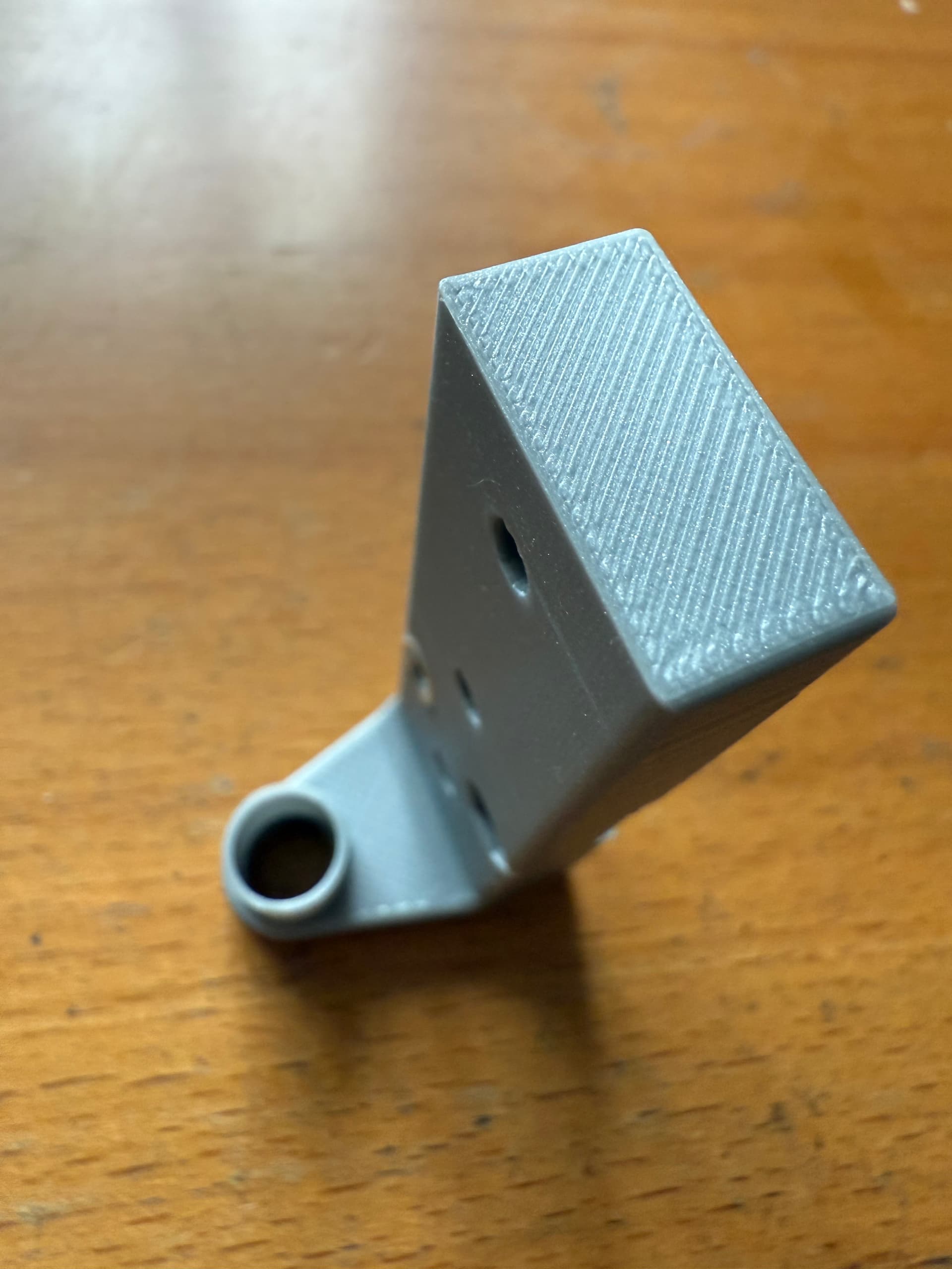

Hello,

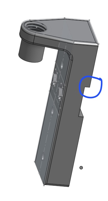

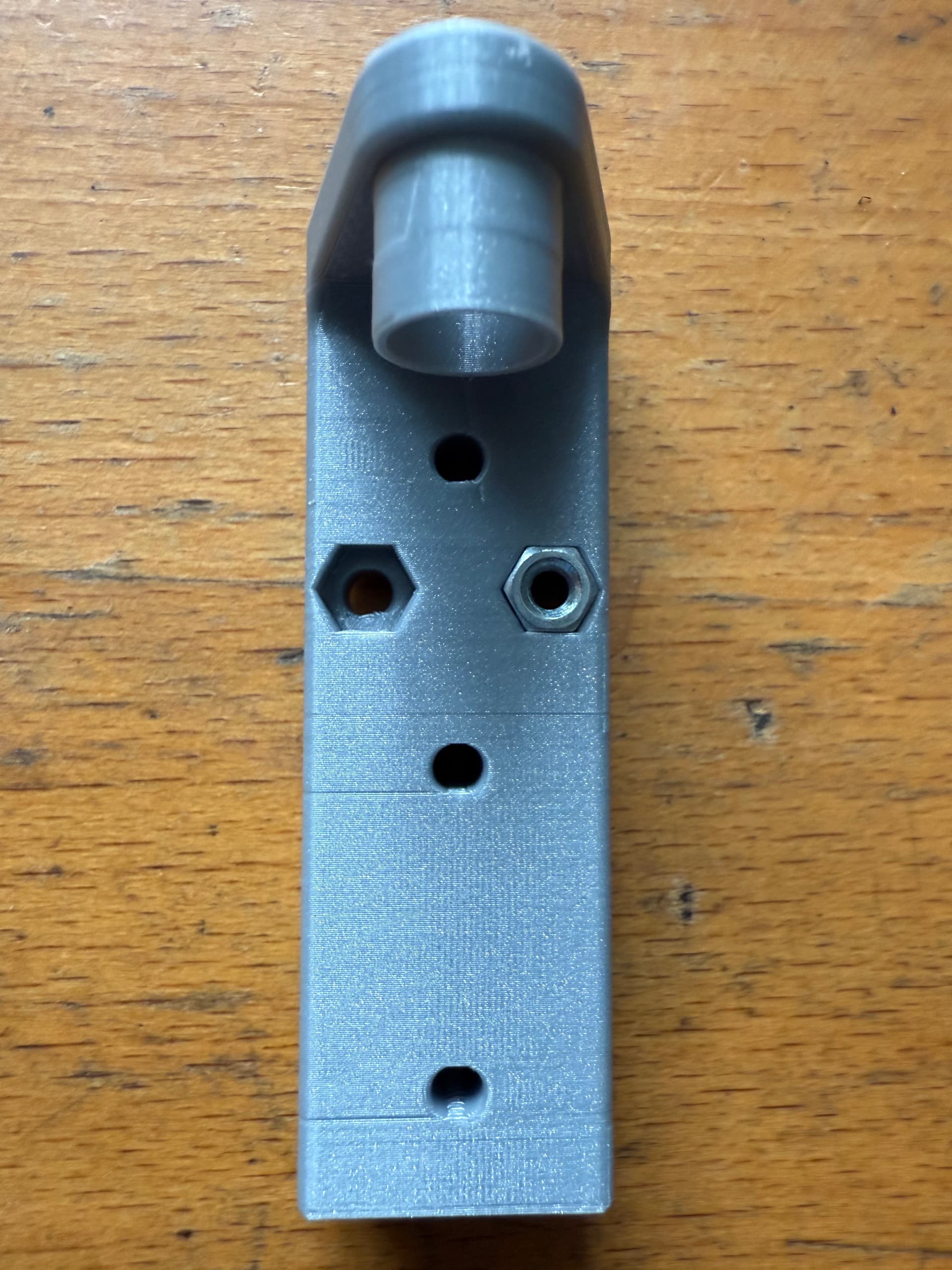

I printed the part shown in the screenshot, which measures 63 mm in length, upside down.
The 3.2 mm holes did not turn out round, but rather oval.
And the 2 mm overhang did not turn out very clean either.
How could I have prevented this?

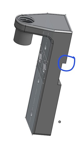

You didn’t provide a screenshot of the back rectangular recess.
I suspect lack of support or the wring type is the cause.
The holes not being round are partially due to how FDM printers print. The balance is how or if it utilised support material.
You do not start you print orientation, but I guess it was short edge on the base plate.
A screenshot showing the preview in summary view displaying your model and support would help us, help you.
If you want to optimize holes. I’ll offer this. It only addresses the roun hole portion of your challenge. For the nut, I generally use the X/Y compensation and an x-acto knife to drip errant burrs.

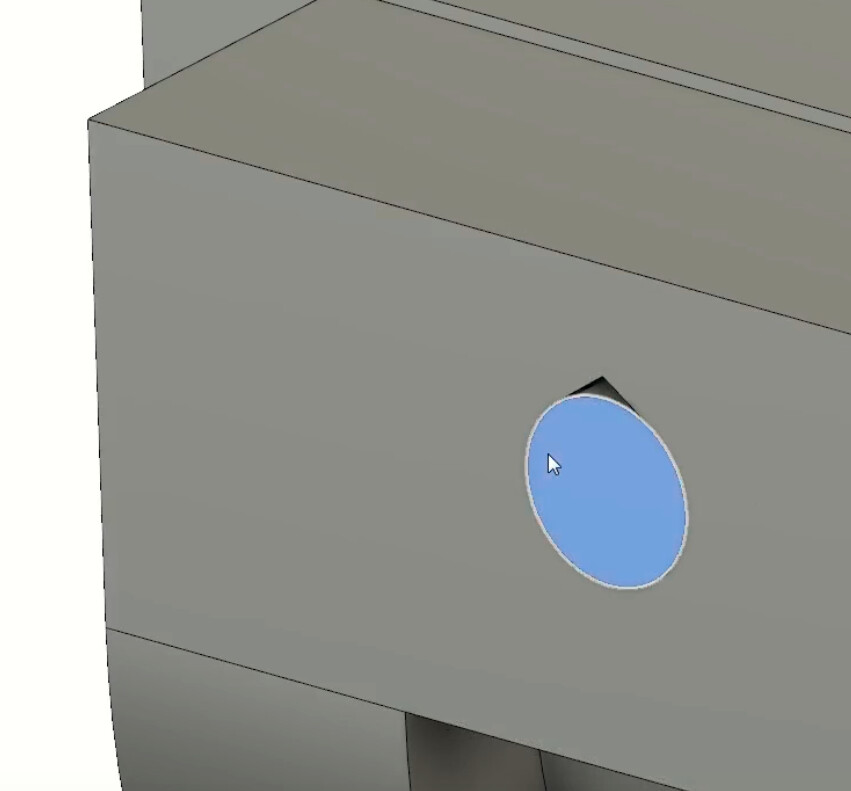

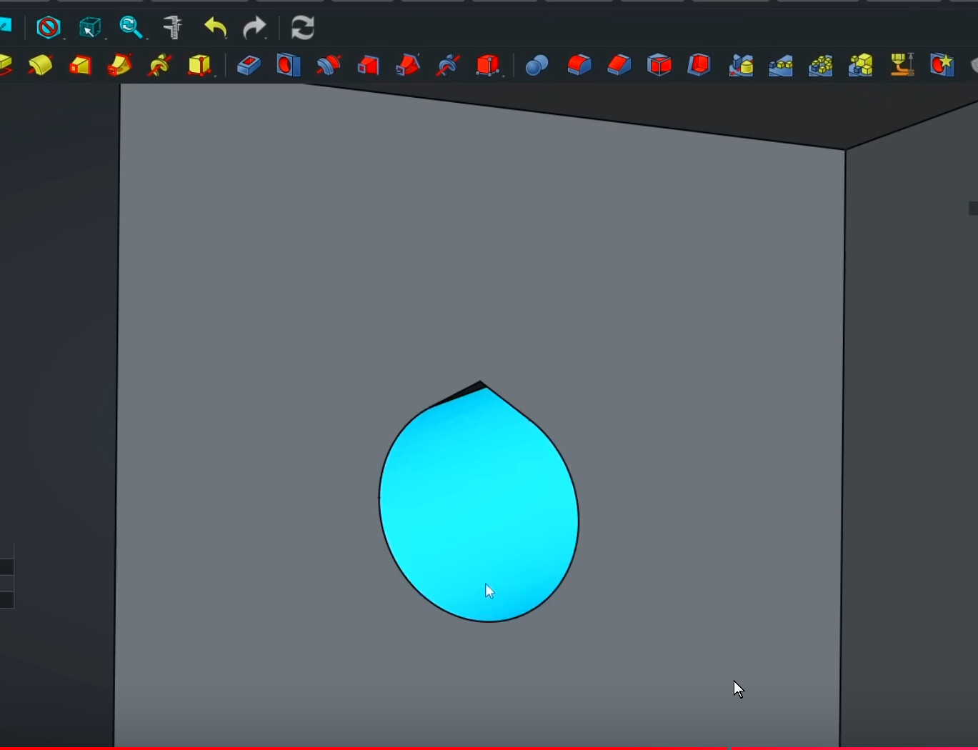

Is this your design? I ask because if it is, then you want to go back in and create a teardrop rather than a proper circle for those holes that will be printed horizontally(hole diameter is in the z-axis).
This will give you a shape where the tear drop will compensate for the droop.
Here is one tutorial where that screenshot was taken from. https://www.youtube.com/watch?v=j6508J94VsA

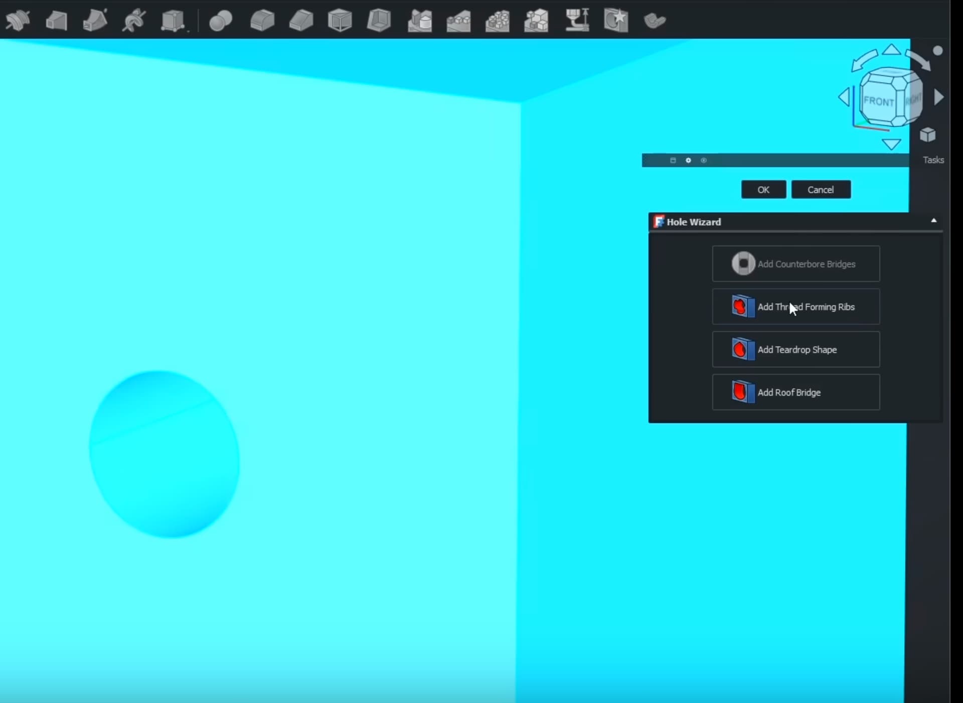

Here is another tutorial using FreeCad with a teardrop plug in. It’s much more technical but if you want something that is single click, this is how to do it: https://youtu.be/Z8zmoXBMvyA?t=562 Advance to section 3, time index 9:20

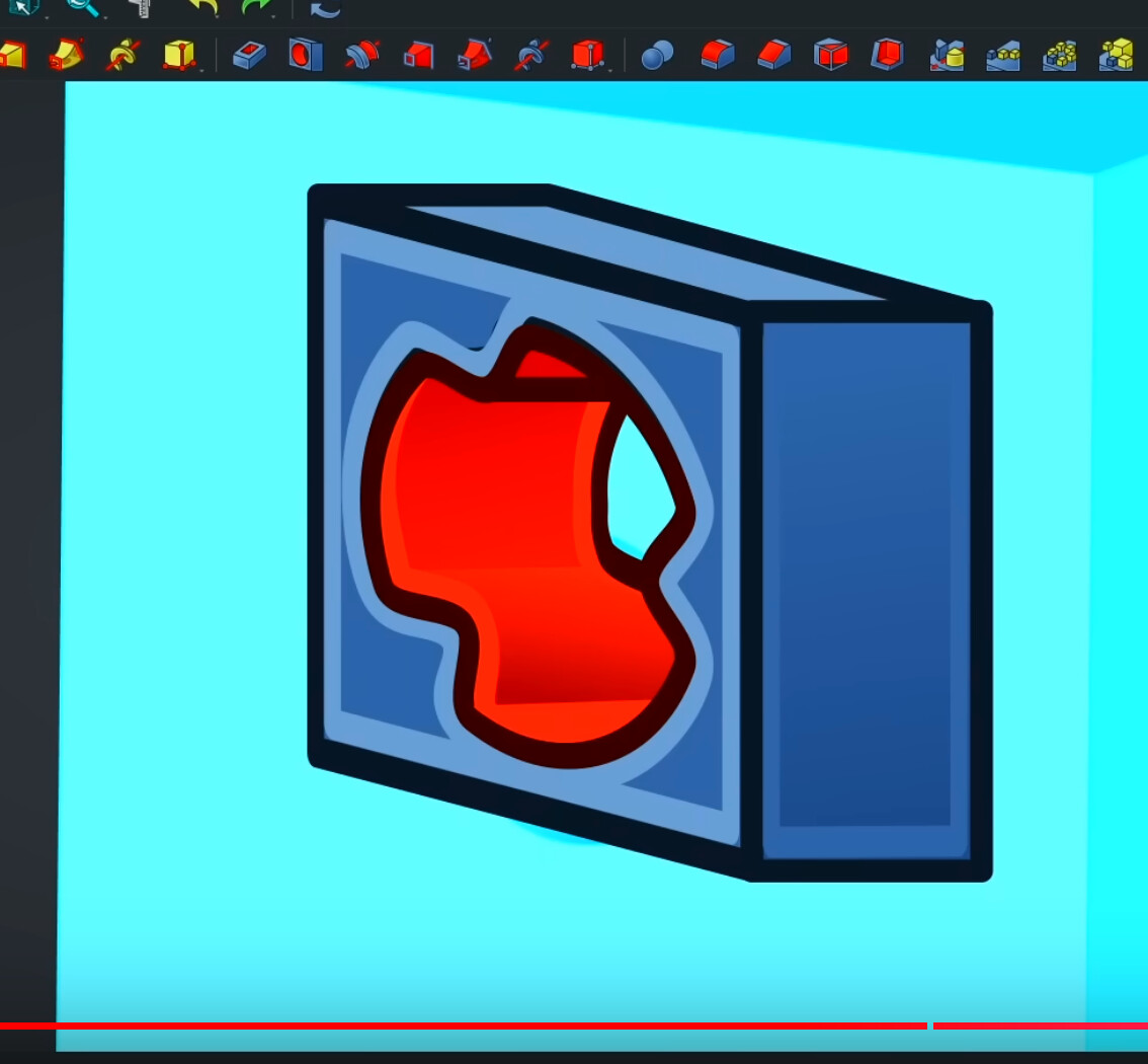

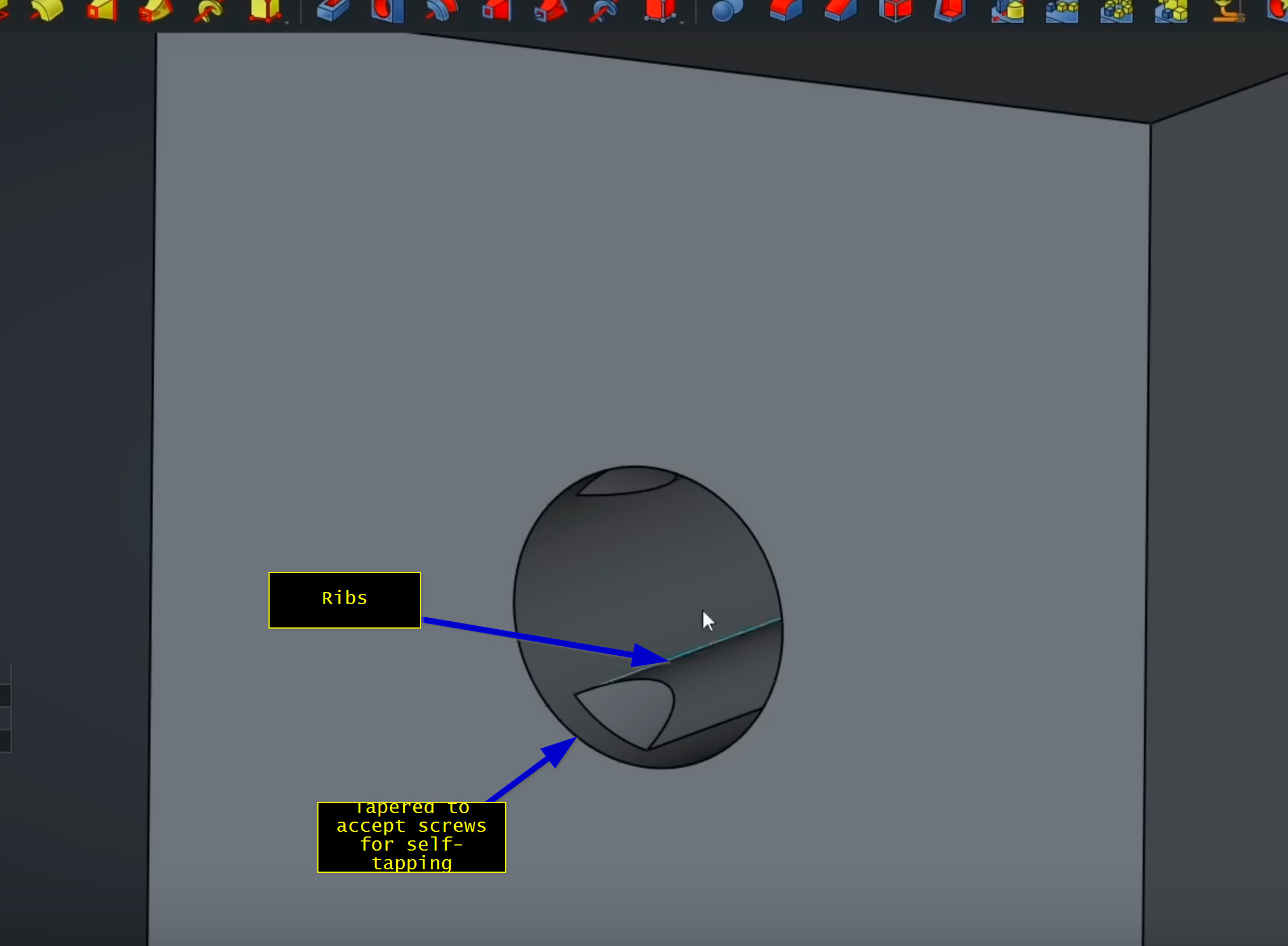

Alternatively, I came across another trick very recently that I’ve been itching to try out. You can skip the precise-hole diameter entirely and use thread forming ribs. Ribs are where you provide interior notches for the threads to bite into. Again, the FreeCad tutorial above shows a tutorial for the addin at time index 11:00. It produces this kind of shape. Note: What they have done here is rely upon the self-tapping properties of any thread and use the ribs to create a grab-on area. Like I said, I have been looking to use this in one of my next projects.

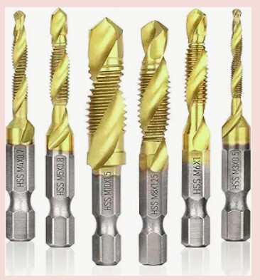

The easiest way which requires no CAD. Abandons the notion that perfect rount horizontal holes are possible
  1. Decrease the size of the hole using X/Y compensation to some 0.1-0.05mm dimension. The close is to make the hole just small enough to fit a drill bit.
  2. Increase the number of wall layers using the modifier so you don’t increase all walls and waste filament. Or if you don’t mind wasting filament, just increase the layer density in that area buy switching to a modifier with higher density infill. The goals is to have more solid plastic around the hole.
  3. Then simply take the correct size drill bit for that hole and cut the hole with a drill.
This last technique is one I find myself using most often because:
  1. It’s easier.
  2. There is doing it right and then there is doing it right-now and as the Chinese would say “Chabuduo” (差不多)
Here is a drill-tap combo search from Amazon. I found these to be perfect for this type of application because it does both the cutting and tapping a thread.
https://www.amazon.com/s?k=Drill+Tap+Bit+Set+metric&i=industrial
One cautionary thing if you haven’t cut plastic before. You must use the lowest possible speed and back off periodically as you drill to give the tool and the plastic time to cool. PLA in particular is very susceptible to melting. You’ll figure it out what works best but practice on some test pieces to get the feel. I use a Dremel at lowest speed possible but for the drill tap, they only fit in a drill so I also use a 1/4" driver handle too. Here’s two example that are perfect. they is still powered but low speed and they allow for one to start the cutting manually at first then use the motor once you have cut into the plastic:

Basically any spot on your model that is going to be printed overhung between 60-90 degrees is likely going to have some gravity applied to it. Tops of holes are habitual offenders, so that teardrop is a well known trick.
If you use supports, the amount of “gravity” that can be in total applied to deform your holes is constrained to the Z gap, and you can use that frame of reference to think about what “tolerances” to add.

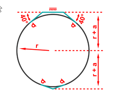

Besides problems cause by overhang “droop”, matters are also complicated by creating arcs with flat layers, and rounding errors caused when the hole edges and center do not line up with multiples of layer height.
I’ve seen this recommendation several times to deal with those issues:
(r is the radius of the hole and a is the layer height)
In order to print horizontal holes with a better tolerance, it is recommended to model the additional features in the image where the offset distance a, is the layer height of your print. If you are using a small layer height like 100μm you should do 2*a. This will accommodate for any drooping that will occur in the steep overhang sections of printed horizontal holes and the “flattening” of the bottom of holes due to the stacked layer process.
That can be a bit complicated to create for multiple holes, but a parametric CAD program like Fusion or Onshape simplifies the task. Create the sketch and save for future use as a template, using named parameters for the dimensions and calculations. Then simply changing diameter and layer height will scale the sketch for copy/paste into any design. Conditional parameters will even adjust automatically for small layer heights.
