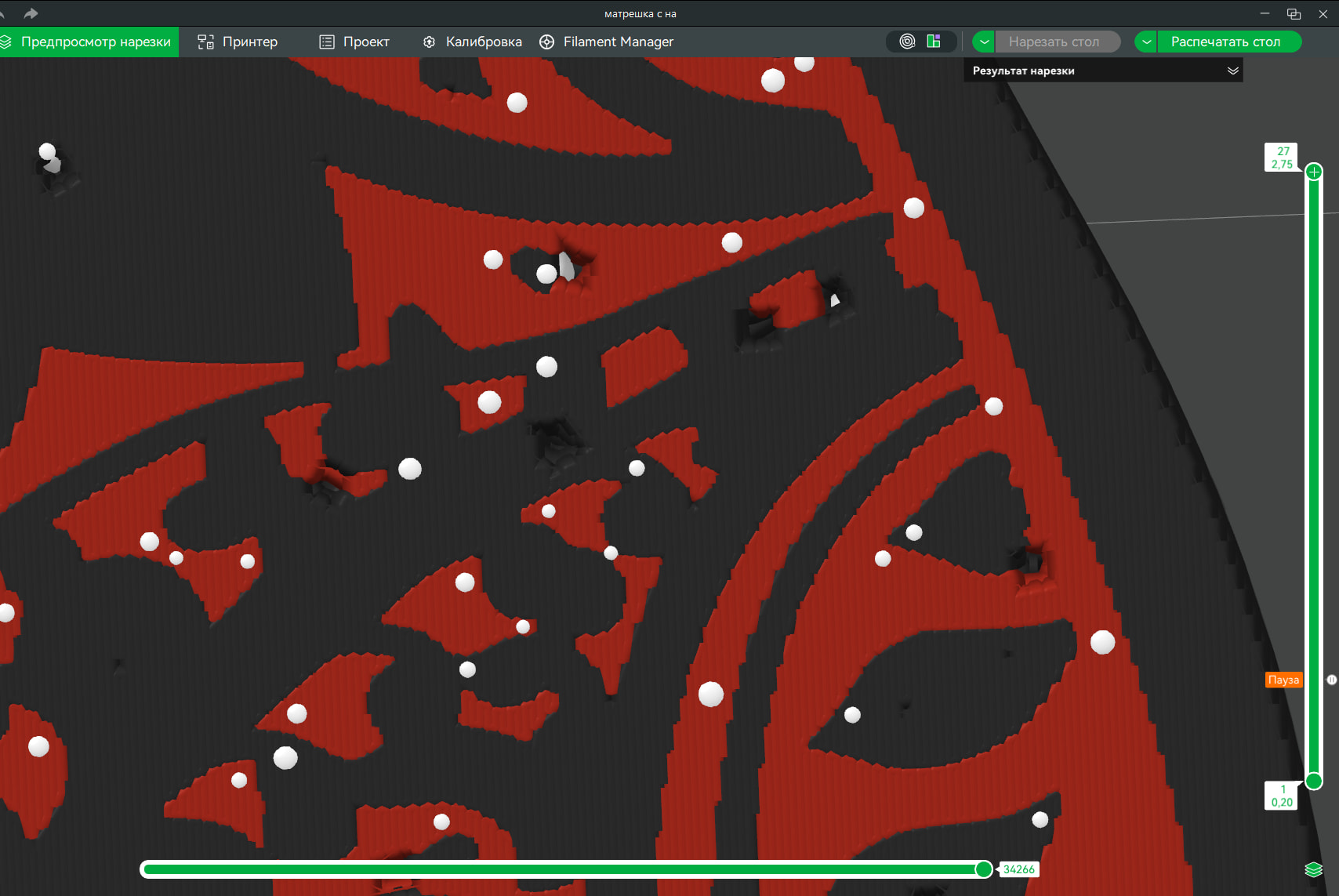

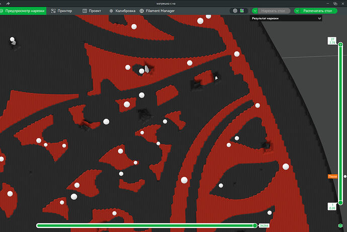

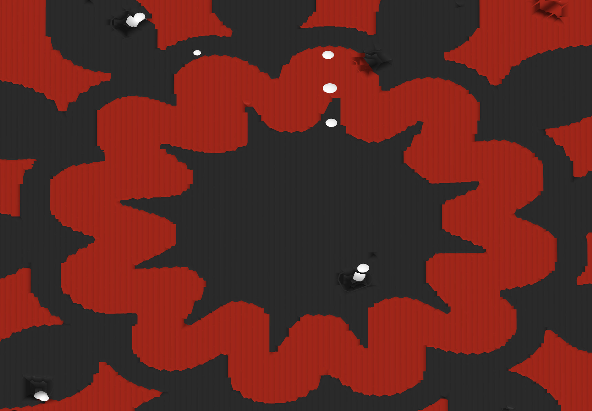

Hello! I am slicing a flat keychain model with a lot of complex multi-color patterns using a 0.4mm nozzle in Bambu Studio.As you can see in the slicer preview, there are empty gaps (holes) between the colors on the TOP LAYER. I already enabled the Arachne wall generator, set the minimum wall width to 45%, and changed the top surface pattern to Monotonic, but these slicing gaps won’t go away on the top surface.What setting should I change to force the slicer to fill these narrow spaces completely on the top layer? Thank you!

Have you actually tried printing the part to see how it comes out?
The onscreen preview is just a representation of where the toolhead moves, and is not indicative of flow at those locations, which is the whole purpose of arachne - vary the flow to better fill irregular areas.
You really need to try it to find out.
Failing that, you can change the top surface infill pattern, that will hit all the geometry differently and may not leave the same gaps, and if all else fails there’s always 0.2mm nozzles…

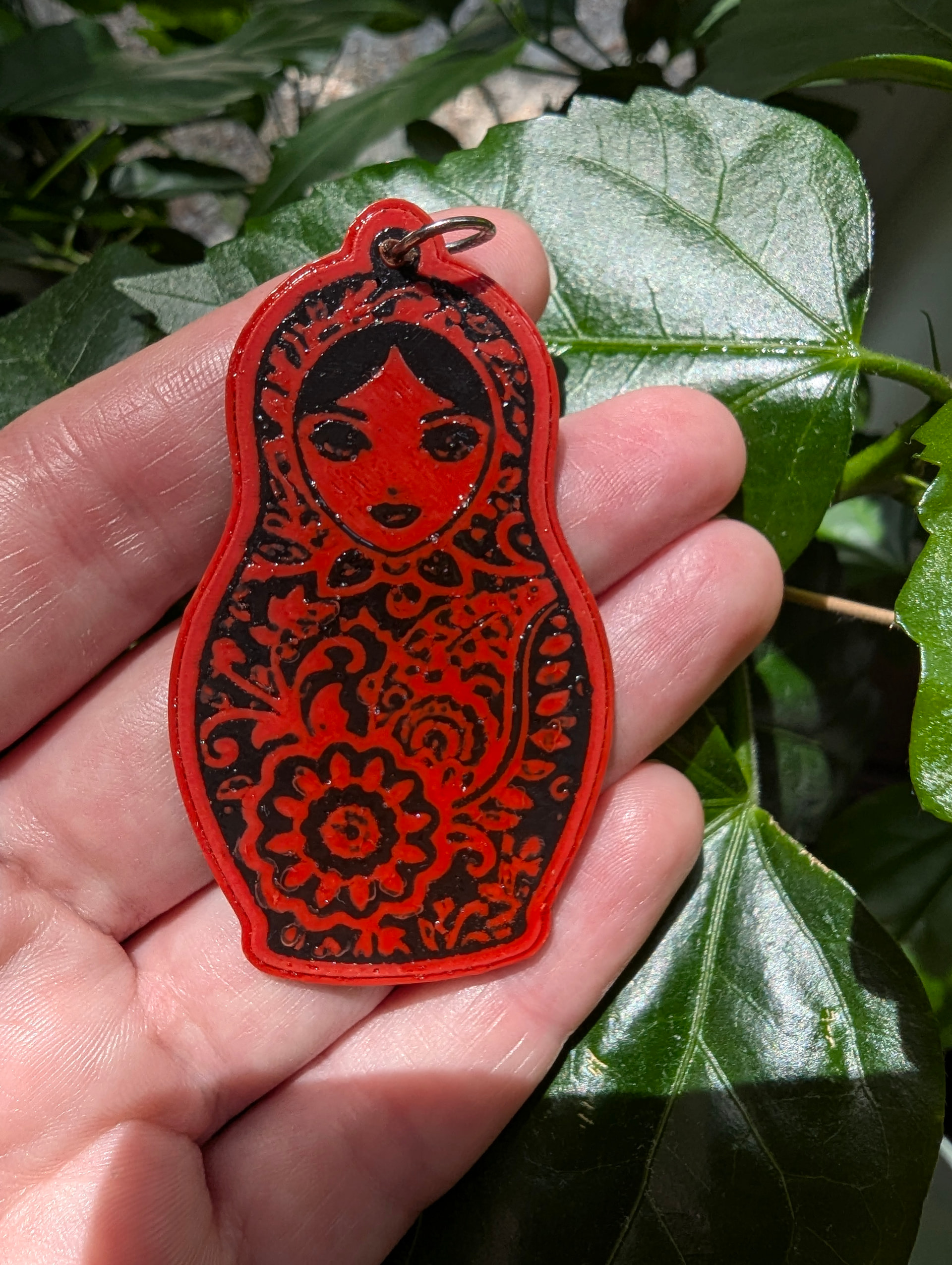

I tried printing the model, but it was full of holes.
Pictures please!
White_Pixel_1x1

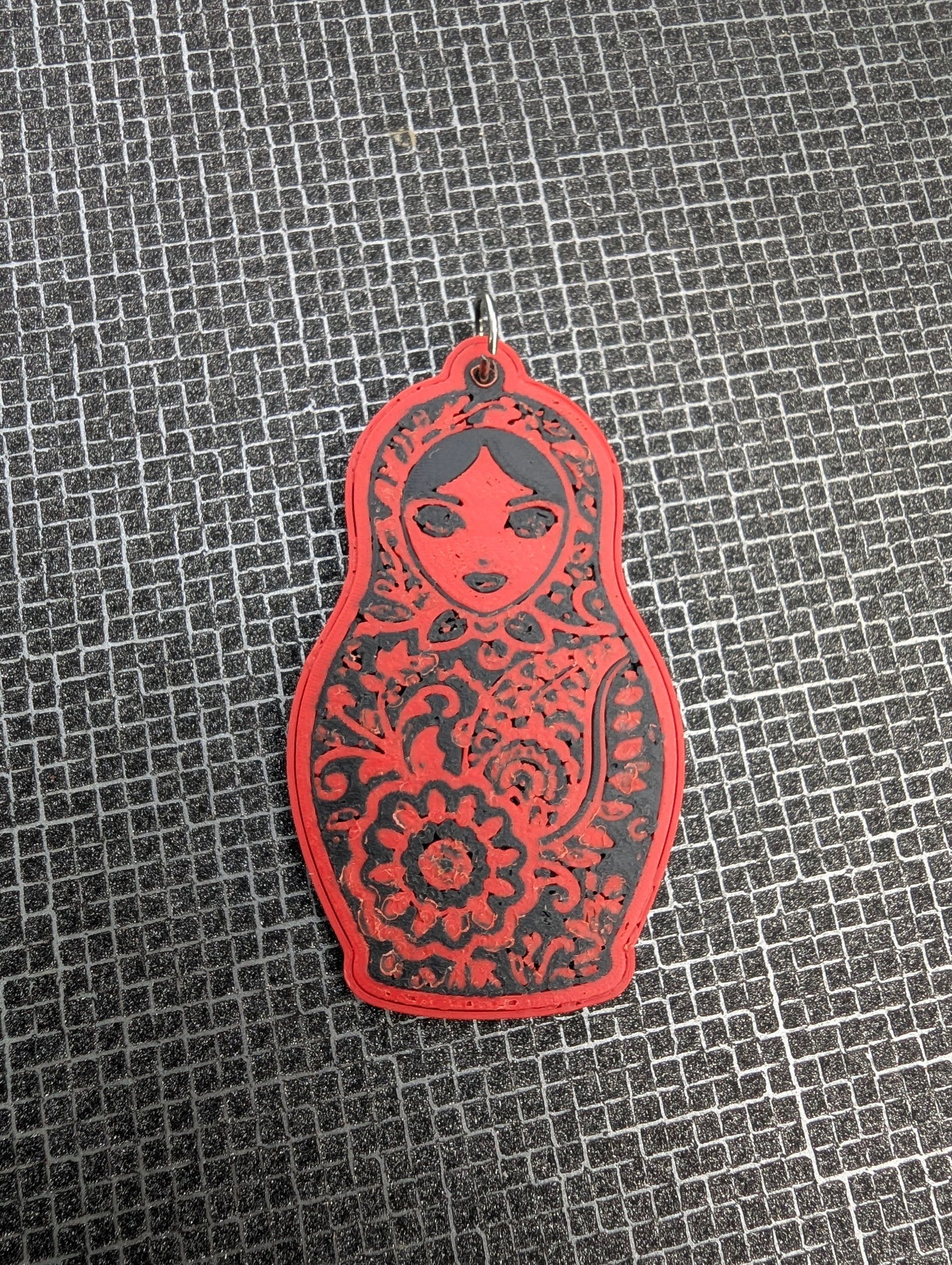

The first one is printed as-is; the second photo shows three coats of varnish.
Are you only printing a single color layer over a white core or something? I’m trying to understand why there’s white coming through in those gaps.
How new is your hotend? Have you tried doing a good cold pull to see if there’s any junk in there?
No, there are actually only two colors; they are matte, which is likely why it looks like there’s white—but the white you see when cutting is just the seam. However, aside from the seam, there are also holes.

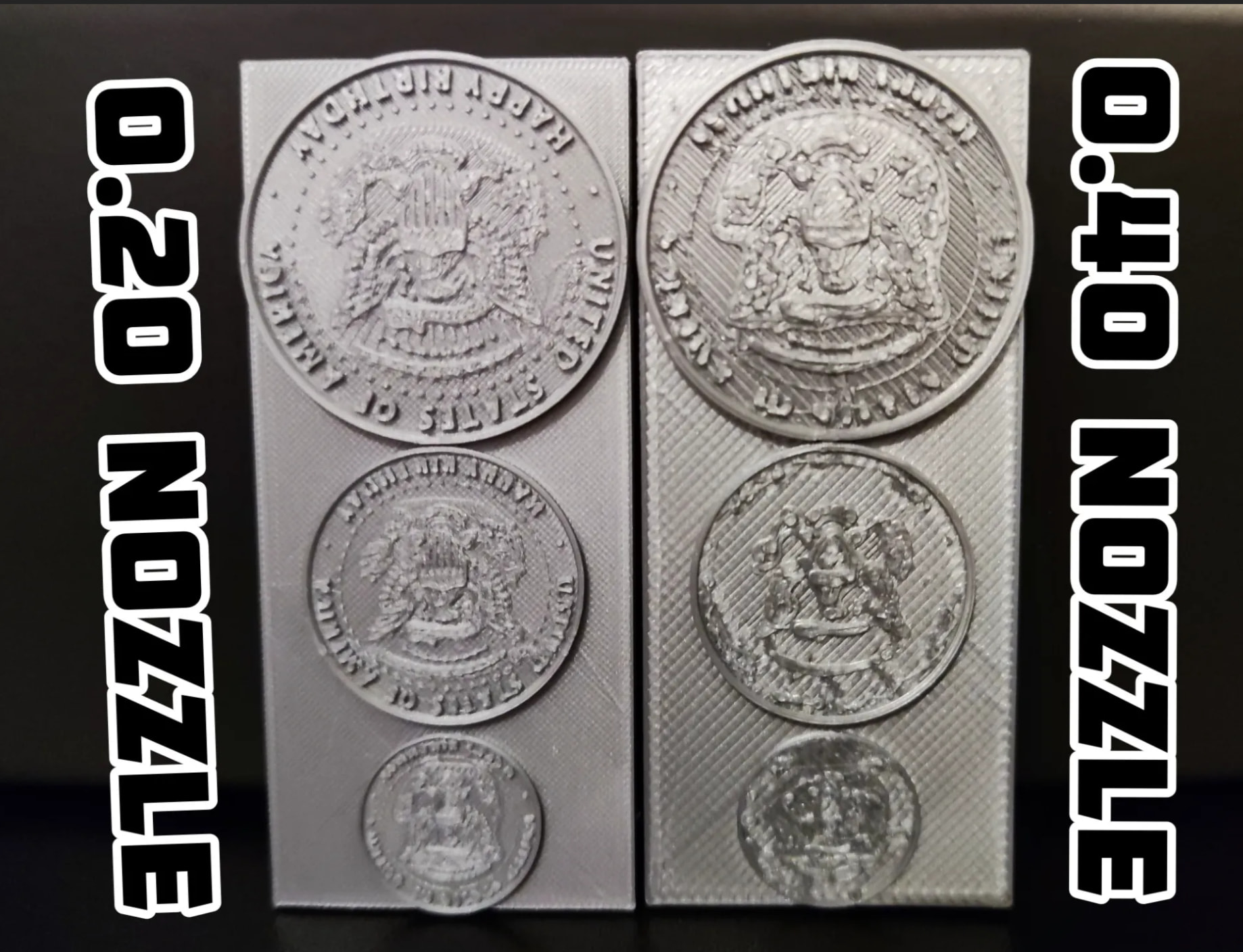

I actually did a comparison test specifically for cases like this - the 0.4 nozzle simply reaches its limits:

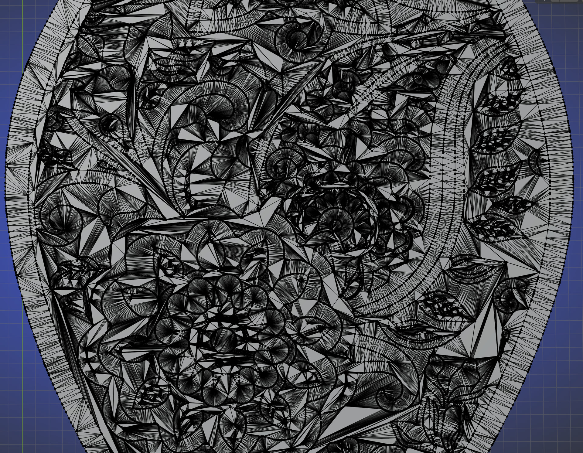

I’m almost certain it’s a modelling issue. Probably has so many intricate details and geometries that the slicer doesn’t know what to do with it. This is what it looks like in Blender:
Your object has 330,000 geometric details (to put it simply). For comparison, a keychain usually has fewer than 100,000. Your object is even making my high-performance computer struggle.

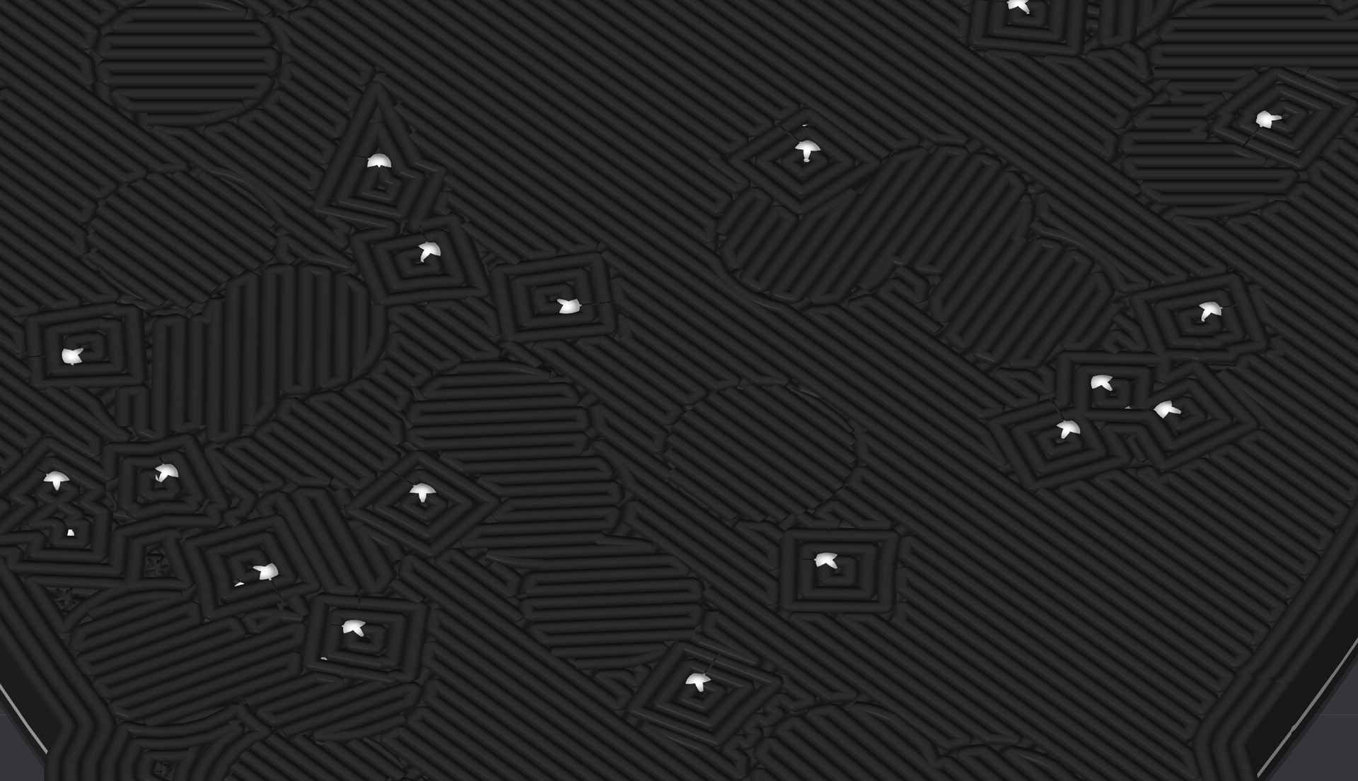

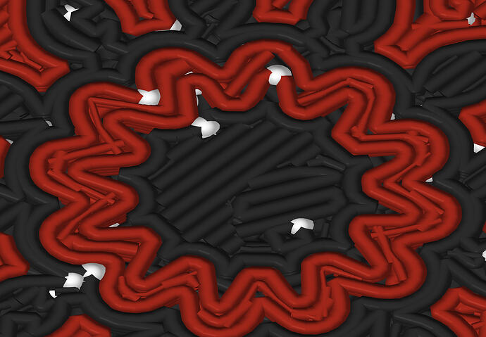

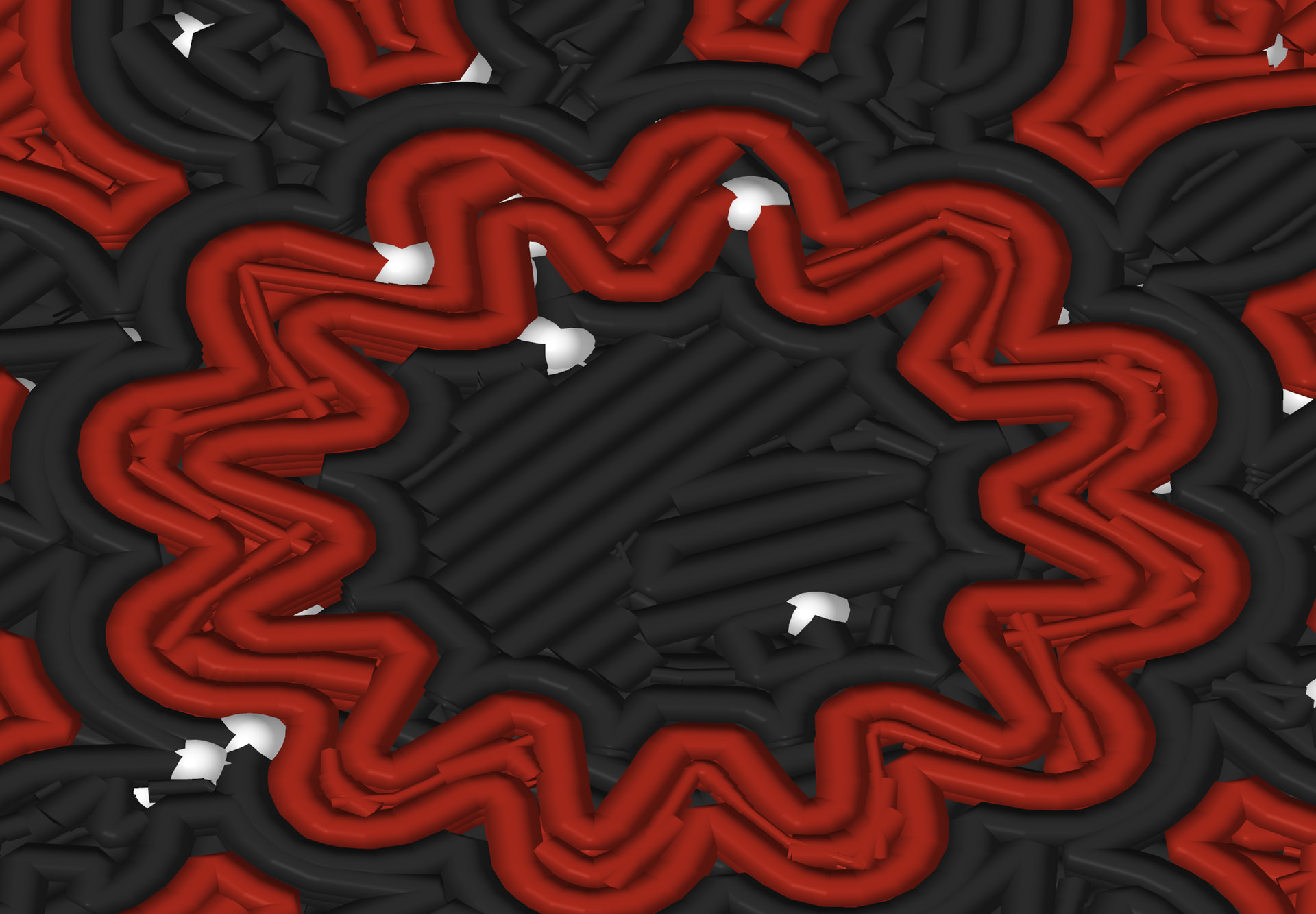

First of all, I reset your profile and saw what had happened. It’s much better now:
Bevor:
After: All the holes are gone.
And now I’ve found the setting that’s causing the problem: Ironing. Turn it on and the holes appear; turn it off and they’re gone.
And now we come to the crucial question: why is that the case? This takes us back to point one: the object’s geometry is completely strange. Take a look inside the object - it’s not solid, but made up of all these strange shapes. As you can see from this cross-section, they crisscross in all directions.
There’s a lot of information here, and now you’re probably wondering: What now? Well, something in your workflow for creating the object isn’t working. This has nothing to do with the settings in Bambu Studio; your object is simply defective.
You’ll have to go back much further to fix the problem: How you created the object.

Although already nicely resolved by @RetroSharky , I’d just like to add that surface holes are more prominent with “Monotonic” than with “Monotonic line” due to the path logic (90° for Monotonic, parallel to wall for Monotonic line) when changing direction.
“Circumferential” leaves the fewest holes, but those may quite large due to sharp corners in the tool paths.
