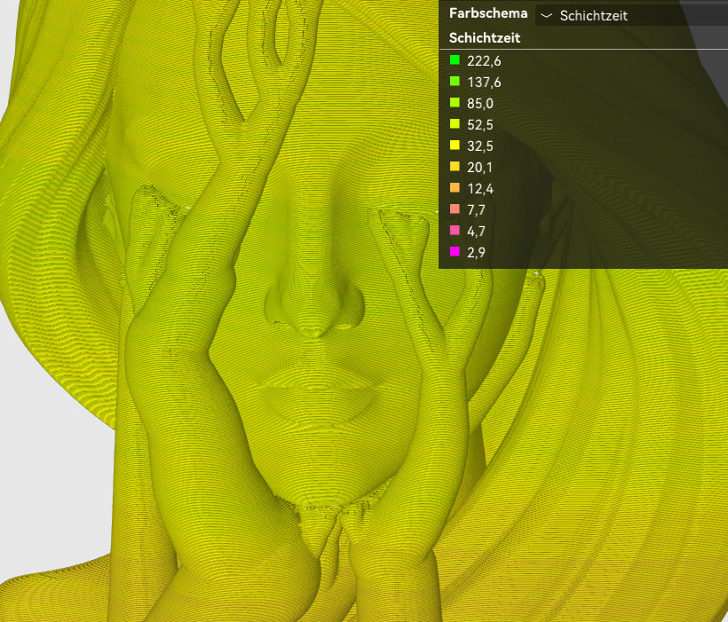

Hi everyone,
I’m hoping someone in the community can help me solve a persistent print-quality issue that I have been unable to eliminate despite extensive testing.

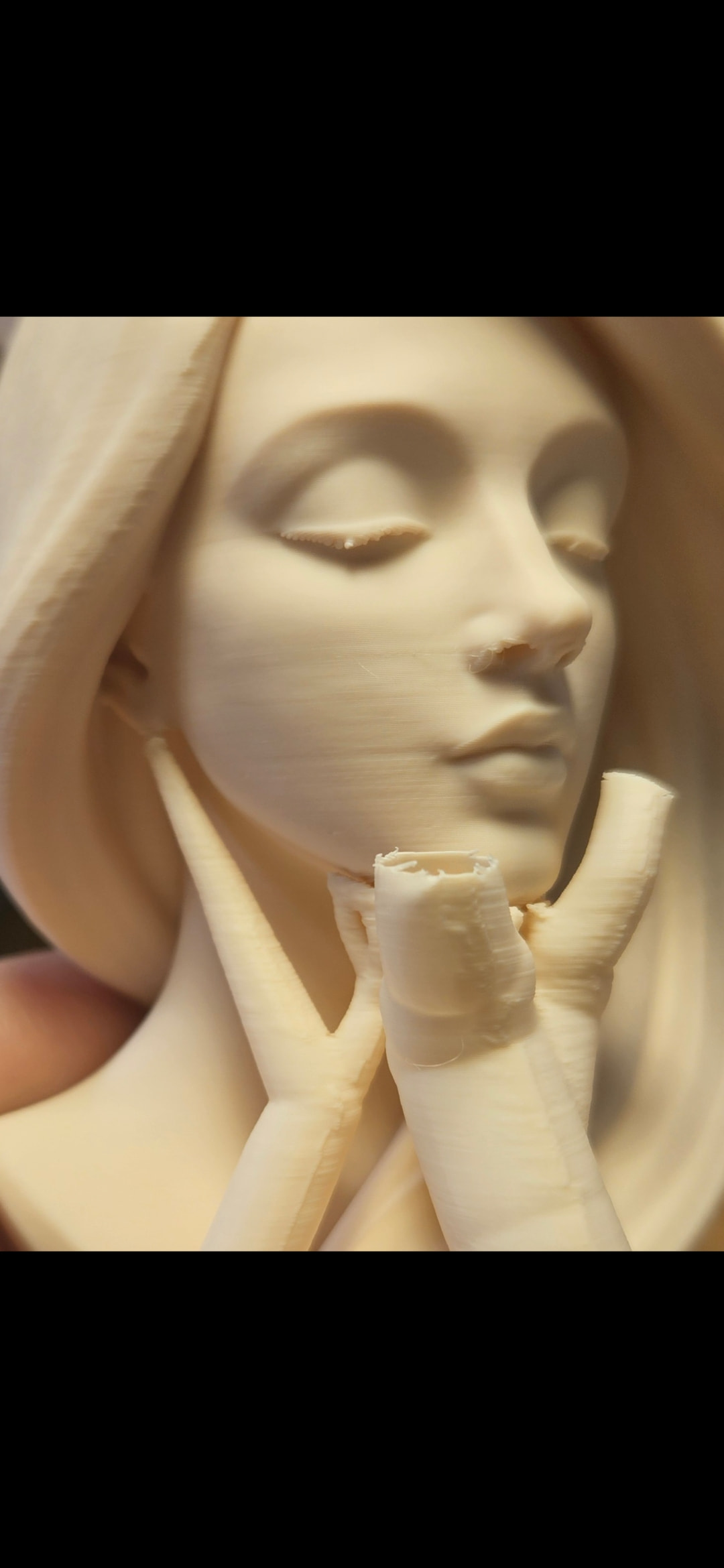

I print AI-generated figures approximately 150 mm tall using two separate Bambu Lab P2S printers. On nearly every figure, a very sharp horizontal line appears on the outer surface at approximately the height of the corner of the mouth or the bottom of the nose. This seems to be the point at which the model’s cross-sectional geometry changes significantly because of the lips, mouth and nose.
The line is not simply a change in gloss. It appears to be a visible physical surface irregularity that catches the light.
Here is everything I have already tested:
  1. Testing on two separate Bambu Lab P2S printers
    The same issue occurs on two independent P2S printers at the corresponding height of each model. The Z-axis lead screws on both printers have been cleaned and freshly lubricated.
    The position of the line also scales with the model: it appears higher when the figure is enlarged and lower when the figure is reduced. For this reason, a mechanical Z-axis issue or fixed-height lead-screw defect seems very unlikely.

    If I use the cutting tool and print only the head or face, without the neck and body underneath it, the cheeks, mouth and lips print perfectly smooth. However, when I print the complete figure from the base upward, the horizontal line returns.

Can you color code by layer time? I wonder if that section is taking longer to print so cools and shrinks more?
Not sure how to compensate on this kind of model. On boxy things adding chamfers can help to reduce step changes in layer time but no idea on curvy stuff.
If it is a layer time / cooling issue, maybe a warmer printing chamber?
Thank you for your suggestion! I already checked the model in the Layer Time preview in Bambu Studio. After setting all relevant speeds to a constant 60 mm/s, the entire model is displayed in a uniform yellow color, including the affected area around the mouth and nose. There is no visible jump in layer time at the exact height of the line.
I have attached a close-up screenshot of the Layer Time preview for reference. A warmer chamber might still be worth testing, although it remains strange that the isolated head prints perfectly smoothly while the exact same area develops the line when the complete figure is printed.
For the isolated head, the oddness will be sooner in the print and closer to the build plate for whatever influence that may have.
On the full figure it would print much later. I’m not sure what part of that is triggering the line though.
Maybe others will chime in? There’s a number of threads here though about those kinds of surface anomalies but generally with boxes where chamfers can help. But they do talk about chamber temps, bed temps, and such too.
