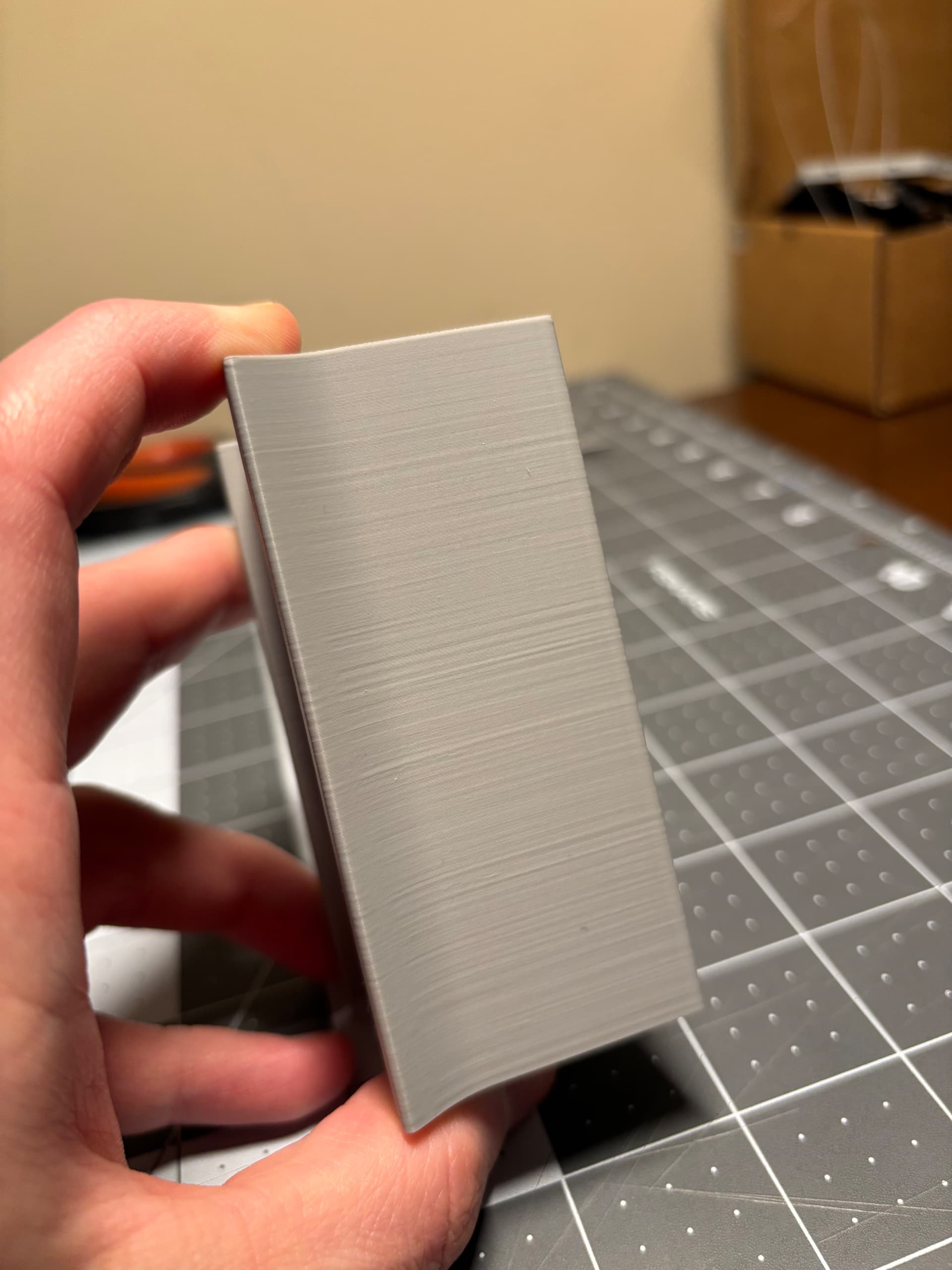

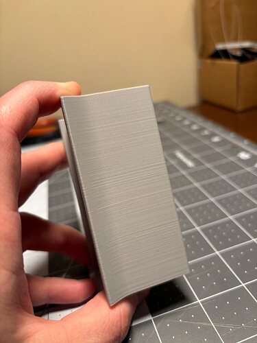

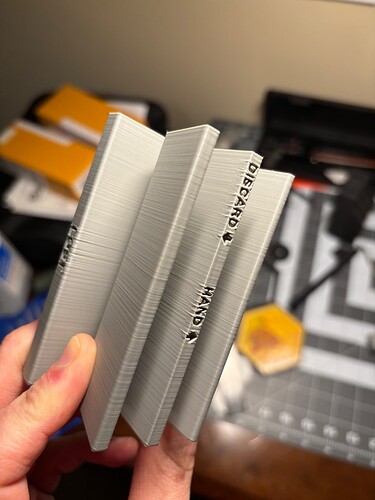

Horizontal lines (z banding?)
I got my p2s combo a few weeks ago and am noticing that all my prints on all filaments with any setting profile I’ve done has these horizontal lines.I’ve done several hours of research on this and have not seen ANY post similar to mine where the person figured out their issue. I’ve seen people spend dozens of hours trying different things with no luck and am very much dreading having to go through all of that.
I’ve been using all the standard settings and the 0.4 nozzle

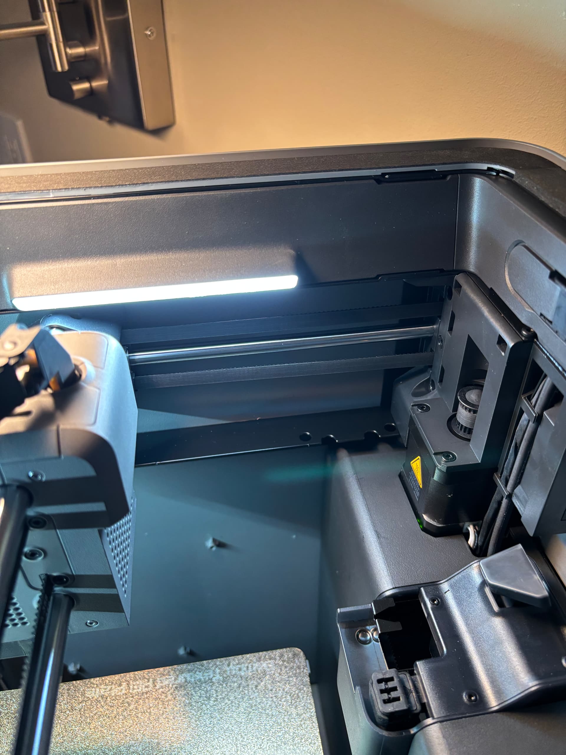

The one weird thing I noticed in my printer is that the belt on the left side seems angled a bit (in image)

Try printing slower, Outer wall max. 130
Everything over 200 is WAY to high except for gap fill.
But outer wall never above 130 (sweet spot between speed and nearly no VFA)
If not already done. calibrate PA (Flow Dynamic) (~ 0.018 on a P2S with Bambu PLA Basic)

Could easily be a Z axis issue. It doesn’t look like a XY issue. Layers are bulging out along the entire visible circumference of the layer. That’s either over-extrusion or too low a layer height for the correct extrusion. I’d do what the BBL tech suggested…
I was going to, but they sent a link that gave instructions for an older printer, not my P2S… also I’ve checked the Z rods, they are not loose at all. Do you have experience adjusting these things on your printer?
I know there are a lot of different settings I can use to help eliminate the issue. Slowing downs the print, adding walls, etc., does help, but the lines are still there. I’m still concerned that I have a mechanical issue, and don’t want to jump through hoops forever when I shouldn’t have to.

To me it looks like you have a flow problem and / or bad / wet filament.
Do a flow and K calibration and make sure your filament is dry and not too old.
