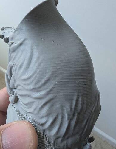

I’ve been noticing a decline in print quality on my X1C. Not enough to cause failed prints, but enough to have a visible impact on the surface quality. I’ve attached a couple pictures of the problem.
I’m using the stock printer profiles for 0.2 mm Standard and 0.08 mm High Quality respectively and a 0.4 mm hardened steel nozzle for these prints. My prints now have noticeable banding on them when they used to come out almost perfect regardless of what layer height or speed I print at. I’ve noticed that the pock marks and banding started appearing at the same time so I suspect they’re related.

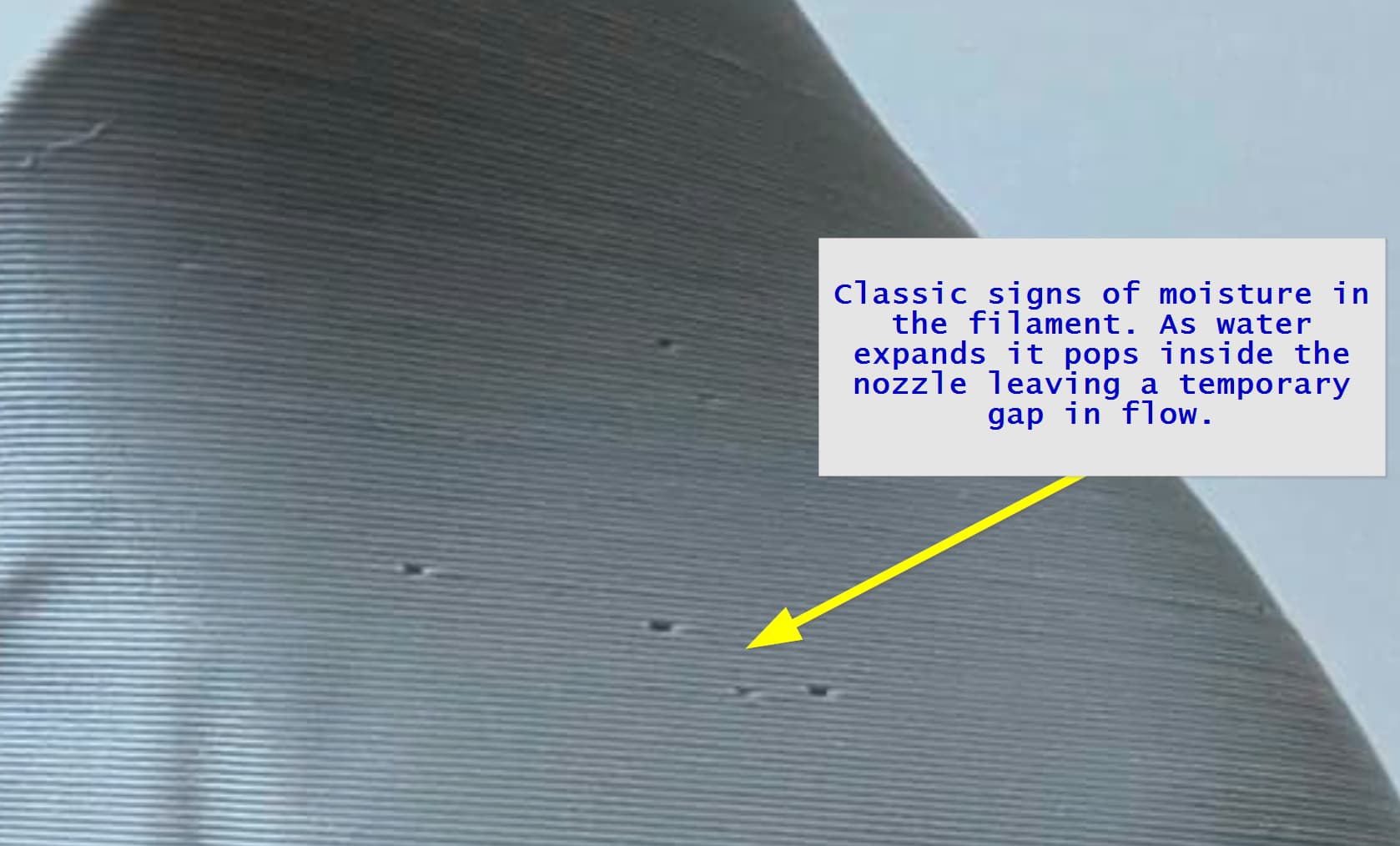

  1. You didn’t mention what kind of filament you’re using. Did you ensure it had no moisture?
    There’s only one way to rule out moisture: weigh it, dry it, weigh it again. If it lost weight, then moisture was part of the problem (though not necessarily all of it). Repeat the drying cycle until the filament stops losing weight. Note that cardboard spools can throw off this measurement, but even if the spool was the source, thorough drying will still rule out moisture.
Guess which one of these benchies came from wet filament? Click for closeup.

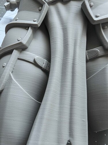

I’m back with more data. I’ve dried my PLA thoroughly and left it overnight in a sealed tub with a hygrometer to measure how wet it is. It took a few tries to get the time and temperature dialed in but I’ve got it down to 16% humidity which seems plenty dry. I put it in my AMS unit by itself with fresh desiccant and it’s reading 13% in there, dry as a bone.
While it did improve the bubbling issue, I’m still seeing the same amount of horizontal streaks in the print. The lighting here is exaggerating the streaks but it is still a very noticeable difference when I go to sand the prints.

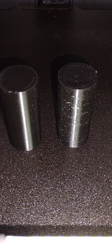

You can see the difference between an old print and a new print. These two cylindrical surfaces were printed at a higher layer height but you can still see the difference in the surface quality.
If anyone has further ideas on what I could do to fix this it would be most appreciated! To me this is the difference between sanding for a few hours and sanding for 20+ hours on large prints to get a smooth surface. It makes this expensive printer a drag to use when I can’t make it print as well as it used to, and it slows all of my project to a crawl.

I would also add that gray highlights imperfections as shadows way more harshly, so treat this run as “hard mode”
Unfortunately it happens with any spool, any color, any brand. I’ve tried fresh spools from the package and it’s the same result. I get a constant diameter when I measure the spool with calipers so I don’t think it’s that. Gray definitely shows the imperfections more than other colors, but I’m certain there’s a difference because I have to sand them down significantly more than I used to to get a smooth finish. I really think there’s a mechanical issue here but I don’t know what else to do besides the regular maintenance and calibrations Bambu recommends.
