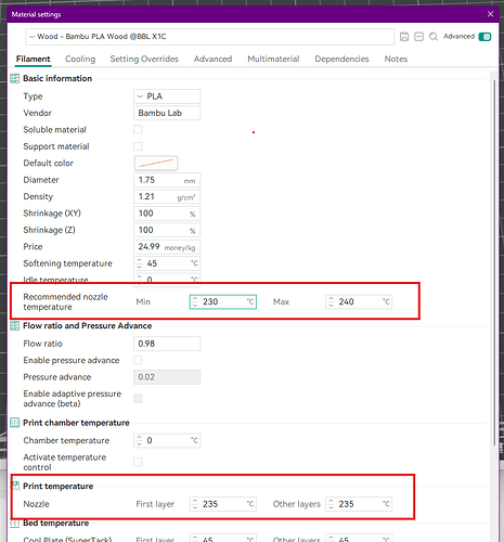

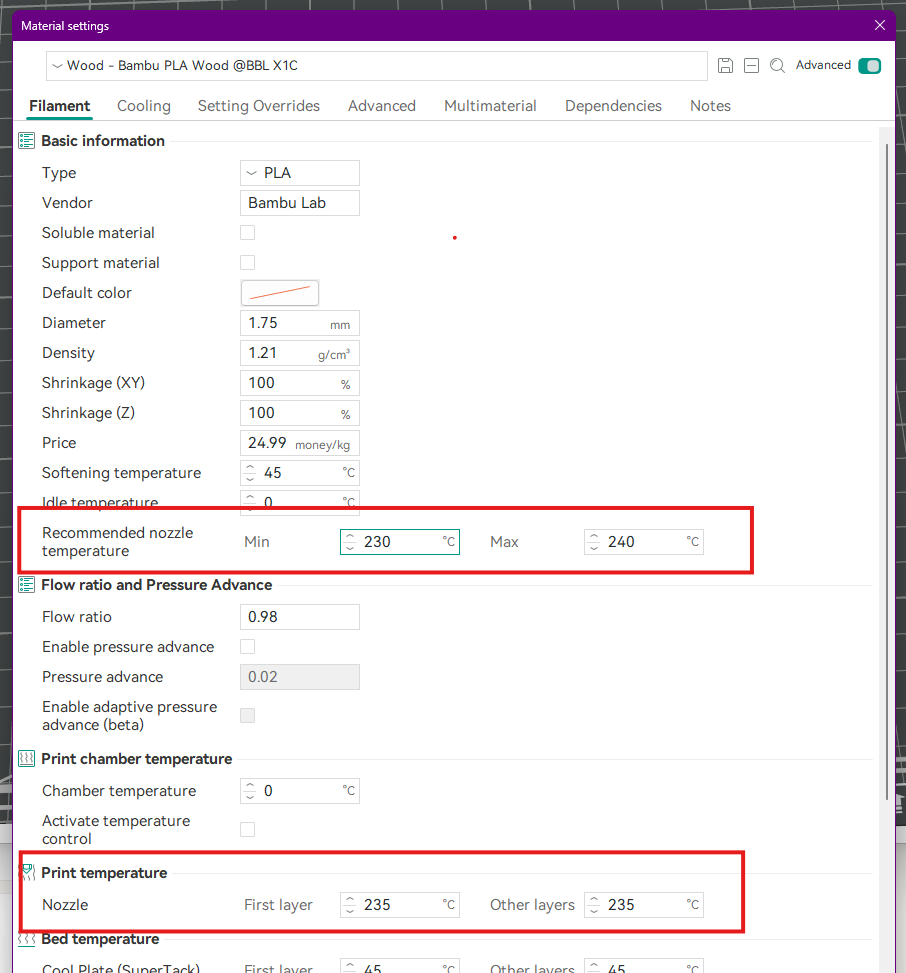

The filament settings had a temp range 190 - 240. I set the “First Layer” and “Other Layers” to 235.
The print started at 240 degrees. The hot end temp setting began to decrease by 5 degree increments as the print progressed. This is a bit worrying as I just finished disassembling my extruder due to a piece of the wood PLA getting stuck. I wanted to use higher temps than what I used before, which was 220.

The Min temp was set to 190 at the time.

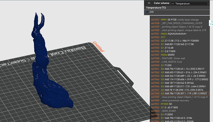

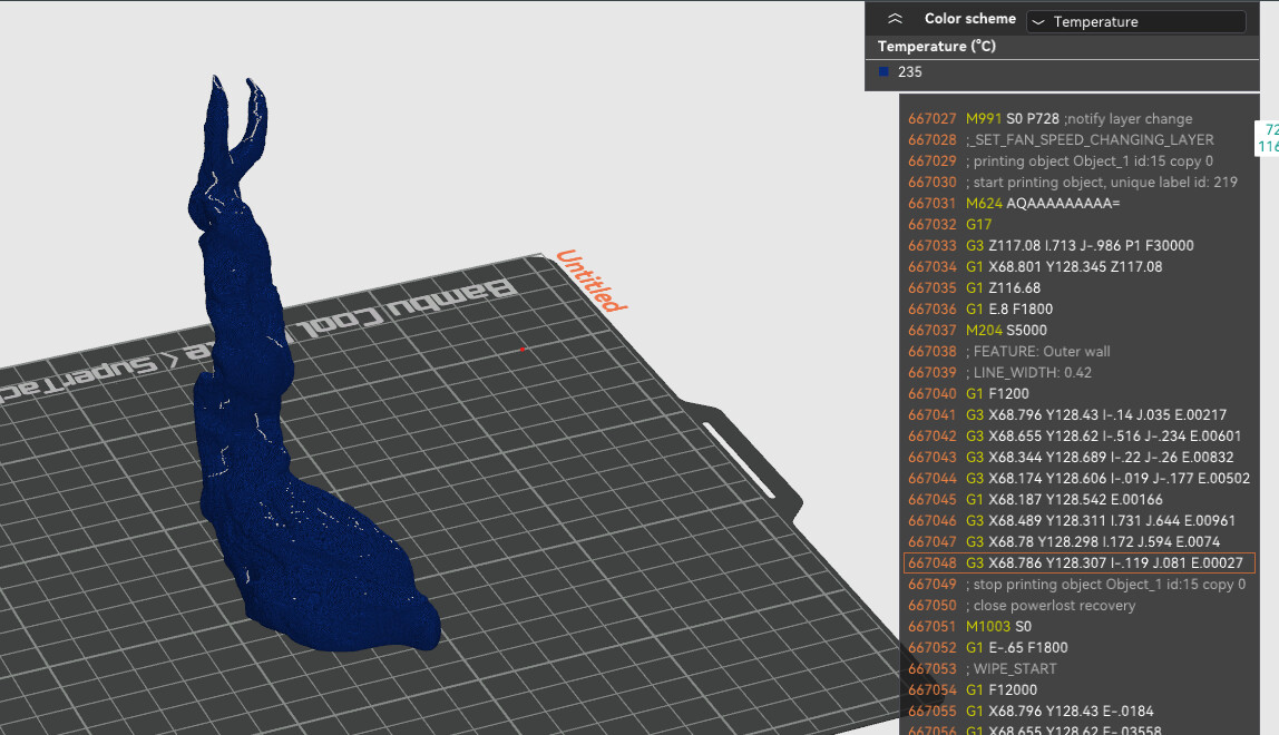

Please upload this preview image from your sliced model.
Is it a solid color like mine?
Yes. It is one color. A lighter colored wood PLA.
