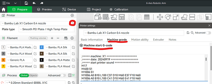

Before printing why does the hot ended drop temp from 220c( after pushing through the poop bit) to 140, then the arm goes to the test line start position and reheats back to 220 before starting the test line and then the print.

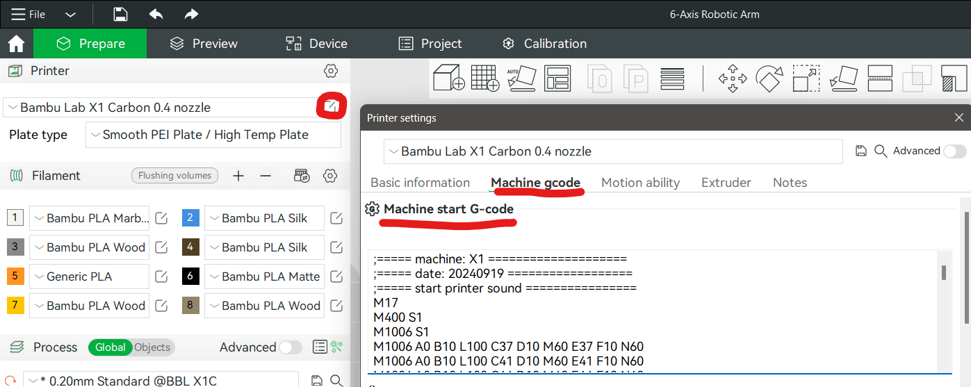

It is all part of the Machine start gcode.
  1. Clean nozzle at first layer temp
  2. Lower nozzle temp to build plate safe temp (140)
  3. Nozzle priming at first layer temp
I jumped “a few” lines though :sweat_smile:
