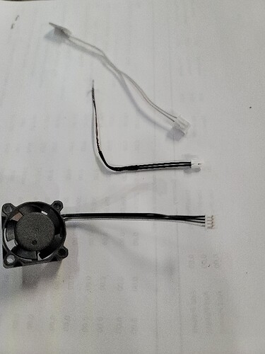

I bought a hotend at Microcenter last week and just now opened the box. I would note that the box was the standard unbleached paperboard box Bambu Labs uses and every small part I have ever purchased directly from the BL Store has come in the exact same box.
When I opened the box, this is what I got. It is a .8mm hotend although the size does not matter.
Seems like I have seen some old pictures in the wiki that used this connector style but I have had my P1S since July 2024 and both my DOA and replacement P1S had a different connector. The type that give people problems.
This hotend also seems brand new in that the white thermal paste was still semi-liquid rather than dry.
My question is, is this an old BL part or a knockoff? I see parts on Amazon by other sellers than BL but shown in BL packaging. I intend to reach out to Microcenter about this for sure but would be interested in what forum folks think.
Those are the wrong connectors, period!!!
Here’s what the P1 hotend connectors are supposed to look like:
are those X1 connectors?
Yes
Well, shame on me. They should better mark that. I have the ceramic heater and thermistor for my P1S so I can replace the two parts IF it will fit into the bottom of the extruder which I have not checked yet.
Yes the physical hotend is the same between the two printer models. FYI There should of been a spare naked hotend shipped in your parts kit with the printer.
