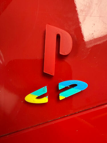

I’ve been struggling a lot trying to get this print right, and after battling with different ironing settings for days I figured I would ask for some advice.
As you can see, there are notable issues with the surface of this print, and this is with 12% ironing on the top surface.

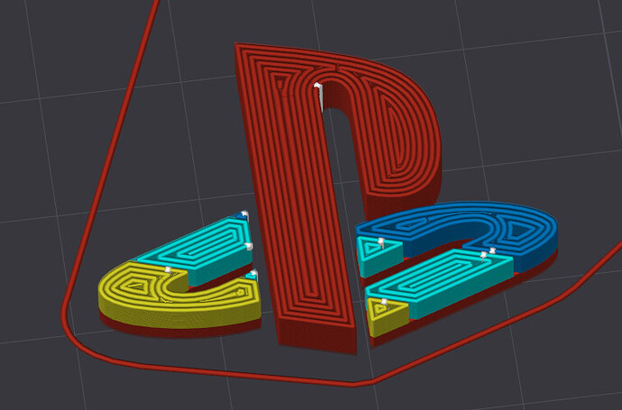

When examining the sliced preview, I can see some ‘holes’ are visible due to Bambu Studio not filling in the whole surface, possibly due to the default line width. These ‘holes’ seem to align mostly with those shown in the actual print above.
I’m tentative to change line width settings as I tried this on a previous and less complex print and I was getting a plethora of issues, especially with adhesion. Even though I’m printing in PLA, this model is much more complex and requires several colour changes.

I think, this also calls for the “Arachne” wall generator instead of the default “Cpassic”. An option in the quality tab. The Arachne wall generator adaptively adjusts the line width to best fit the surface. While classic can only increase walls in steps of the line width, Arachne can even generate lines that grow in width until switching to 2 narrower lines.
I think, it will completely fill those gaps.
Thank you very much for the advice - I trialled the print using the Arachne setting and it turned out much better. It’s still not perfect but the improvement is definitely there, and I’m planning to invest in a 0.2mm nozzle as another user suggested to try and push the results further.
