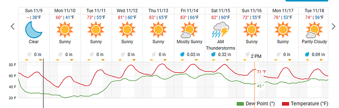

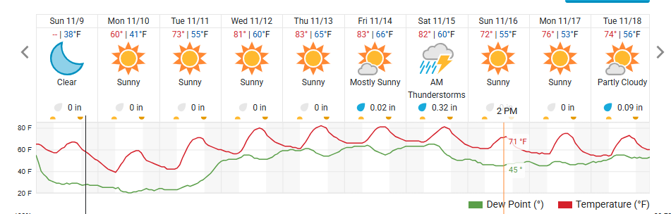

I’d worry about going below the dew point and condensation, do you live in a damp or dry area?
An interesting point I hadn’t really considered. It can certainly be both hot and humid during the summer. Like most places, it gets drier in the winter. No imminent threat:
Also, the garage is generally warmer and drier than the outside air.
I have a number of other 3D printers in my garage for a couple of years now, and I’ve never noticed any condensate on them or in them. No signs of rusting either.
