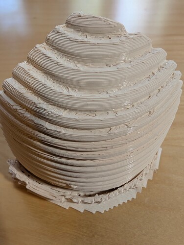

The tops of my prints are looking pretty “gooey”. It’s a very soft (65A) TPU so I know it’s challenging to print. But what specifically causes this effect and what can I tweak to reduce/eliminate it? Thanks!
X1C, 0.4mm nozzle, 0.2mm layer height, Concentric top pattern, 6 top shell layers, 0.33mm top surface line width, 22mm/s top surface speed, Jerk 9mm/s, 4mm retract, 0.4mm z-hop, 30mm/s retract speed.

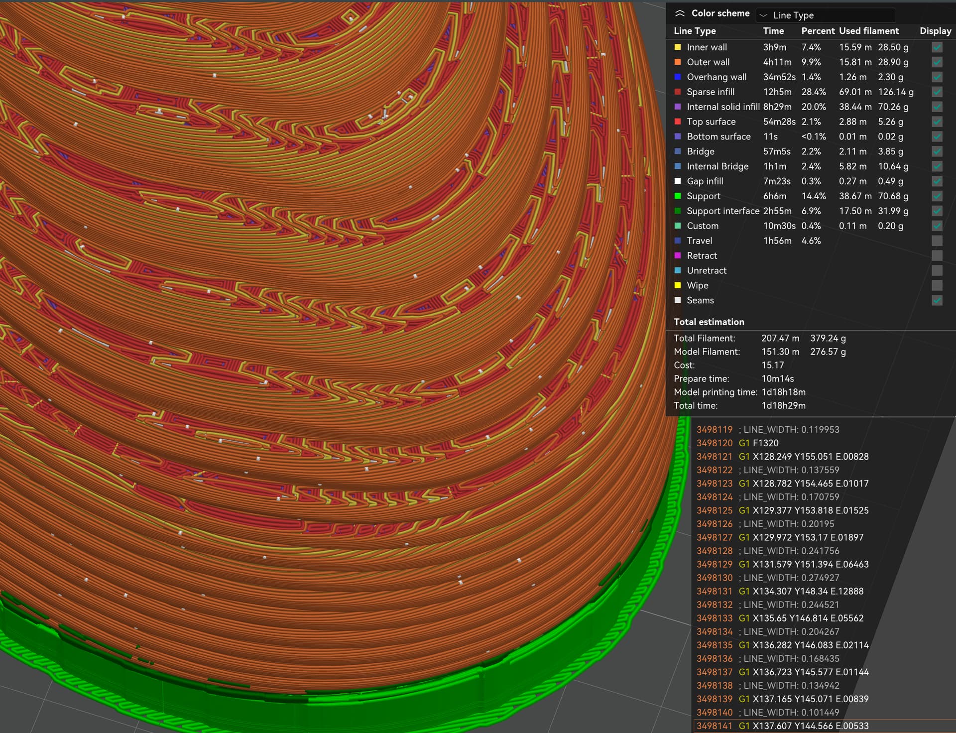

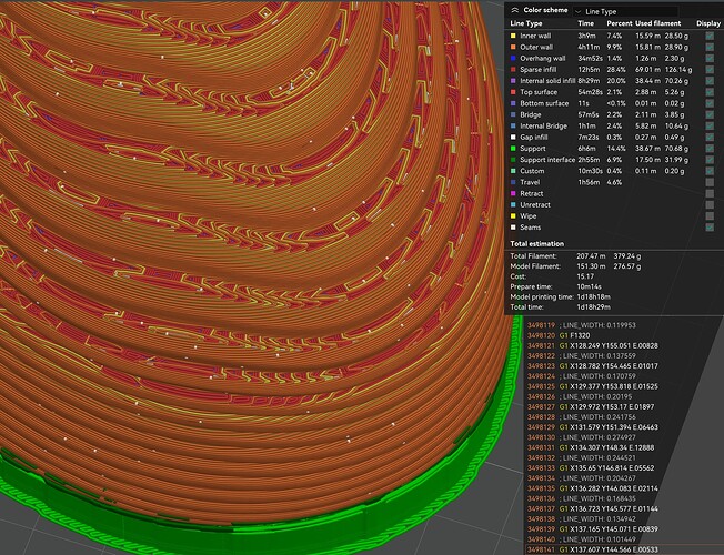

Check slice preview
Are your gooey spots all sharing a similar and different-from-the-rest-of-the-model’s 1) flow rate or 2) wipe/retract/travel locations?
Those parts that connect between a “top surface” and a wall 2 or 3 layers above it are a little concerning. Like the filament is dribbling out DOWN into your infill instead of standing atop it. With 6 tops it should be ok, but here we are haha
Without seeing the slicer / 3mf it might also be too much flow rate. Those walls look really bulgy.
  • Flow ratio: 1
  • Pressure advance: 1 (remember, very soft TPU and even at 1 it’s not really doing the job - corners are good but it squishes a big blob at the beginning and end of a move)
  • Top surface flow-ratio: 0.98
  • Outer wall was 0.36mm vs 0.35 for the others
It looks weird due to the angle of the photo. It’s stringing on the same layer from the outer “ridge” across to the main body.
