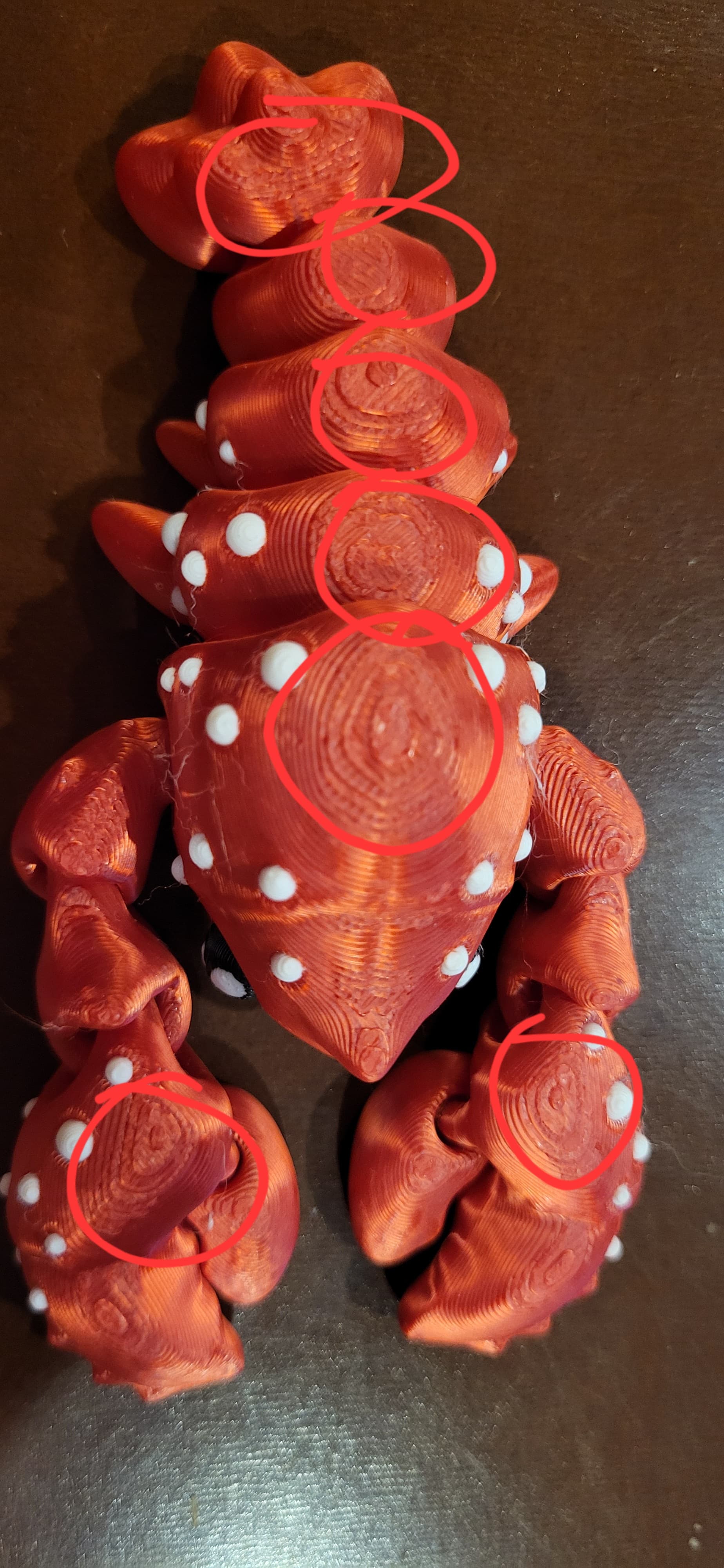

How do I fix this
I am super new at 3D printing… love this print but how do I fix this issue
try a finer layer height, and if you have one, a 0.2 mm nozzle

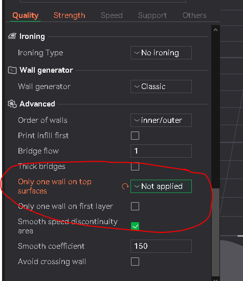

set this to “not applied” then under variable layer height(7th from left on top menu, with the 4 lines) slide the adaptive layer all the way left then click the adaptive button, use concentric top layer… this should help it a lot
Bambu has a good wiki page explaining this problem and how to fix it.
Thank you! This was very helpful!
This was a lot of good info thank you!
