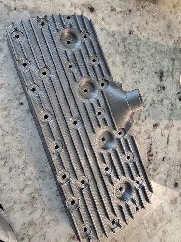

My first issue is when printing the cylinder head, I cant get the support off, and when I do the model surface is terrible. Ive tried increasing Z (started at .166 then .175 then .2), pla interface, type of support (tried them all), changing the print orientation, they all seem to not help at all. Looking for suggestions on that.
surface after struggling to remove any of the support
the top of the finished file
Before removing the supports

Print the support interface layers in PLA and use a 0.16 or 015mm z-top distance.
Set the pattern spacing to 0 to get a solid to surface on the support.
Still won’t look perfect but should come out in acceptable quality.
