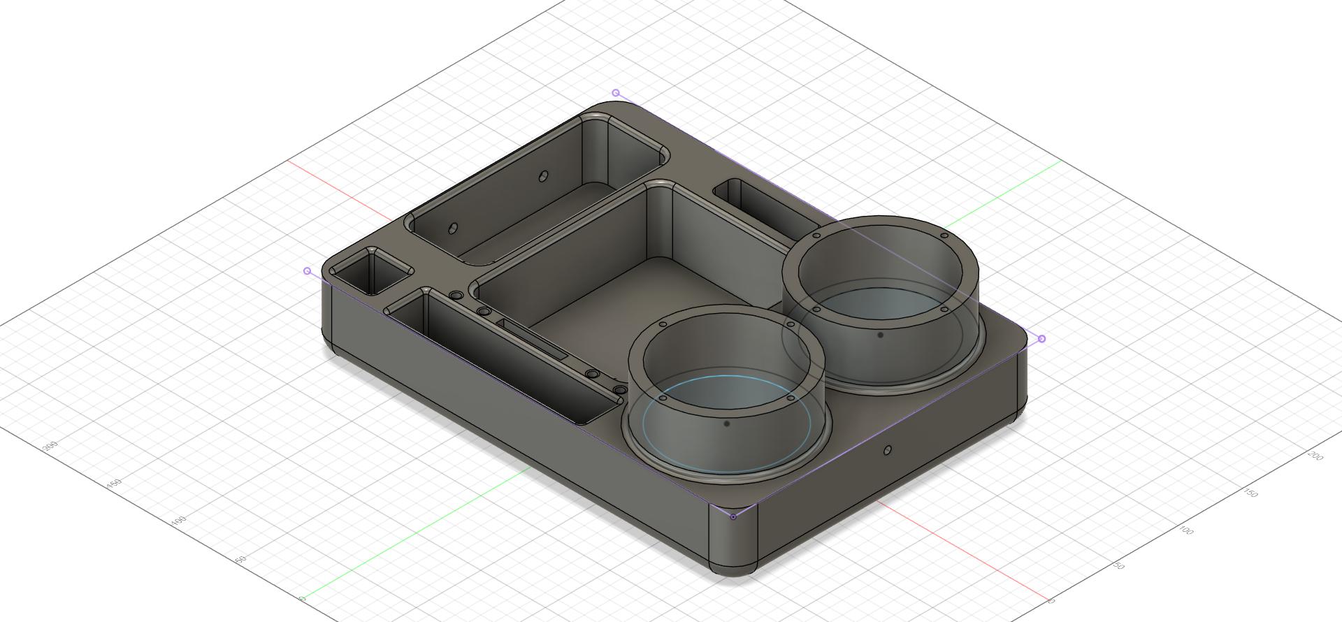

Here is an image of the Tray that the arm plugs into. I split the arm in half as suggested and glued it back together with Weld on 16. The glue is drying so we will see how it turns out. I have Considered re-designing it. The solutions I see to get the right orientation involve multiple components and with the angles involved I struggle with the drawing. I am sure with enough time I could figure it out. What’s nice about the design is that I can redo the arm as needed to get the right solution. Honestly I am learning so much and not is a hurry so its all good.
Looks like you are making great progress. Back on the split design, I’ve had mixed results with gluing my 3d parts. Small machine screws are my go-to solution these days when I can’t design in a clip, hinge or grooved solution. I keep a selection of 2, 2.5, 3, 4 and 6mm machine screws around. Most of the time, just designing with a slight undersize and letting the screw cut it’s own threads works. But something cheap like these is helpful as well Drill Tap Set, Valkynos 6 Packs Titanium Plated Combination Taps Drill Bit Set, M3 M4 M5 M6 M8 M10 Hex Shank HSS Screw Thread Metric Compound Tap Drill Bits Metal Drilling - Amazon.com There are better ones but its only plastic. Note: I turn them by hand. In your design, I’d be thinking 2-3 screws; recessing the heads with an oversized hole with an undersized pilot hole on the receiving side that stops a bit shy of the skin. Just a thought.
