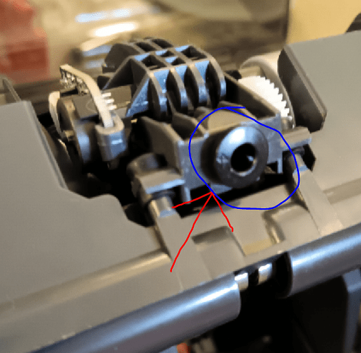

How do I replace a broken AMS rear tube release button?
The last time I had to clear a blocked filament, I accidentally broke the clips on the tube release button. Today I got around to printing a replacement but I can’t work out how to install it - I can’t manage to release the ptfe tube to get access, without a release button already in place - it’s a bit of a Catch 22! What’s the trick for doing it without the button?

Once you have the thing open it’s more obvious how it should have been opened :slight_smile: I was pushing with my fingers on either side (i.e. the same place that you would push on the release button) but in fact I should have been pushing on the circular ring in the center. Naive newbie mistake, won’t happen again. By the way the 3d printed replacement release button is a nigh-perfect copy.
