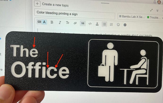

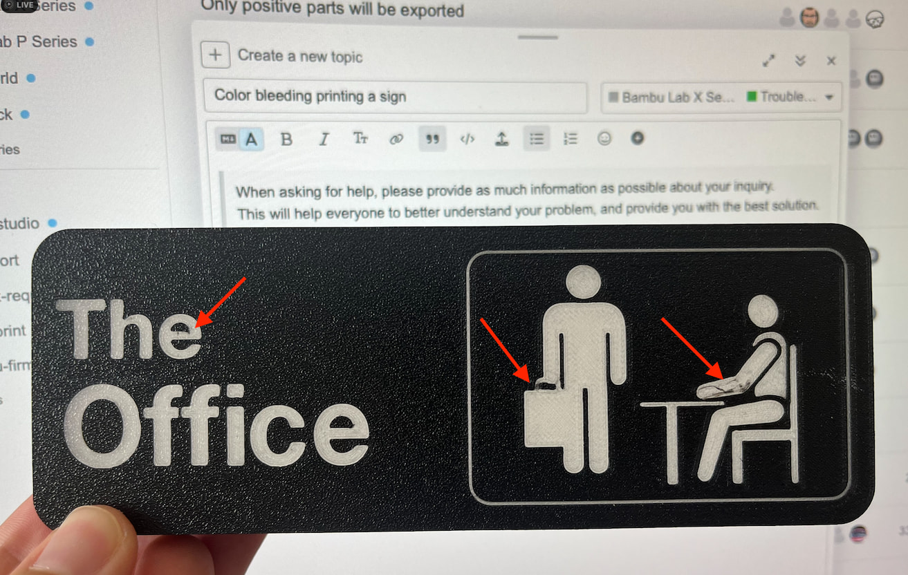

I have a sign that I print in black and white, but I’m almost always getting some black in random spots of the white part:
I’ve tried purging more filament, changing the prime tower settings, etc., but it always ends up happening.
Is there anything I’m missing? Any other way to make sure this doesn’t happen, or at least to reduce the chances as much as possible?
The white filament is a translucent glow in the dark filament, so any black bleeding into it kinda ruins the sign :frowning:

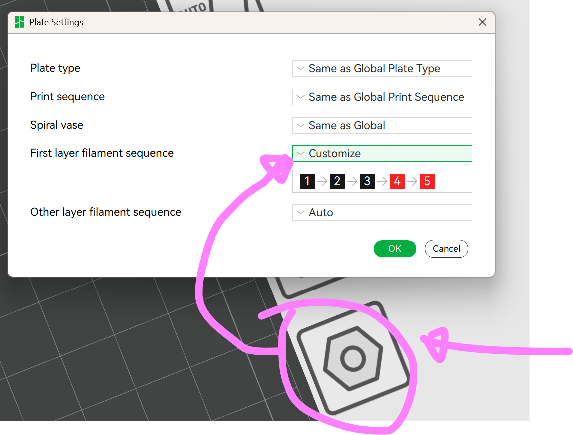

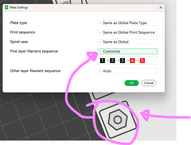

  • Set your filament print order so that that white filament prints first.

The white has been printing first always. The problem is that because it is translucent, if the second layer bleeds some black it shows :frowning:

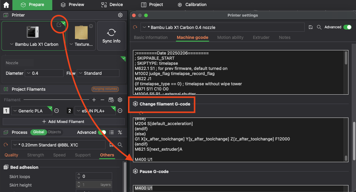

Do you know if it’s possible to add a pause after a color change? so after changing to the other color’s filament and purging, pause there so I can clean the nozzle and then continue.
To my knowledge you can only insert a pause via Bambu Studio at the start of a layer. Another option is to manually edit the gcode file.

So I was able to add the pause command right after changing color and purging.
If you open the printer settings there is a section called “Machine gcode”. And there you can modify or add extra things.
I just added the M400 U1 pause command at the end of the Change Filament g-code section:
I did a test print, cleaning the nozzle every color change and looks like I got better results. I’ll keep testing this.

How do you change the color print order? I didn’t know that was a thing.
