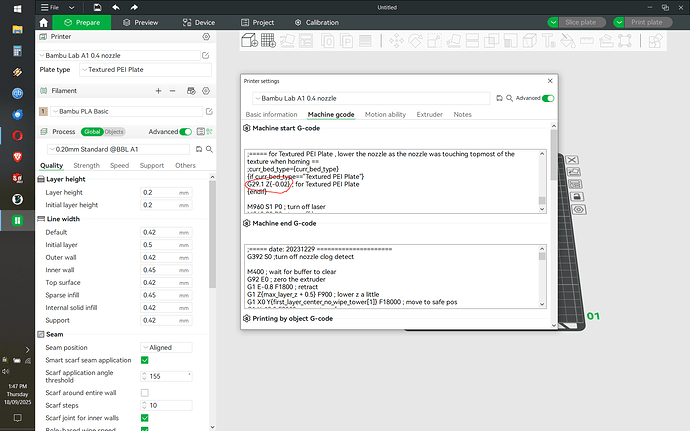

If you’re familiar with gcode, you can hook in to the Machine Start sequence and assign it. You’ll find a commented portion in your machine’s gcode that adjusts the Z based on your build plate selection, you can base your code off that.

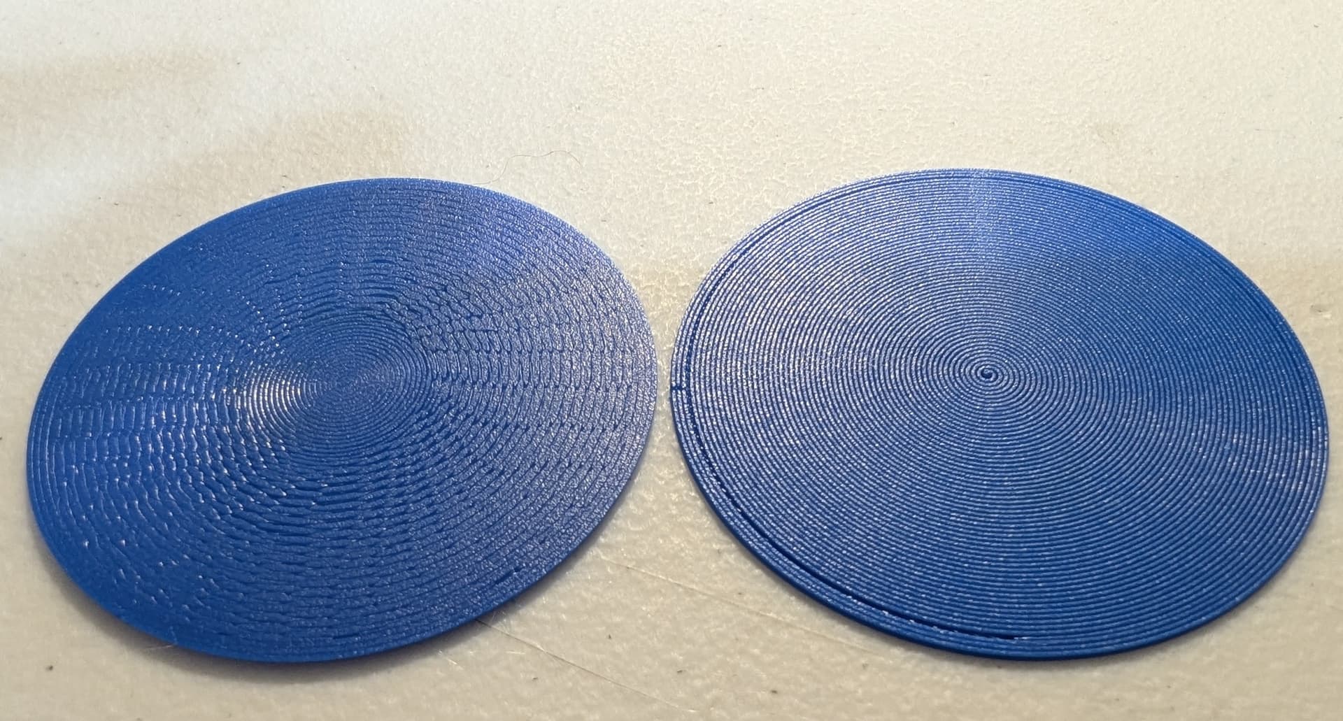

No, it’s definitely associated with the Z offset. I have manually added the “G92 Z-.06” command to the sliced g-code (it works but is a pain to do) and it comes out much better (less under extrusion, no gaps in the surface). Just a note this is using Archmedean Chords as the top & bottom surface patterns in the process profile’s STRENGTH tab. Here’s an image showing the result.
Right is manually added Z offset and it looks much better (but still an issue along the outer edge which I’m trying to address now). Left is with the Z offset added to the filament Start G-Code, this looks like what it did when no Z offset was applied. Not sure why Studio makes it so hard to add a Z offset. Manually adding works but is a pain. Just a note these are printed on a BIQU Glacier build plate which has a flatter look (but a bit more textured than smooth which I need to get a close top/bottom match) then the Bambu Textured PEI.
I just want to bake in the needed Z offset into the Filament profile so it gets properly applied and printed with each slice. I thought doing it through the Start G-Code in the filament profile’s ADVANCED tab would work, unfortunately it appears it didn’t.

You have to edit the Machine Gcode tab in the edit link for the “Bambu Lab A1 0.4 nozzle” at the top-left of the page. The gcode you have to edit is near the end of the big gcode list.
‘-’ lowers the nozzle and ‘+’ raises it.

i suppose that you have realized that the gcode line should start with G29 instead of G92.
