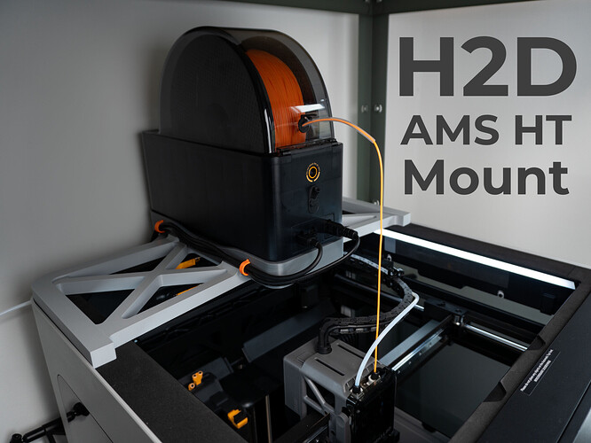

Might want to look into the top mount if you’re planning on doing it a lot or need some accuracy in the print, but otherwise it’ll feed through the TPU opening fine.
see results under “Testing”
edit: ah, after posting I looked at the wiki and it has an open spool top-mount listed too :slight_smile:

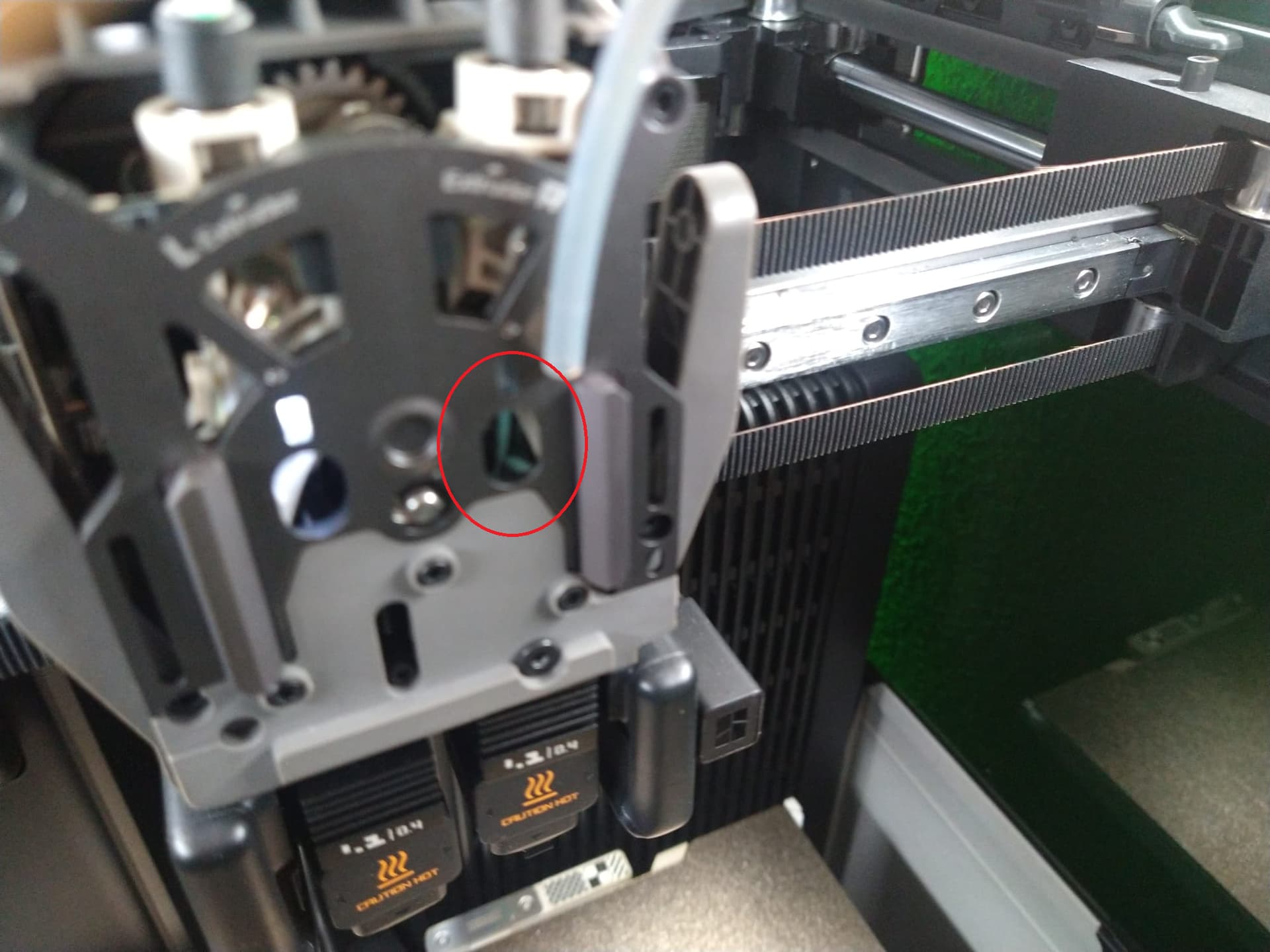

Somebody said they dropped the 85A into the H2D by telling the printer it was 90A. I even reduced speeds by a quarter but it got tangled instantly as well:
I tried disassembling the extruder but I could not get the light grey part out like they instructed in the wiki so no way to get the filament out. I already tried just pulling it firmly, but only when I pulled from the top with all my might I got it to untie and release.

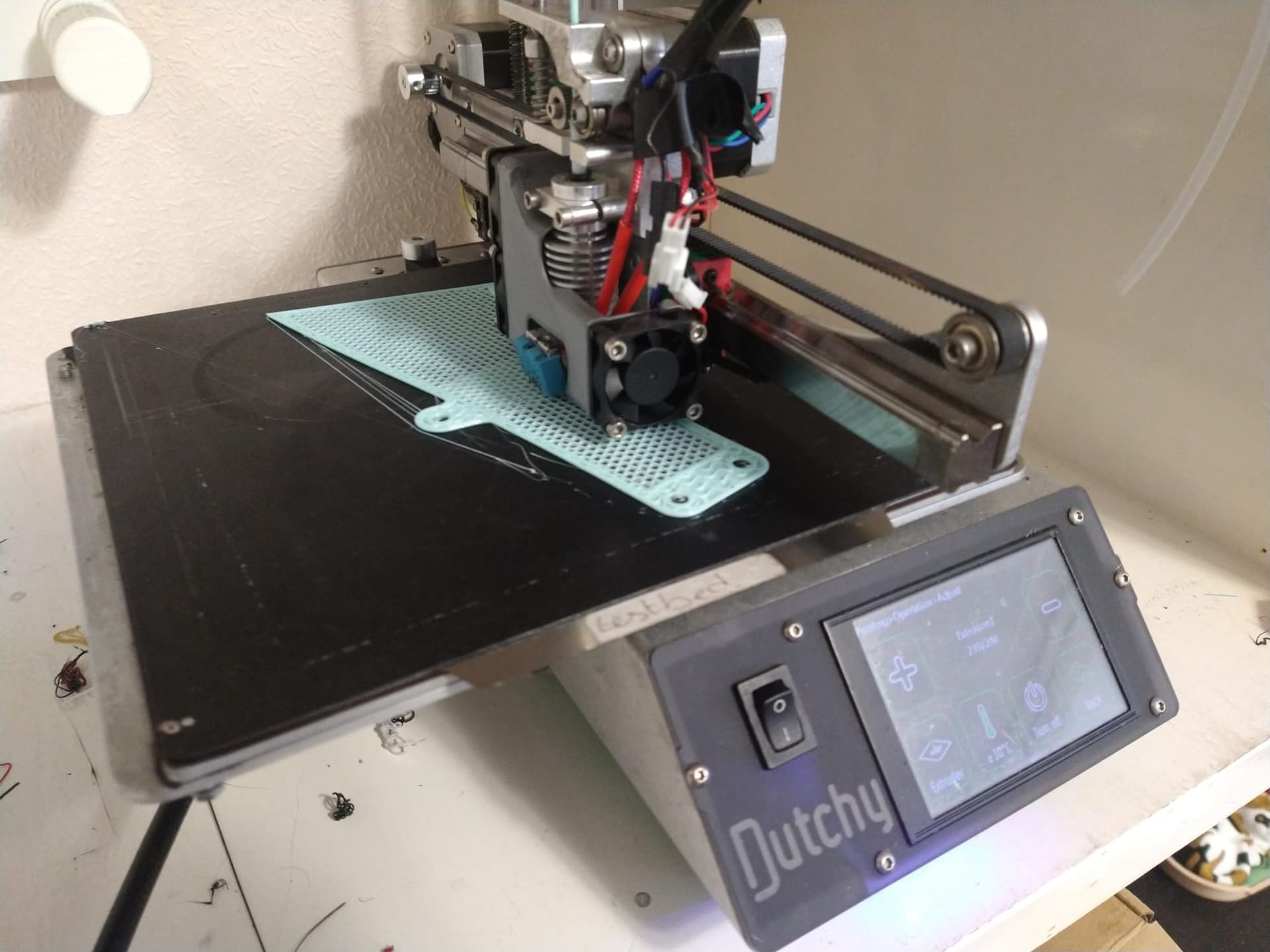

I popped the same spool into my 8 year old Dutchy and it is now pushing the bambu 85A like a champ at 25% faster than the H2D 90A setting:
I really like my H2D but I think the extruder is just too complicated for the TPU. You might get it to work, but there just shouldn’t be enough space for filament to buckle. If there is a way out of the filament path, TPU will find it.
I am hesitant to try the 85A on my A1 but I wouldn’t be surprised if it performed better than the H2D, just because it is simpler.
This is of course just my one-off experience and I am hesitant to try it again. I think I’ll stick to the 90A for the H2D for now…
