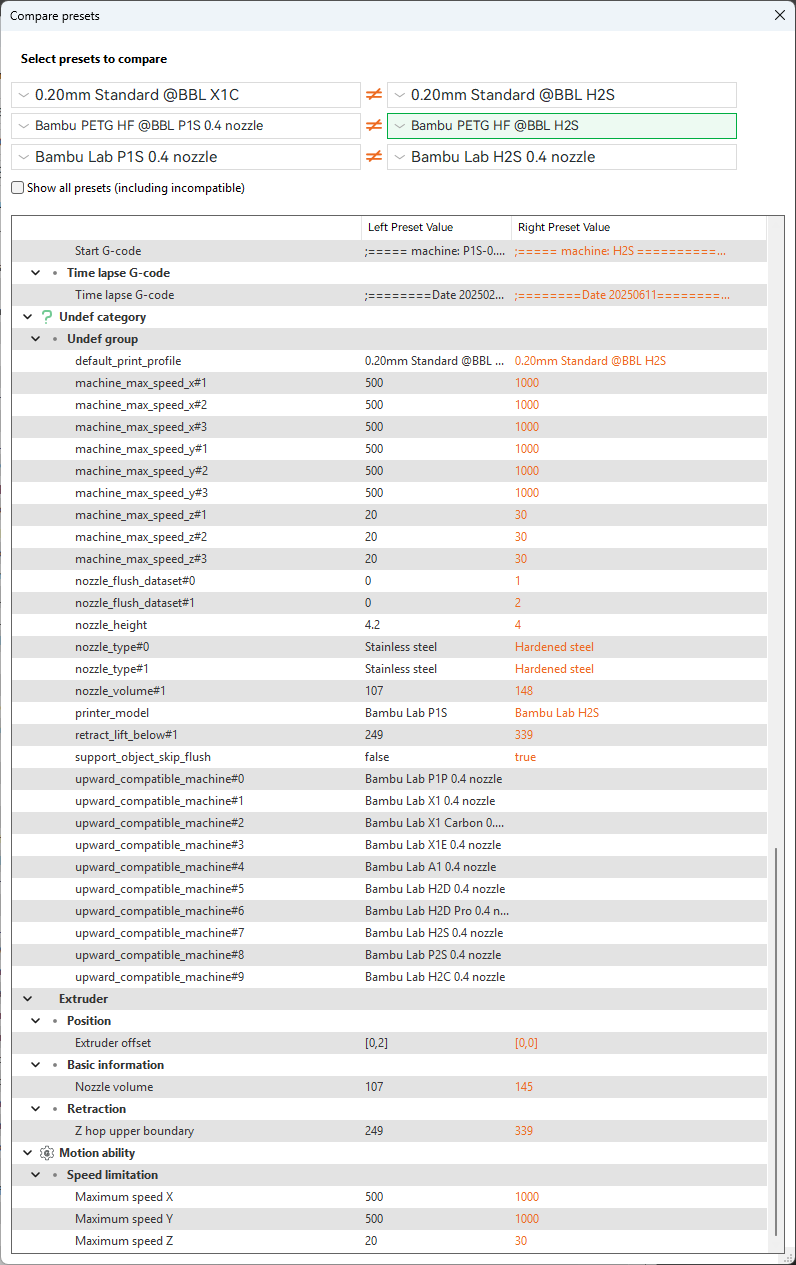

How is it that travel speeds affect the H2S so much more than the P1S?

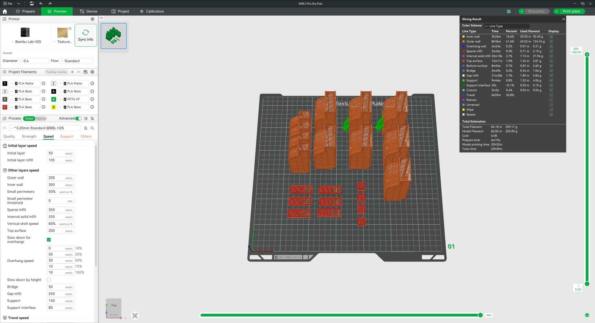

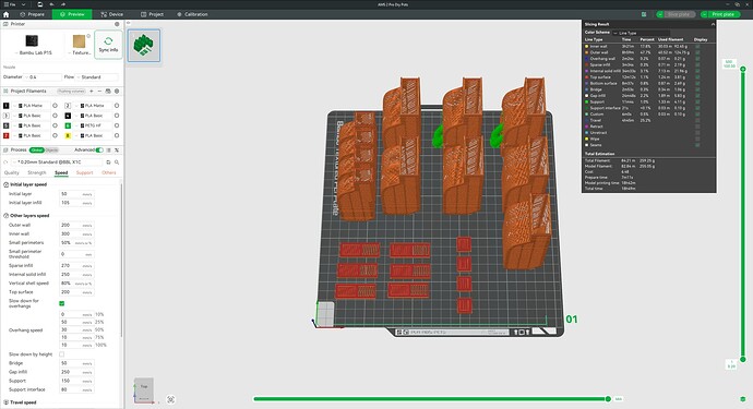

Using the latest Bambu Studio, and the same exact project with Bambu PETG-HF. The H2S shows nearly 2 hours longer, with all of it being travel time. I know the H2D suffers from travel speed thanks to the massive extruder, but I hadn’t seen anything on the H2S with this. Every speed setting on the H2S is either matching or exceeding the P1S.
The only way I can cut down the print time on the H2S is by changing the travel acceleration from 10k to 20k, and it still winds up being 30 minutes slower. Even if I move every object right next to each other, leaving basically no gaps, the print time is not affected. Am I missing something obvious here?
I also use those containers (or at least very similar ones). With those ribs at 45%, most of the print is governed by “Slow down on overhangs”. So it is not surprising that print time predictions are quite similar.

However, you can use the slicer previous (Speed, Flow, Layer time; selectable next to “Color Scheme” in the legend) to determine the governing settings in each slice.

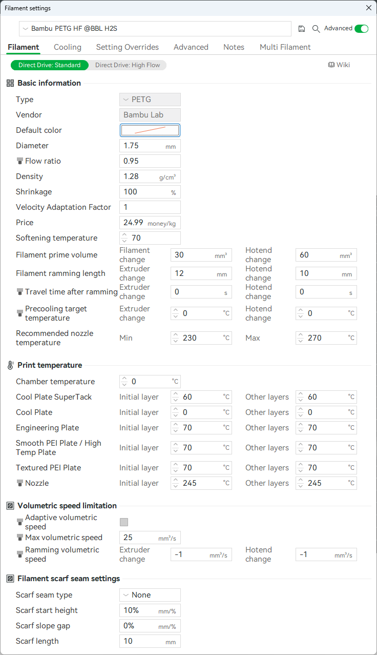

I assumed you meant the Z-Hop type, because it jogged my memory of an old video I saw where one of the default Z-Hop types was this little spiral, which I want to say was not a default on the P1S - at least in Orca, which is my main slicer. Fast forward to the H2S, and it is indeed set to Spiral in the PETG-HF filament settings by default. Changing that to Slope resolves the issue entirely, knocking over 2 hours off the print time. Amazing.
