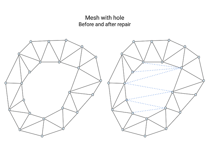

Fixes can’t design a fix, they simply attempt to connect triangles that aren’t corrected ‘meshed’.

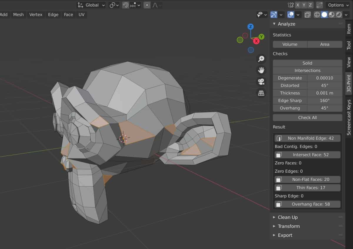

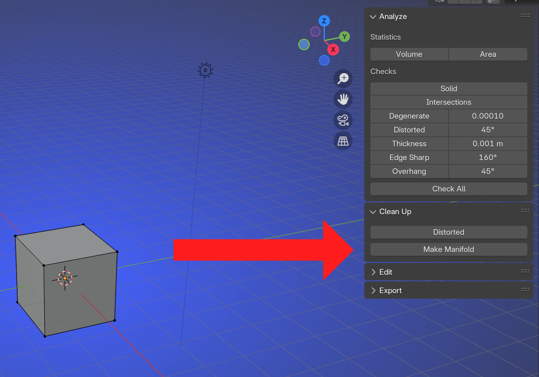

To repair a model in Blender, I highly recommend this tool, which is specifically designed for that purpose. This particular add-on specializes to fix “non-manifold edges.” I’ve been using this tool for many years now, and it’s always worked so far - even in the worst-case scenarios:
3D Print Toolbox
Guide: How To Use The 3D Print Toolbox Add On?
I would strongly advise against using online solutions like nano3dtech, because you’re essentially leaving the repair to an unknown black box.
You can also forget about the repair function in BambuStudio or Orca when dealing with complex objects, but that’s just a side note. These are slicer tools and aren’t optimized for repairing objects; they also lack essential settings.
