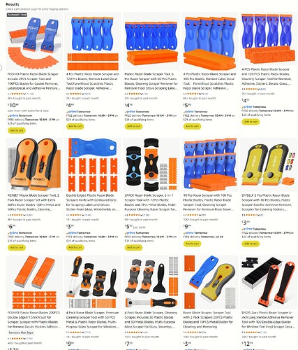

For scaping, use plastic blades. Here is a link to one that is well suited for scaping build plates.
https://www.amazon.com/s?k=Plastic+Razor+Blade+Scraper
There are literally hundreds of makers of the same blades, just pick the color you like.
The point is: don’t go nuclear. No metal scrapers, no solvents unless you know they’re safe for your surface, and definitely no aggressive scrubbing unless you want to ruin the coating.
