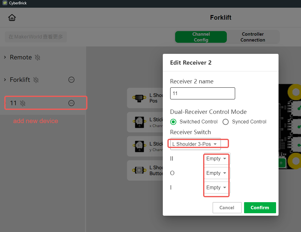

You need to use the PC version of the software. After creating a new project, add another device on the left side, then select the corresponding control method and upload the configuration, and it can start working
Thank you. I will try again. That is the method I used and it appeared to work. But only one model would respond, even though both were ‘recognized’.
You need to have both models and your remote turned on at the same time and you need to configure all 3 systems also at the same time, for the model switching via the stock MicroPython code to work.
Thank you. I’ll try again. The last attempt saw both models sitting upside down on my desk so I could operate them without them running away, and the remote, all turned on. The remote and both models appeared in the configuration screen. Both models would ‘recognize’. Both models had the ‘switched mode’ enabled and each had a different rocker switch position. But, only one would work. Fiddle with it and the other would work but only one.

I got everything to work. I actually had a hardware problem, one of the 3 pin wires included with the rocker switches (from the ultimate kit) is at fault. I swapped it out with the one from the 2nd rocker switch and everything worked. The only other issue i noticed tho is that i cant use the 2nd model rght at startup unless i turn on the first model.
