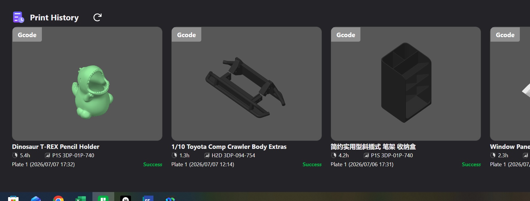

How do i delete files from the print history section on Bambu Studio?
Attached screen shot of the section I’m wanting to alter. This is on the Home tab on the desktop Windows version.
Deleting filed from the device page doesn’t change the ones on the print history so I’m assuming its a Bambu Studio issue.
Many thanks.
Hi Mike,
This is your print history from MakerWorld (vs. the “Recently Opened” list which are projects loaded with with File → Open, or anything stored on the actual printer). I don’t know if there’s a way to delete MW history on the site itself… I don’t have any history to try with. :slight_smile:
FWIW, the whole list can be disabled in Studio Preferences with the Online Models → Show history on the home page setting.
Cheers,
-Max
Hi,
I wanted to do the same thing. I found in the phone app, tap on ‘Me’, then ‘Printing History’ at the top left. You can then ‘Edit’ and 'Delete.
Refreshing the BambuLab PC/Mac app then removes the deleted print.
