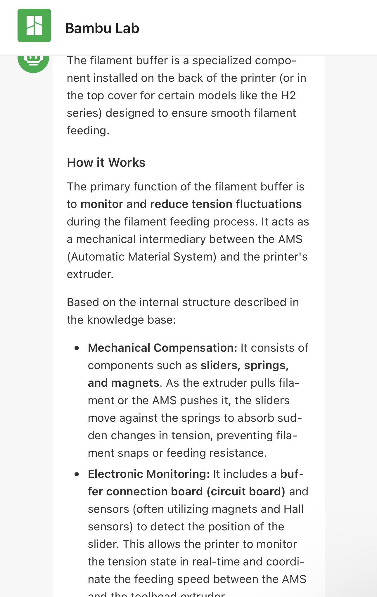

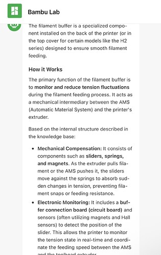

Is there any actual documentation about this? As far as I can tell, the buffer is purely for communication with the AMS to tell it when to feed some more filament. The H2 series machines use it for filament tangle detection but the X2D doesn’t seem to. Older article but it seems to relate to the point of the article. Bambu AI support also seems to point to it not being useful for much besides the AMS.
Feeding through a buffer with no AMS is likely to increase filament path resistance so you’d actually be better off NOT feeding an external spool through the buffer…
