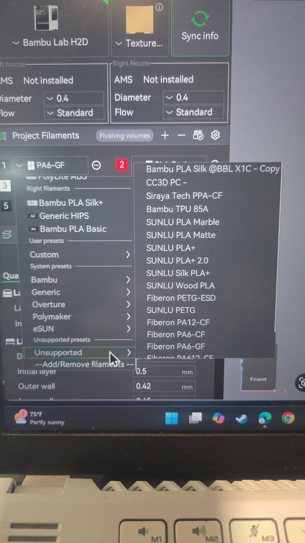

I’ve had an X1C for a while and had no trouble importing manufacturers profiles for filaments which are ones that aren’t directly support by Bambu Lab. I’ve done that by Import Configs and point to the JSON file for the filament.
Now with a H2D they all show up as “Unsupported”. I’ve tried choosing them again with the H2D chosen as my current printer but they still show up as “Unsupported”. I know it’s possible to craft a Custom Filament based off of an existing generic or other supported filament but I’d rather have it show up as the filament manufacturer intended.
How can I make this work?

Seems like maybe these profiles were made for the X1C and don’t specify the H2D in the JSON file. If this is the problem, how do you edit the file to add to H2D and so you can see how it works?
I use notepad ++ to edit (copies) of the json files. I run the slicer in a seperate test vm and make copies of all the directory so when I mess things up (and I do) usually I can just copy things back, and maybe reboot the pc. I don’t have an H2D but the slicer won’t know that for the prep part if I tell it I do.

Haven’t tried loading a 3rd party filament via json so don’t know if anything is fixed. I ended up doing what others recommended and copied all the filament details from the X1C (did screen shots) and manually made a new user created custom for the H2D. At least it gives you a starting point maybe a little different from the generic profiles.
One thing to keep in mind is that a lot (maybe all at this point) of the 3rd party profiles are for single nozzle printers.The files for the H2D have additional entries because of the dual nozzles and it appears that if they aren’t there the printer won’t use them. If there is a generic or Bambu for that filament material, try that. If that doesn’t work or isn’t close enough then you will need to make a custom profile. I am no expert so there are probably other ways to get there.

I have exactly the same problem with the H2S which arrived today.
I can select any of the included profiles happily but though my custom profiles, dozens of them as a resyult of extensive tuning with Orca and X1C/P1S, show in the slicer they show as “Unspported” and cannot be selected.
If I take an existing stock profile and copy all the settings from one of my custom profiles I can save it as a new profile and it becomes selectable.

Your pre-existing ones were created for a single nozzle device, and the H2S is a dual nozzle. That is the root of the issue from what I can tell. There are parameters in the dual nozzle files that do not exist in the single. When you create a new one those parameters are included.

I don’t know if it existed in earlier versions of the slicer, but the filament profile now has a tab called “Dependencies”. I do not believe it existed before.
**** Orca Only, not BS. But profiles set in Orca as described below will be available in BS. As usual, Orca is ahead of the BS slicer ****
When I created a filament profile it would become available on my P1S and X1C machines.
If I set the printer as one of those machines, all my profiles are available under the Custom dropdown.
Choose the one I want on the H2S and edit it, go to Dependencies and choose “Set” under “Compatible Printers”.
A list of all your printers comes up and you will see any previous printers you had are ticked (this is why I think it didn’t exist before - it applied to all printers).
You can now tick all the printers you want it to apply to in my case the four H2S nozzle sizes.
Ok and save the profile.

TLDR - I can simply run through the list in the filament profile editor and select H2S in the dependencies for each profile, or if I’m not bothered making CF filaments unavailable to 0.2mm nozzles, just tick the “All” box and save
Glad you seem to have figured it out. I was testing in bambu studio and managed to get my 3rd party Americam Filaments preset for P1S to show under custom for H2S after doing some tweaks but I don’t have that printer and have no idea how they would actually print.
I did compare some files and the Bambu PLA base json for X1C is about 25 lines and for the H2S its about 130. And creating and comparing customs the H2s json is still about 20 lines longer and includes a few settings for things related to “counter_coef…” and maybe a few others.
